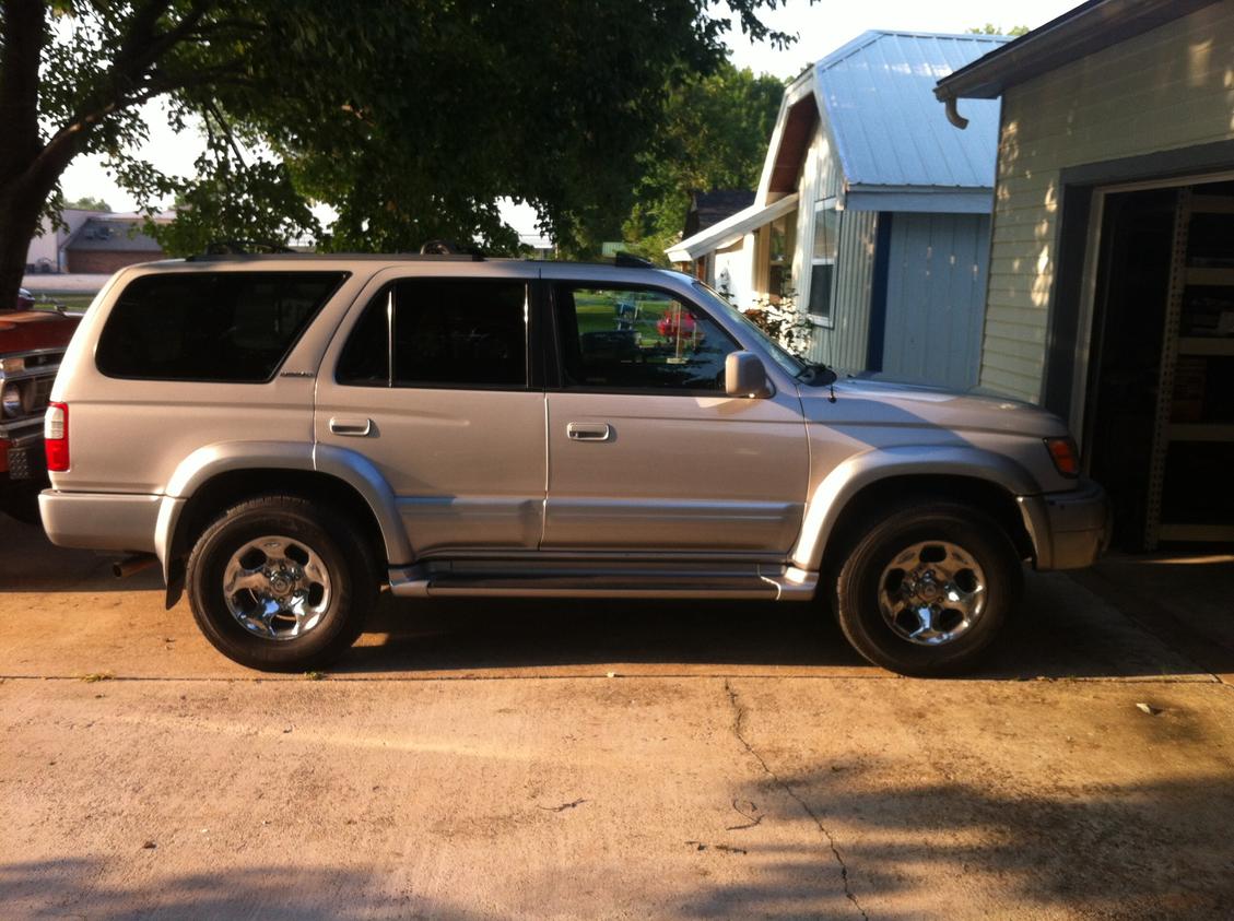

Just picked up a 2000 with 101000 on it,it was a dealer trade in,it is real clean,doesn't look to ever been abused,I ran a car fax and only a few oil changes were on it.I want to to get timing belt and waterpump changed,do a tranny flush,fuel filter,o2,oil,plugs,diff breather mod,coolent flush,diff fluids and grease,anything else you can think of besides lift and tire and armor:)
My main concern is do I switch to syn oil and do I just do the flush on the tranny or should I change the screen?
Thanks

Mini me! Looks great man!

Truck looks good! Great find
