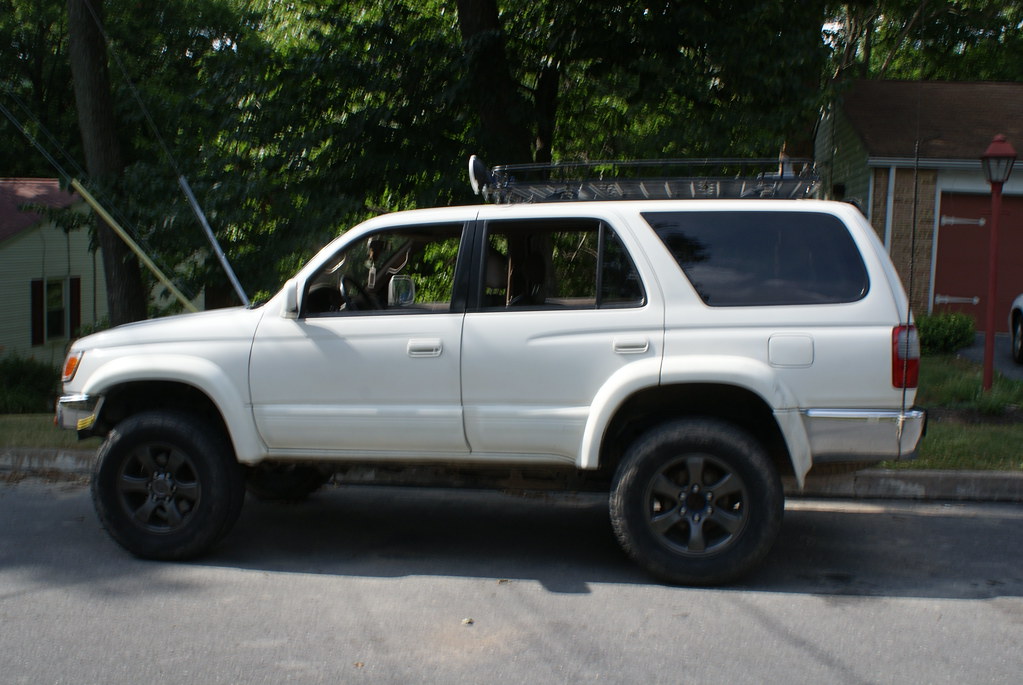

not on the tail light but close to where it would be. i love mine and it has never touched the truck and range is awesome. i mounted it on a spring which really helps with swaying somehow, plus gives it the correct electrical length. when i need to, i grab a piece of 100lb fishing line with an "S" hook on it and hook it to the roof rack floor.

i had a whip. i just zip tied it down.

what kind of spring do you have on yours because i am still looking for one.

got it at radio shack, only one they had, easy install and works great

Thanks for the shots guys. I still can't decide! 4' Wilson Flex Silver Load vs DX Engineering 102" whip.

Nothing out performs the whip. With the spring its the correct electrical length (1/4 wave length). I just wanting to know I had the best functioning antenna setup as a good antenna is a bigger plus than good radio.
