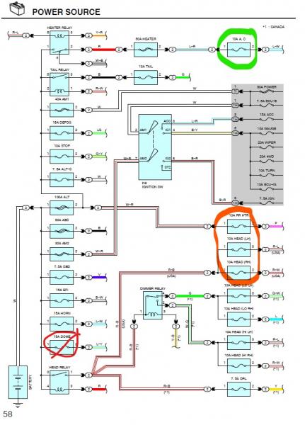

15a fuse blowing... also won’t start.
Is your fuse panel like the one in the schematic you post?
If so your not pulling 1a. The drawing showing the connectors on the back is rolled over to the right. In the upper left corner of the back would be the power relay.
You need to detail exactly what you did to the vehicle after you pulled it into the garage. Step by step in detail.
Your posts are so all over the place it took folks 2 pages to realize you drove the rig after you suspect your brother damaged it. And it seems you have 2 threads going for the same issue.

Got the correct manual now from a fellow member. It wasn't 1A. It's 1J.
1. Truck wouldn't start. Jumped it off.
2. Loaned to brother. Returned with dome fuse blown, door locks not working, and turn signals not working. Tried to swap 15a dome fuse out, but it blew. I had to go somewhere for a photography job so I drove it anyway. Drove fine.
3. Came home to try to figure this out. Drove it in the garage. I swapped fuses - the 10a AC, 10a RR HTR, 10a Head (RH), 10a Head (LH), all under the hood and the ACC (inside truck) after using a test light. Now only the 10a AC fuse lights up using a test light out of that cluster of 10a fuses in that middle section of fuses under the hood. They aren't blown, the test light just doesn't illuminate on either side. Tried swapping dome fuses but they kept blowing again.
4. I began pulling the connectors behind the fuse box inside the truck. Narrowed it down to one connector which I now know is the 1J. I used my test light poking inside each slot for the wires on that connector. On one of them on the left side I heard the relay click under the hood as the test light lit up. There was one on the right side that made the test light illuminate, but it was very dim. Not sure what that means.
5. Truck would crank but not start.
6. I swapped the 100 ALT fusible link because it appeared to be blown, but I couldn't really tell for sure due to lack of visibility through the plastic. Also because other T4R.org members had theirs blown while diagnosing similar issues. Just figured what the hell. I'll swap it.
7. Here we are.
Brother got the rig running fine... So did I. It only stopped running after pulling into the garage to diagnose.

3. Headlight fuses won't have power unless the headlight switch is on. 50A Heater and 10A AC fuses won't have power unless the 10A gauge fuse is outputting power (key ON). 10A RR HTR fuse should have power all the time (though the rear heater itself will only work with vehicle "ON" via GAUGE fuse power and rear heater relay).
1J connector has:
1 - R-L, 10A GAUGE fuse power output (to alternator and other stuff)
2 - R, Headlight relay trigger signal (pulls to ground when switch is ON)
3 - L-W, Power in from HORN relay
4 - B, Power to horns from HORN relay
5 - empty
6 - G, Power from TAIL relay for integration relay and interior light power
7 - R-G, LH headlight low beam ground connection to headlight switch
8 - B-W, 7.5A IGN fuse power output
9 - R-G, RH headlight low beam ground connection to headlight switch
10- G-Y, Front RH turn signal power out
11- G-B, Front LH turn signal power out
12- L-Y, Power input from 15A DOME fuse to integration relay and other systems
13- empty
I'd try removing the integration relay and plugging 1J back in to see what happens. The next thing is to go down the line with every component that is connected to the DOME fuse...

Unfortunately I didn't try starting it between steps 3 and 4 because I had no reason to believe it wouldn't start. That wasn't the problem at that point.
From what I gather, those fuses only have power when it's on.
Yep tried reconnecting and that didn't help.
1J connector has:
5 - empty
13- empty

Okay so I've been studying the diagrams a bit. I've plugged back in the 1J connection.
I unplugged the 1F connection which controls the stereo, antenna, door switches. The new Dome fuse didn't blow. Now my personal lights work and my dome light will work in the Door position, but not the ON position.
Maybe investigate the wires in the rubber flex boot for the drivers door. Maybe shorted in there.
You had said the radio was unplugged. Are you sure nothings shorted in the radio wires or maybe the power antenna.
I've pulled the connection from the antenna. No change. Dome fuse blows.
Stereo is still pulled.
I pulled driver side door switch in question. No change. Still blows dome fuses.
To recap: When I pull the 1F connection behind the fuse panel, I don't blow any fuses. And actually, my map lights and dome light will work with a fuse reinstalled. The dome light only works when in the Door position. However, I've noticed that the rear cargo light will not work at all.
I've attached the overall electrical wiring diagram. Searching for dome within the file and trying to see what to do next.
