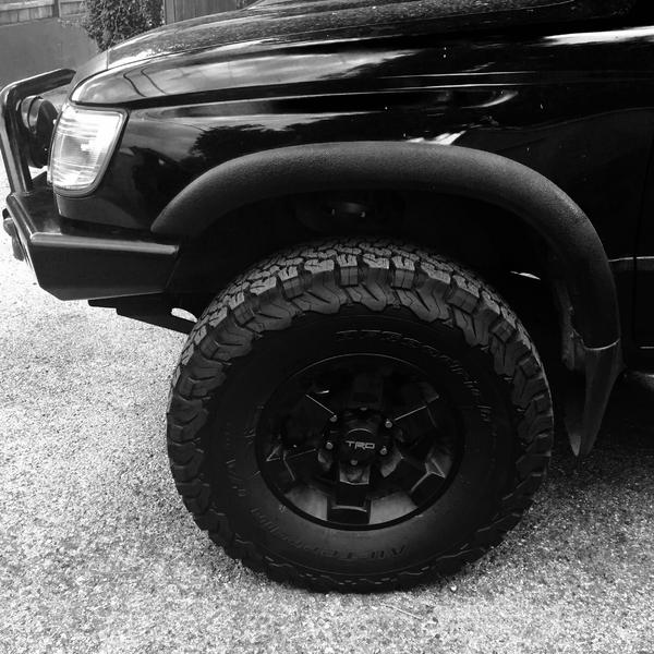

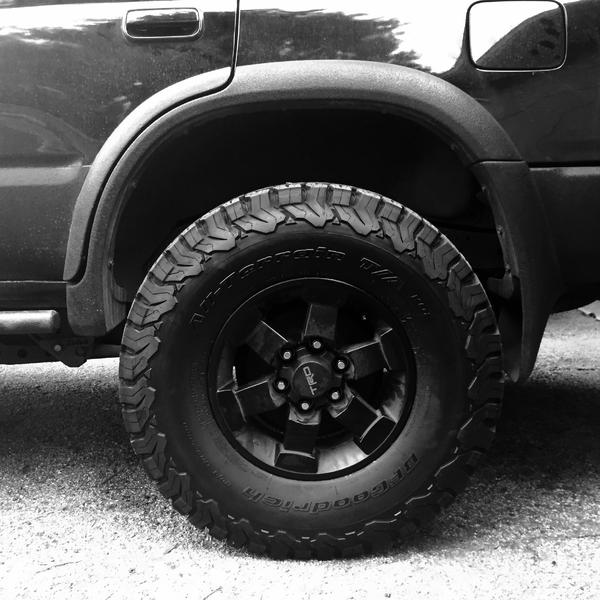

Looking for some experience/advice with the following combo:
-16 x 7.5” FJ Cruiser Black Trail Edition Wheels, 15mm Offset
-285/75/16 BFG All-Terrain T/A KO 2
-Toytec Ultimate (~3in), stock UCAs
-No BL

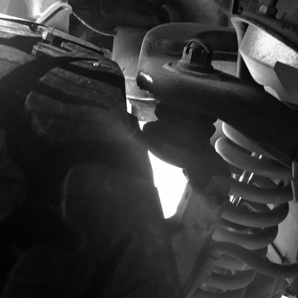

Has anyone run this combo and can comment on rubbing/need for wheel spacers, etc?

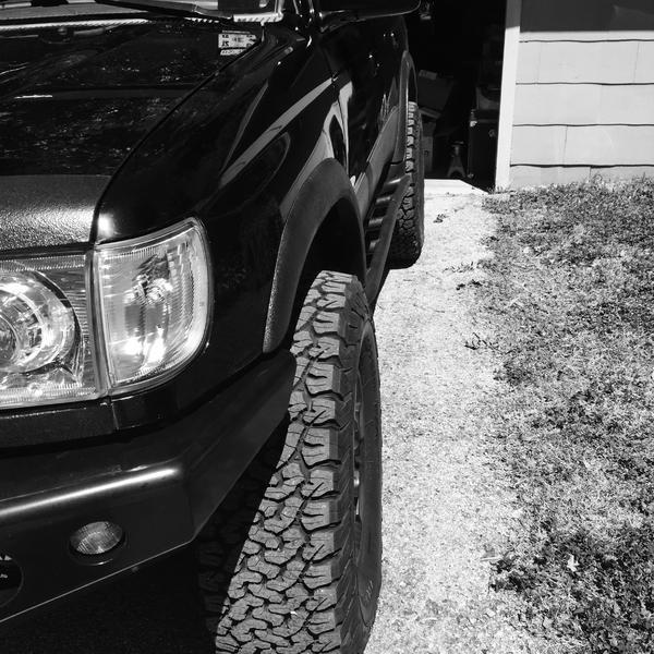

Here is a pic as sliders were going on and old tires BFG (265/75/16) just to make this a little more interesting.
Thanks fellas!

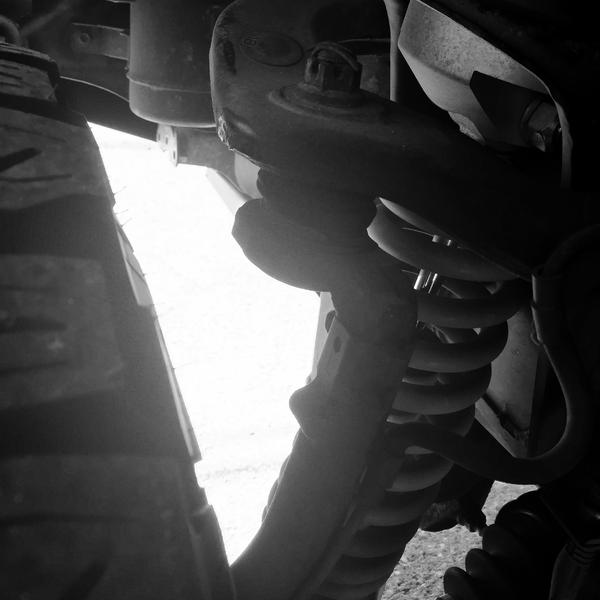

Answer to this question was...NO
Min rubbing on stock UCAs at full lock
Problem solved with some Spidertrax 1.25" spacers, not ideal solution but will work for now.
Otherwise pretty tight fit but I haven't noticed any other rubbing (yet)
The problem with spacers, 285s and certain wheels is that the rubbing is pretty rough and the spacers make it worse.
Is your front sway bar installed? With it removed you will rub on the stock UCAs but when installed you should barely rub at all.
Addco sway bars installed...all good on the road. I have yet to disconnect and wheel. I will report back what happens.
