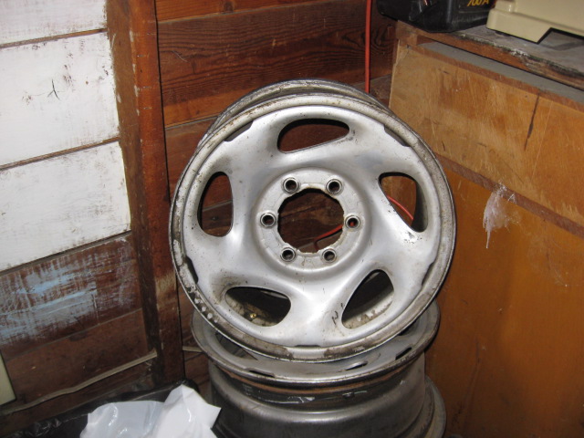

will either of these fit? Has anyone got this setup? would be 16" and 6bolt - but what about offset?

we need more specifics or pictures. multiple sizes came on these trucks and you didn't specify the year.
heres the pic of the rim - thats all ive got - other than they are advertised as 16" tundra rim.

Those will fit no problem but they will sit inside the fenders because they have very little offset(or is it too much...that one always confuses me)...in other words they won't have as wide a stance as a stock 4runner rim. I had 08 tacoma rims on my rig for a while but I had to get 1.25" spacers to push the wheel back out to factory width....
