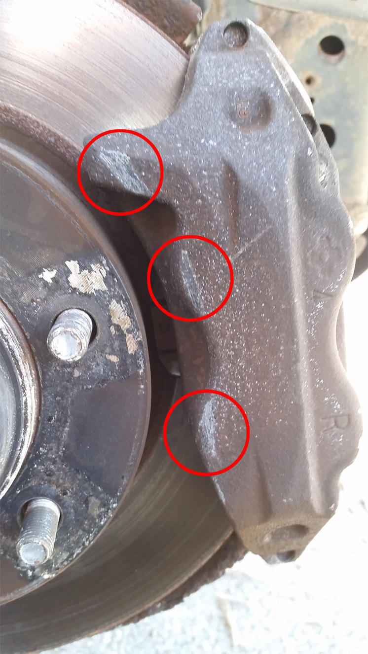

Photo #1: Rub marks on the caliper after wheels were initially mounted then removed due to rubbing and vibration. I think the vibration was from using the stock lugs from Toyota and not standard lugs. Not 100% on that. I did have some standard lugs that I was able to scrounge up and they drastically reduced the vibration when I changed them out from the stock lugs. Only had 8 so I could only do one wheel.

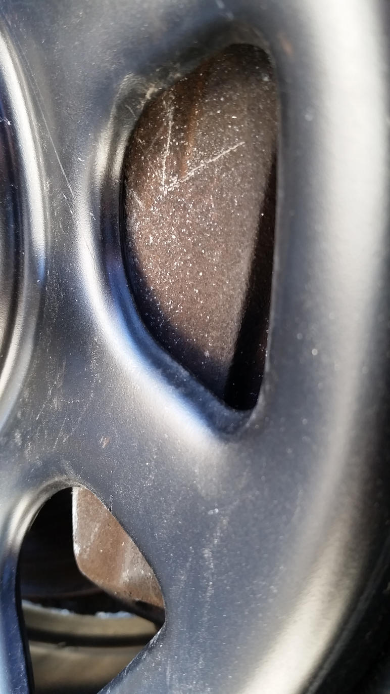

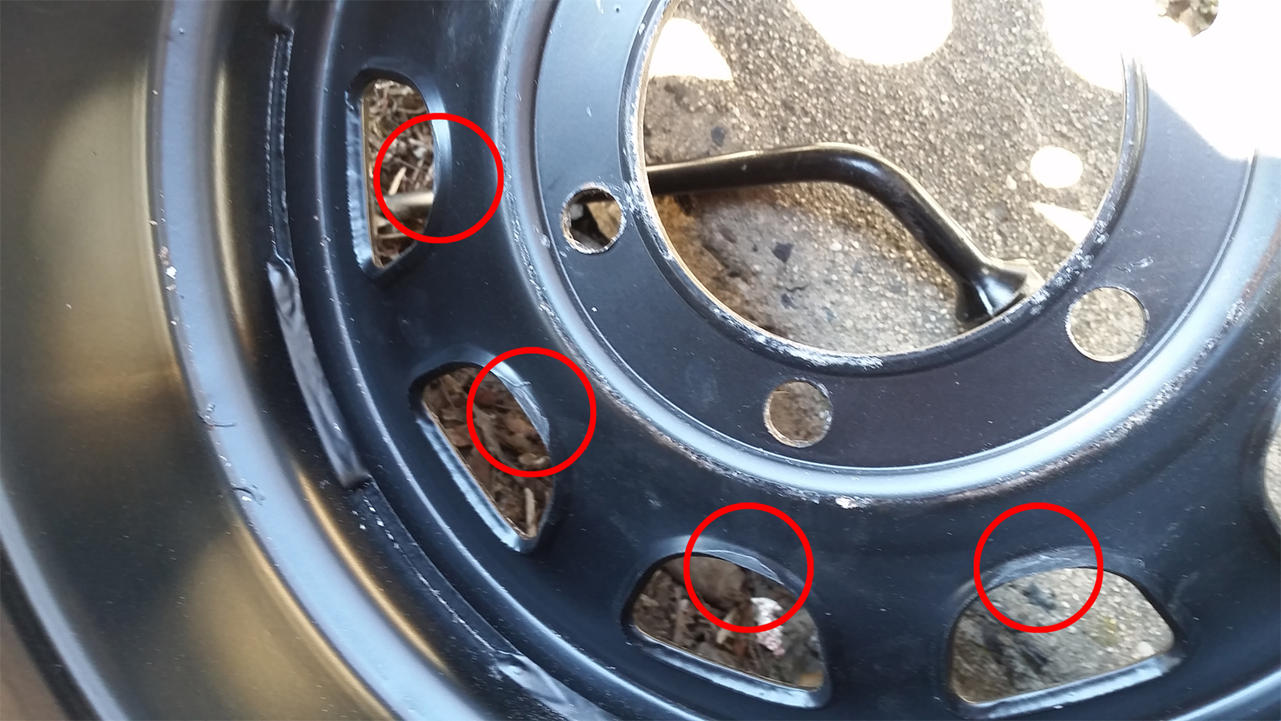

Photo #2: Shows where the inside of the wheel was rubbing on the caliper. Maybe shaved off a 1/16" to an 1/8" from each D-window? Rubbed right at the center of the curve in the so the clear coat that I had applied to the entire wheel was removed at those spots. Sorry for the blurry photo.
Photo #3: Shows that there's virtually no space between the caliper and wheel. I don't think they're rubbing anymore b/c after a test drive around the block a few times neither the wheel or caliper had generated any heat from friction but were actually cool to the touch. I couldn't even slip a piece of paper between them if I tried that's how close they are.

My pro comp 52 rock crawler style wheels rubbed the exact same way. I ordered a set of 3/16" (.1875") aluminum spacers on amazon for $20 and it solved that problem. I don't think its safe to have a wheel rubbing on something like that, especially at higher speeds so consider putting a small spacer in there.

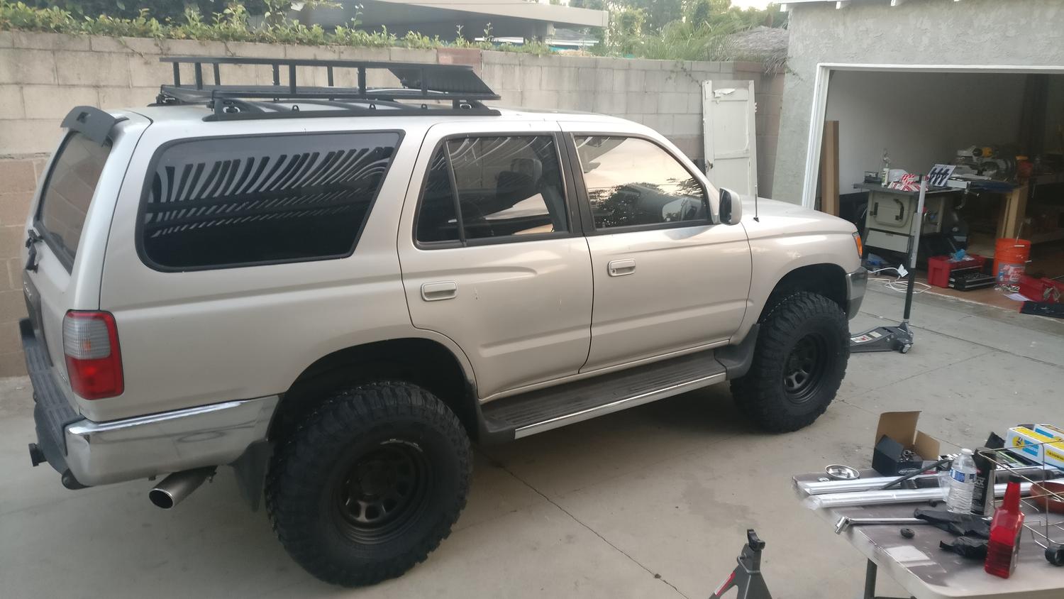

I actually took a regular old file to the outside of my calipers and some of the rubbing was fixed. The inside of the wheels shredded the edges of the D-windows but hey, whatever.
Also forgot to mention a major part, I have some rubbing on my running boards on tight turns so I'll need to dremel the corners a tiny bit. Still drivable.
I run 51 Series with 2mm spacer in the front. Runs great and no issue.

Looks great. Is this with the tundra brakes though? and if so what size did you go with?
