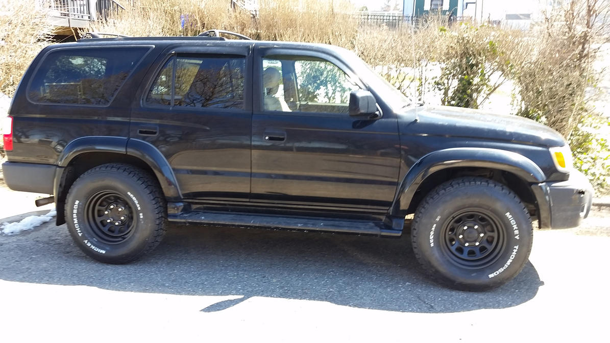

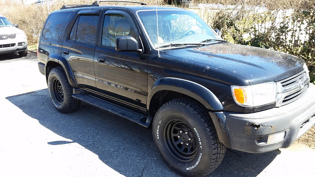

Here are a couple of photos I took over the weekend. I'll still need to get some standard lugs on the 2 rear and front driver's side.
I won't be driving it until that happens and then I have a professional look at it.
