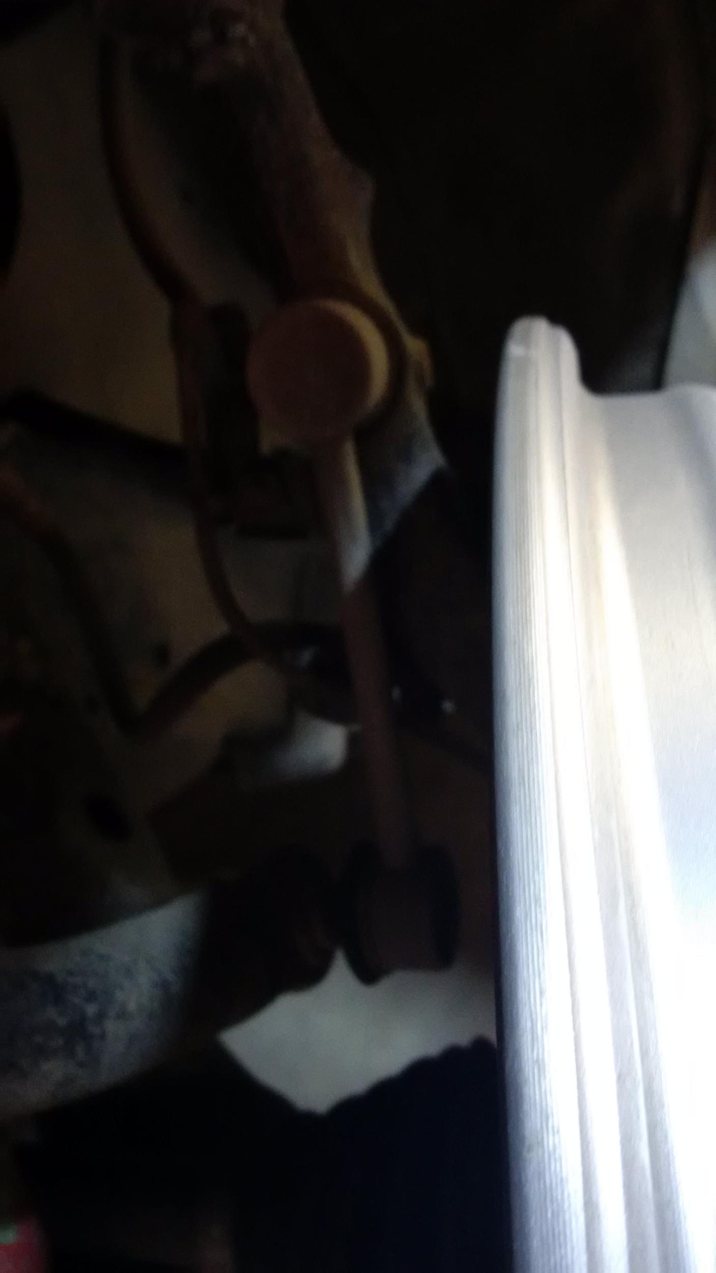

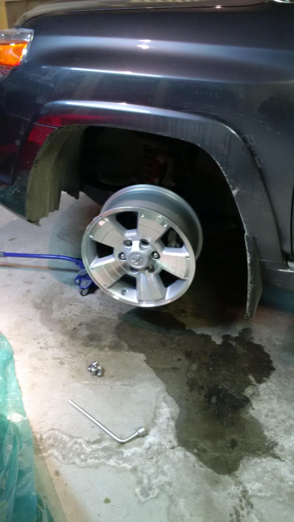

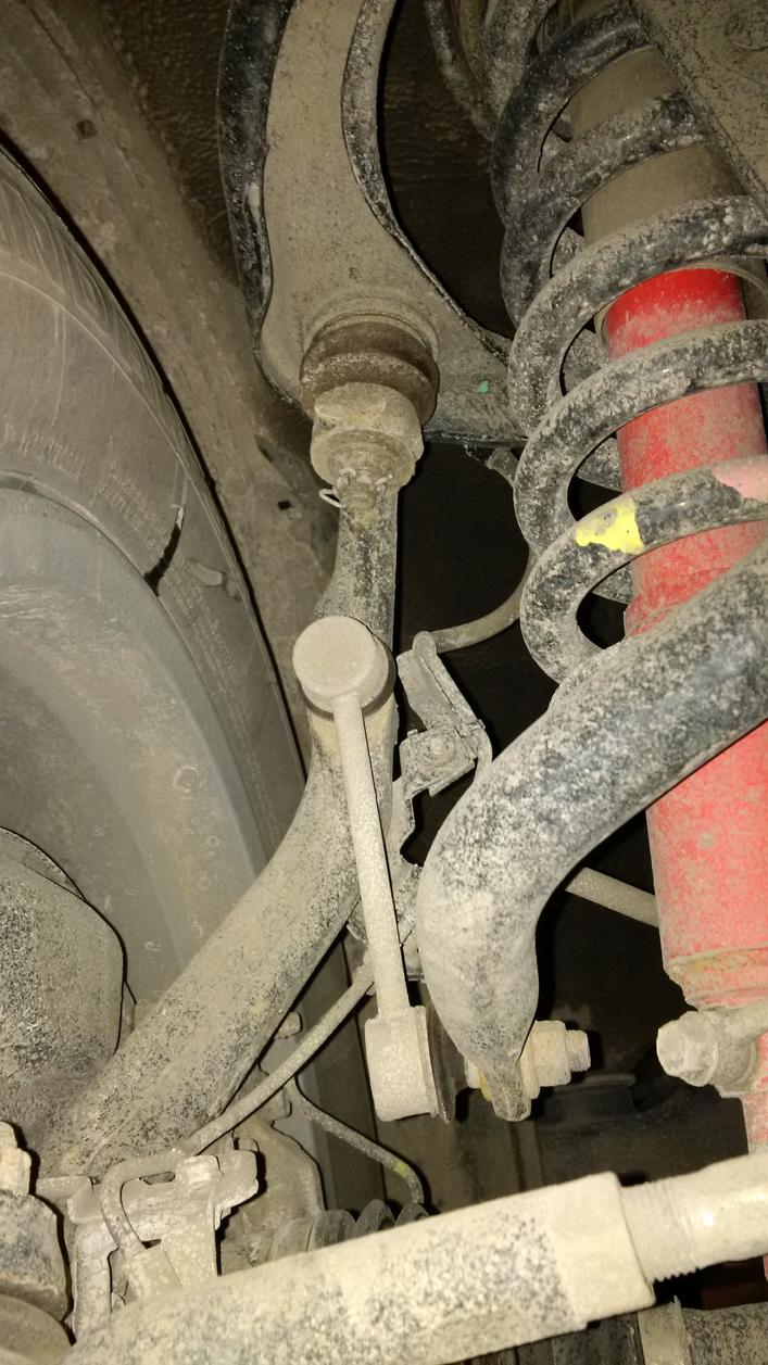

I mounted one up and the edge of the rim sits about an inch away from the knuckle. These wheels do sit a bit more inboard than the stock 20s.

Hallelujah ! I have been asking if someone has done this before and if pictures were available. They actually look pretty good

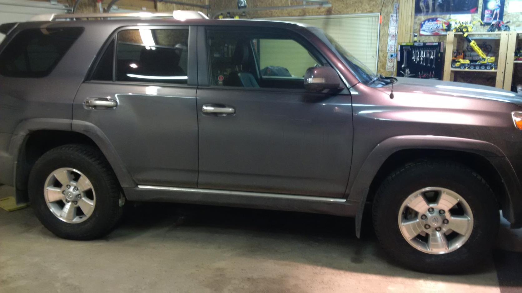

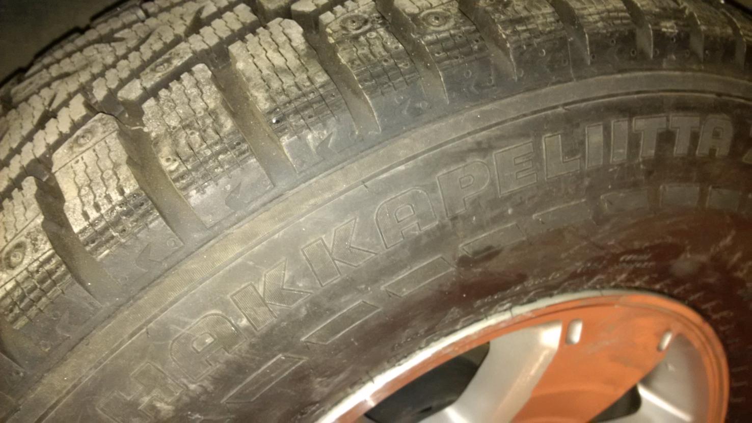

Everything fits just fine. Tight but no clearance issues. Loving the Hakkas on the ice and snow up here. They were a real bugger to balance.
