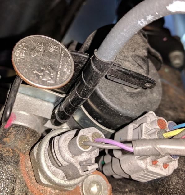

Second view of diff locker quarter to show scale.

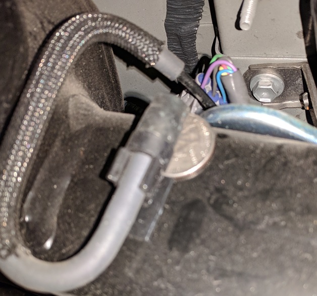

Here is the end of the diff locker breather line, this shot is a little crooked as the last bit of line is actually vertical. I guess the height is around the top of the wheel rims (?)

With the elocker, you are going to extend the tube which is usually hanging on a subframe. It’s the tube with a one way valve. So you need to buy a cheap plastic hose connector to connect the oem tube to your arb tube.
Edit: as shown in your pic

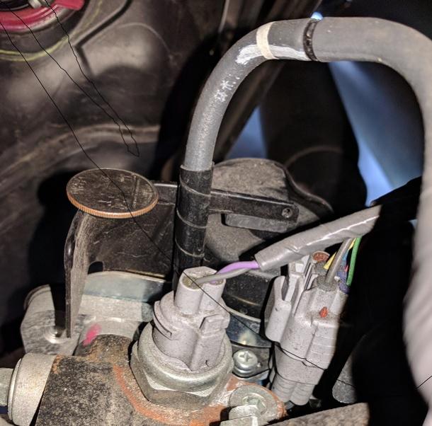

So yeah all the locker parts seem tinier and more difficult to access than the rear diff, so I decided that for now I had better just leave it alone.
I can't figure out what that connects to or how on top of the actual locker, or if one of those ARC shark bit things would screw in if I removed what was there, if I could even get to what is there. vs just pulling that hose out and finding out that way, ummm no thanks!
Yeah that is what I was thinking. But not sure what type of hose connector, a sleeve that goes around the outside of both hoses perhaps?

You use a tube fitting and you only pull the one way valve off. U leave the rest there. I’d take a pic for u of mine if it weren’t raining.
Search 5th gen e locker breather kit, you will see the fittings im talking about. Currently I’m on my phone so I’m not very helpful.
I think I used a Plastic T-fitting because I was lazy n connected the elocker tube with the diff tube
That's great, here is another question about the whole system, not to overthink it or anything.
1. ARB says their tubes are a skosh bigger, 8mm, so that any oil getting up in the line when off-camber driving won't clog.
2. What kind of oil is inside the locker? How important is the diameter of the tubing once you get well away from the diff or the locker itself ?

Another point I am a little confused on.
Are the original caps/valves on both the differential and the elocker one-way valves, or is the elocker cap a breather?
Just wondering.
Thanks !
:artist:
https://www.toyota-4runner.org/2087322-post34.html
Toyota has made both kinds: the one-way, and the two-way. They are both Toyota parts.
The one way is threaded and screws into the diff.
The two way has a simple hose barb, and is intended to be placed at the end of a hose.
I don't have the part number for the two-way one in front of me, but right now I've got both types in my spare parts box.
The one that came on my '97 3rd gen, as well as the ones that came on my 4WD '91 truck, and two Land Cruiser FJ 60's, were the one way type.
Additionally, the one way is all metal(except for the rubber flap inside), while the two-way has a plastic body with a metal cap.
I got underneath there and put onto the locker breather a piece of gorilla tape and 3 or 4 pieces of electric tape to close it up. I feel pretty comfortable with that for a quick trip to the desert, assuming I will have to make a few stream fording.
