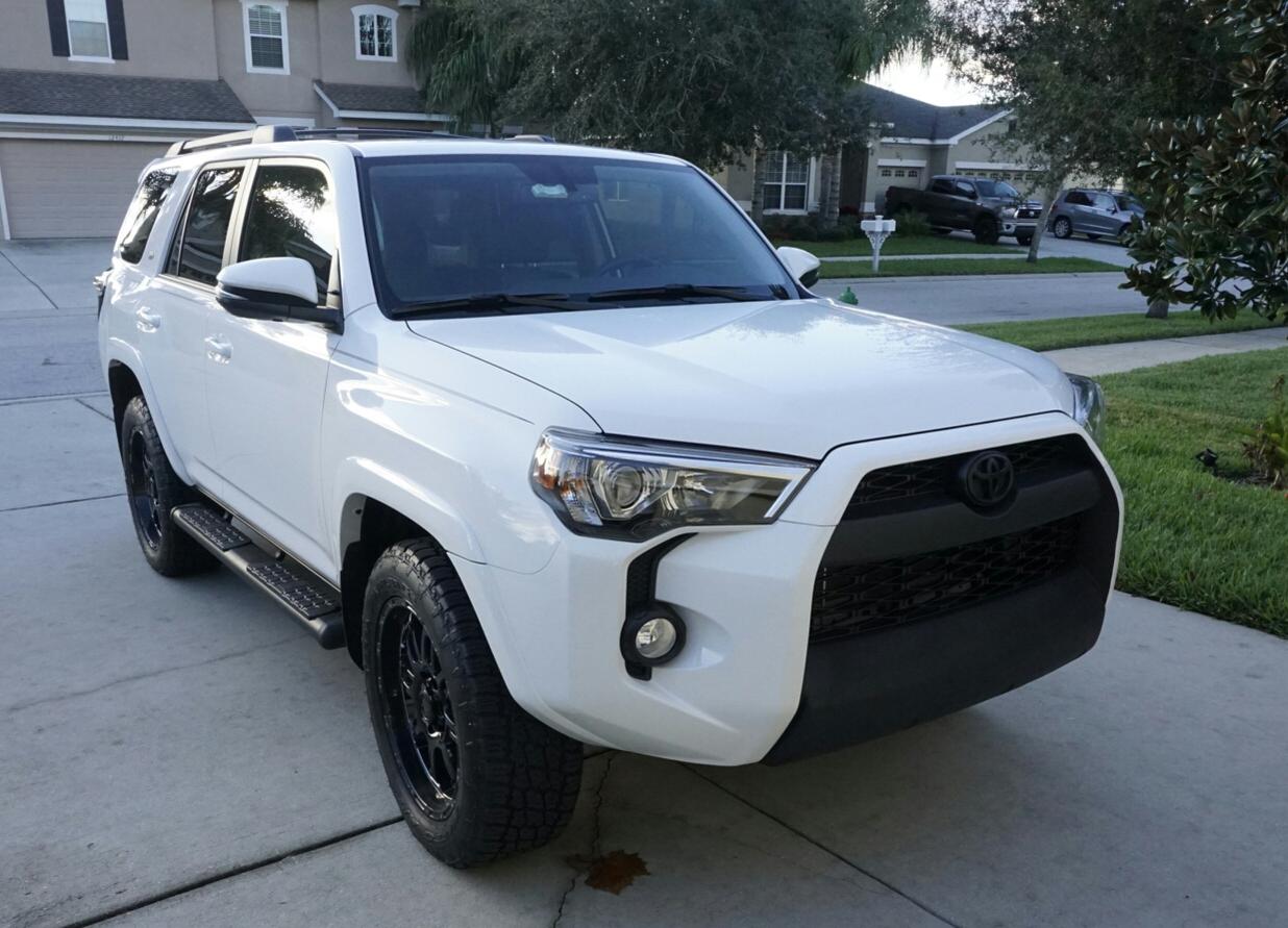

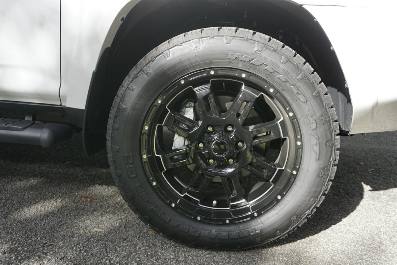

I have the XP 20 inch wheels on the SR5Premium 4x4. I don't know if they are more beneficial than the 17s but I really like the way they look.
