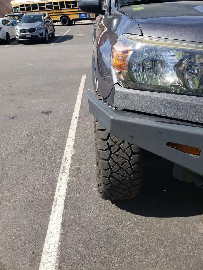

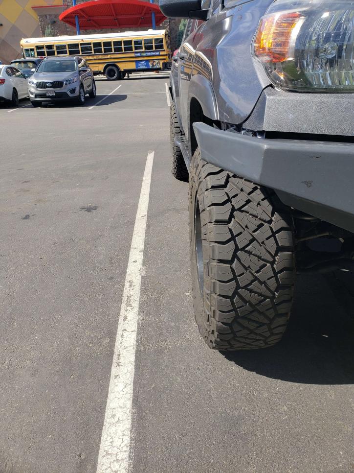

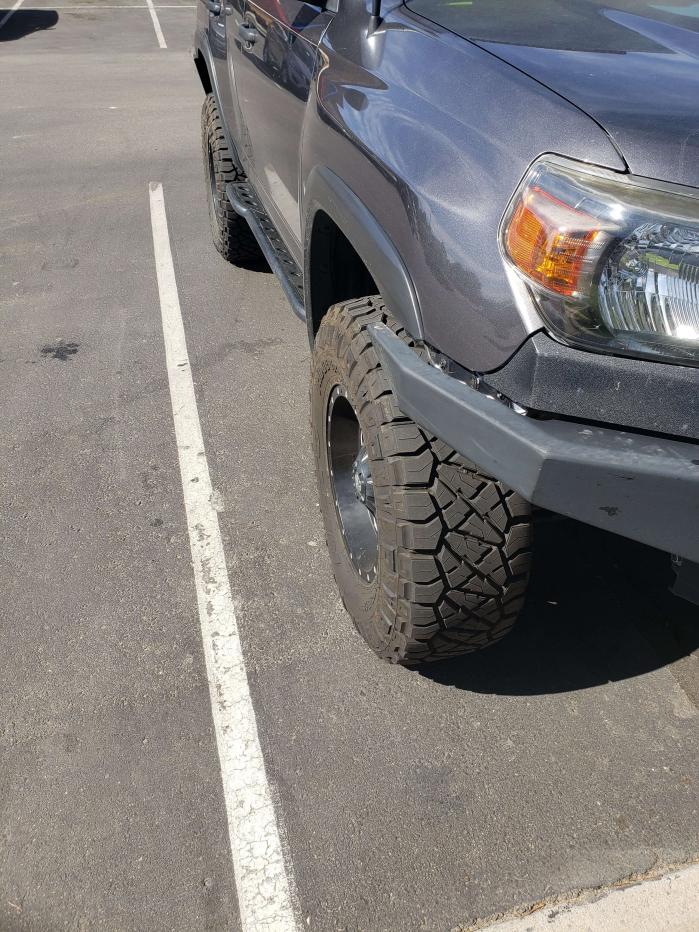

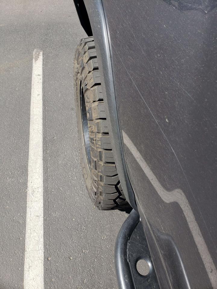

I have a 3" lift with 17x8 +10 offset wheels and 285/70/17 tires with fender liner trimmed. Its worked well but I am interested in different wheels that are 17x9 with 0 offset. I was told this would widen the stance, moving the wheel out about 1" on each side. Hoping someone has this setup and can share some pics! Thanks in advance.

I'm close I suppose. 17x9 with +1mm offset. The pics I attached are 305/70's. Hope this pics are ok, ran out at lunch to take them
I have run these rims for years on a number of different tire sizes without any issues other than more aggressive trimming to fit the larger sizes. I have however always had the BMC which I don't think you mentioned. In the beginning I was on 285/70's and had no rubbing issues with the BMC and some minor fender liner trimming. Keeping caster at around 4* would also be important.

Thank you, great shots and helpful information! Previous owner definitely trimmed the liners and pretty sure the bmc as well. Running 285/70/17 with zero rubbing. My main concern would be if going to the 17x9 would push the tires too far out but your rig looks great so I'm really considering and the offset you have seems close.
