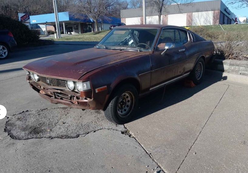

Going to look at a 1977 Toyota Celica GT liftback project car. Motor is seized, but I already have plans to swap the motor. These things are crazy rare, only maybe 10 for sale in the entire country at any given time, not to mention not all are the hatchback. I've been looking for one of these for a couple years and one finally popped up for sale 2hrs away.

After looking for years I finally found my Celica. 1977 Liftback Celica GT, they only made the liftback for two years in the US and its commonly referred to as the Japanese Mustang.
