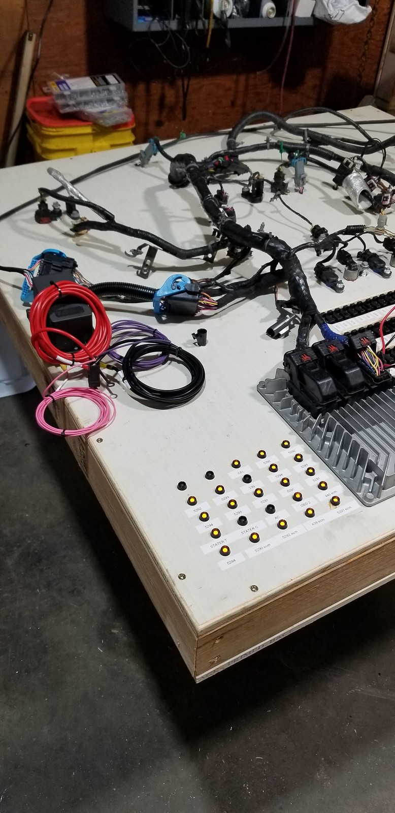

My harness and ECU is currently getting converted to stand-alone at Keisler Automation. They sent pics.
Since it's a used harness they even tested it for me and fixed a broken wire.

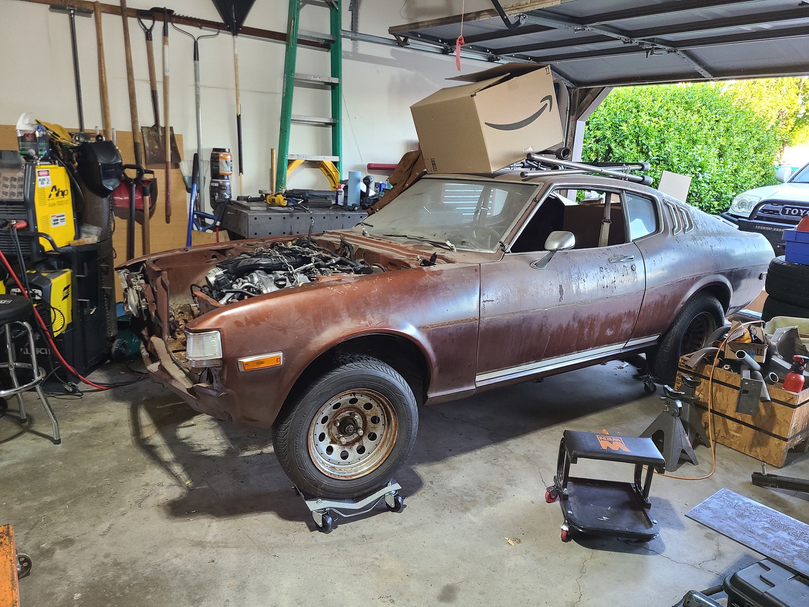

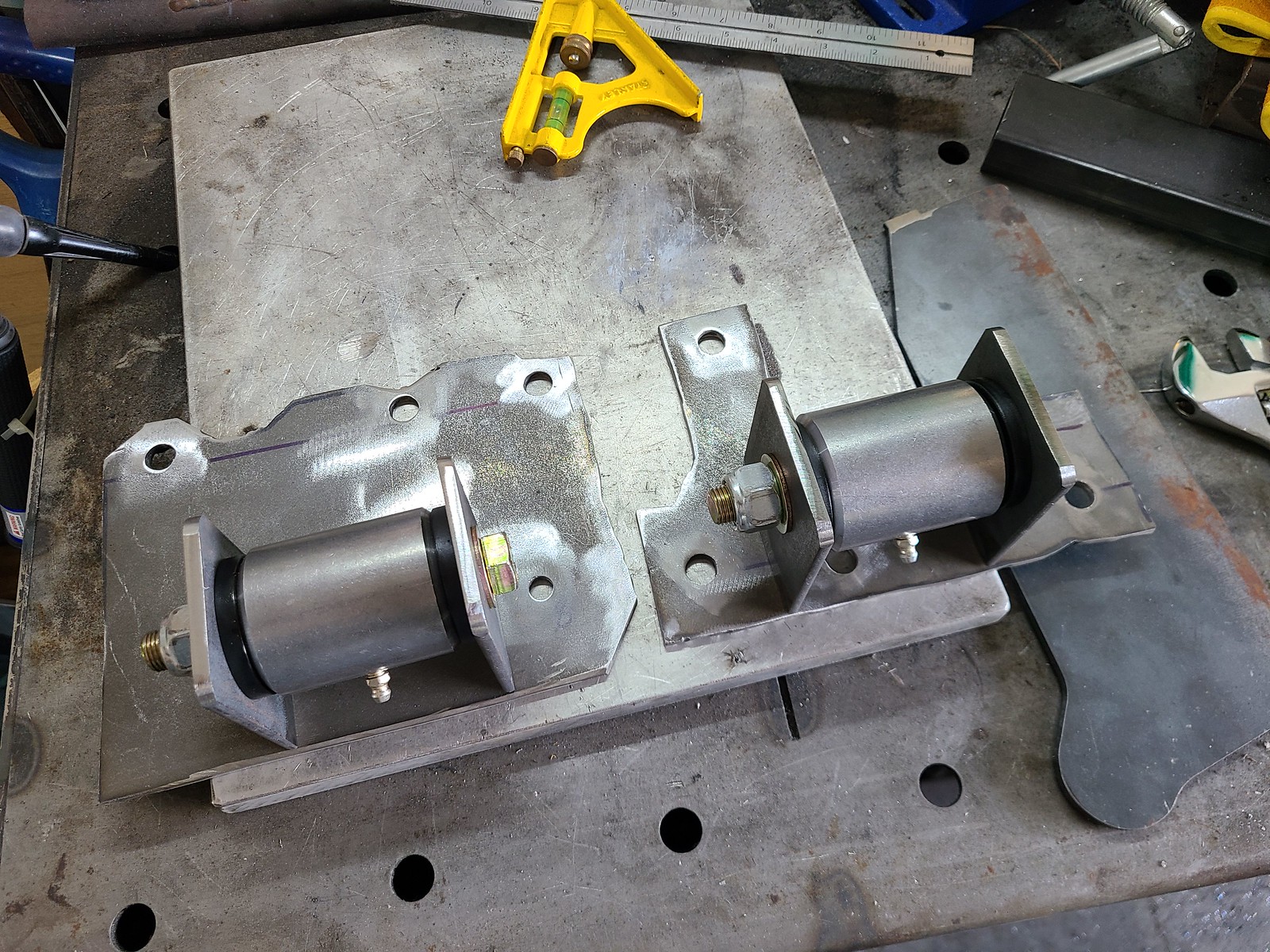

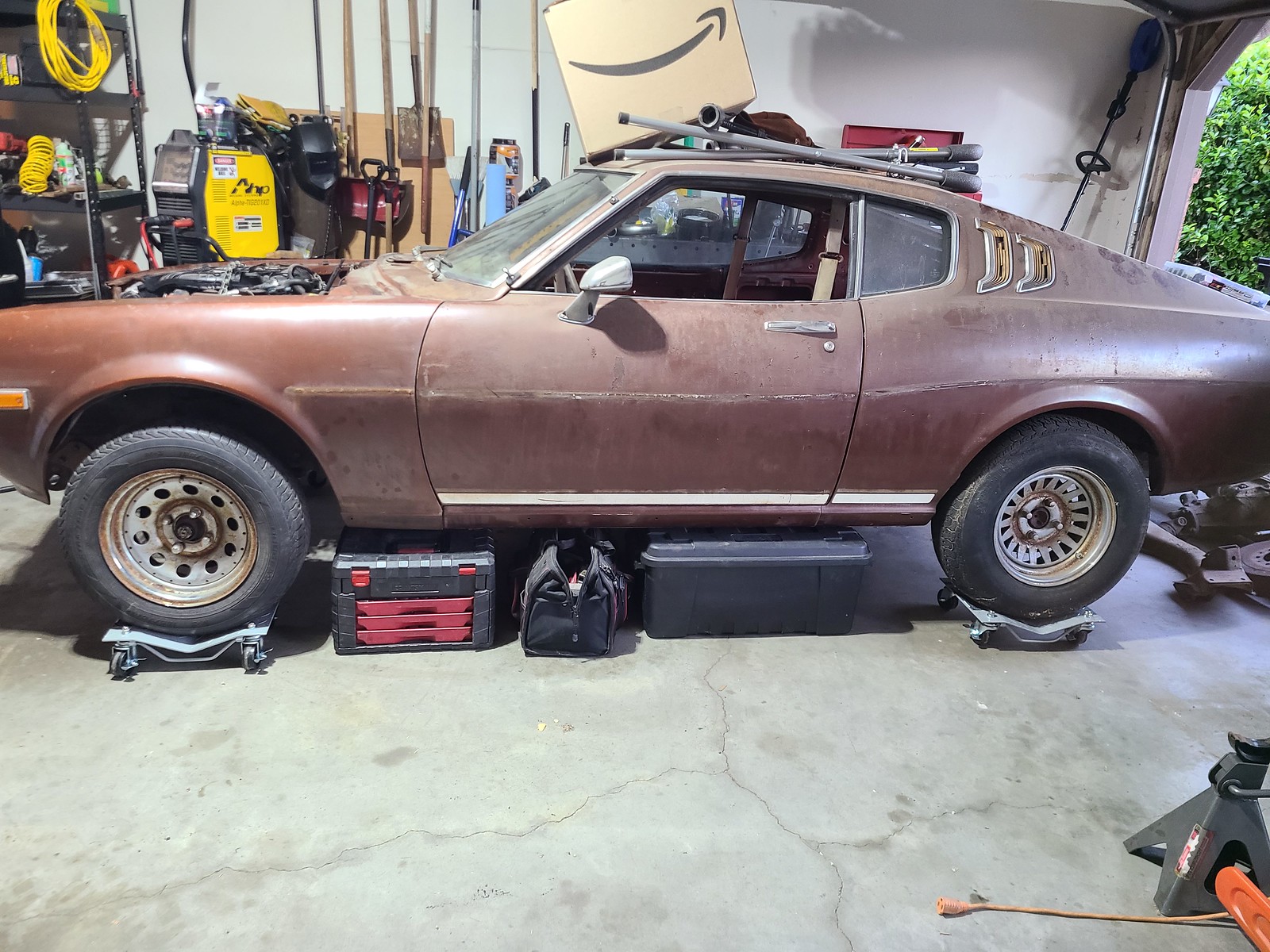

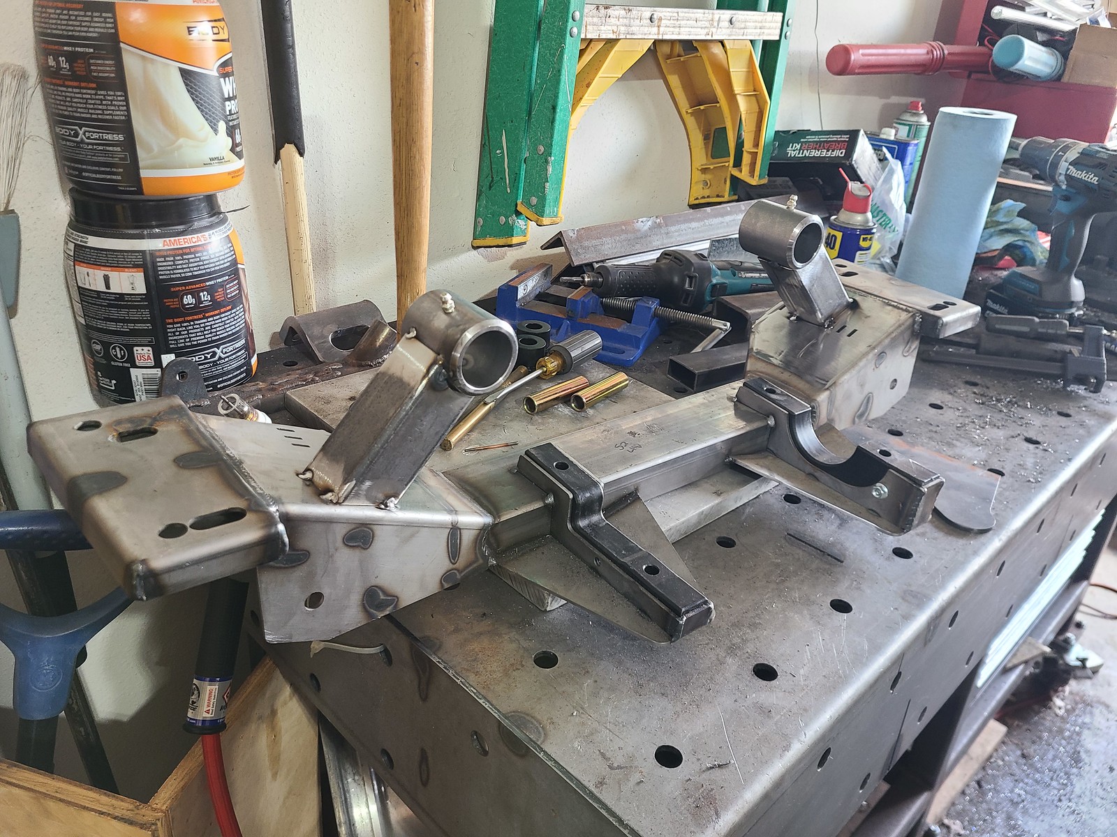

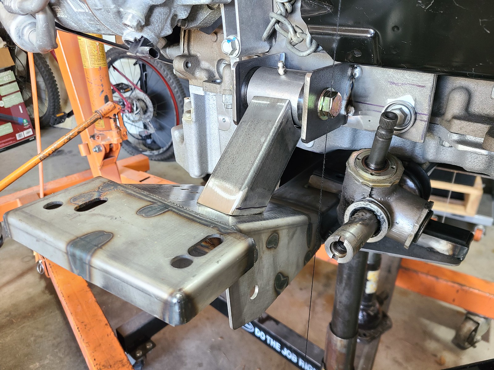

Took 3 days off for my birthday and to get caught up on 4Runner and Celica projects. First project was to get the Celica motor mounted so I could roll it around my garage in one piece on tire dollies I bought from harbor freight. Rolling it around would help with accessing my welding table for future projects. The goal wasn't to make 100% finalized motor mounts with rounded corners and paint, but to just get them prototyped and working. I can clean them up later or use the dimensions to cut on a laser table.

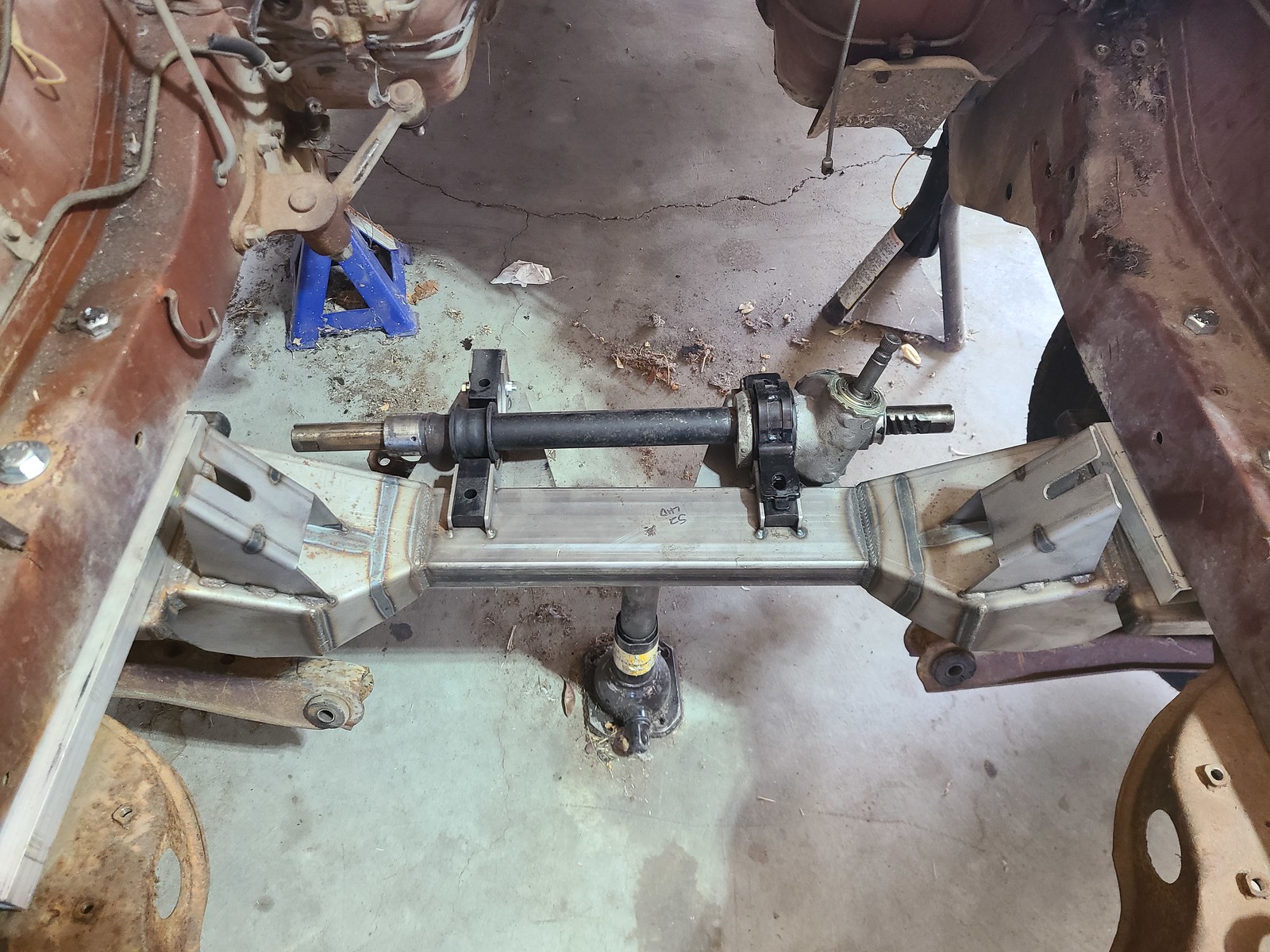

Crossmember with the manual Corolla rack:

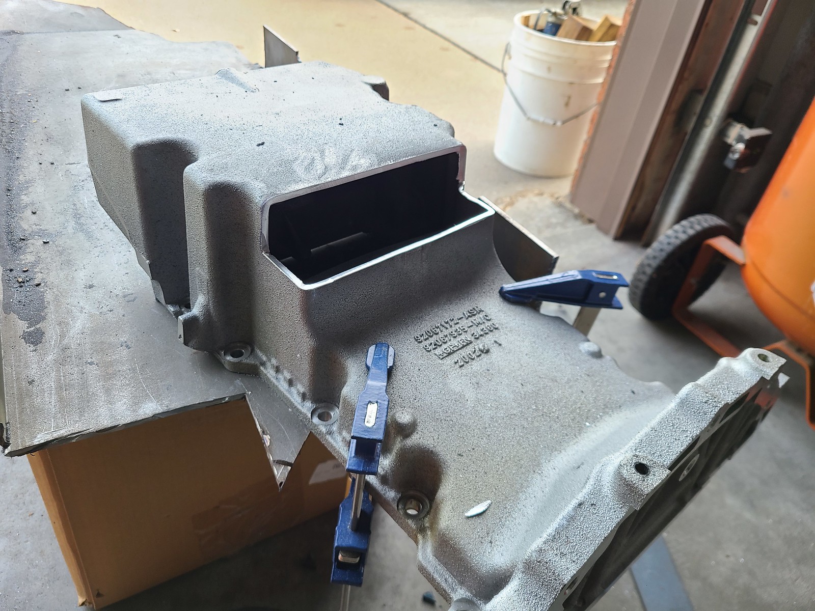

Did what I had to do to the oil pan to get the steering rack to fit underneath. Will weld it later. I cut a few inches deeper than this pic afterward.

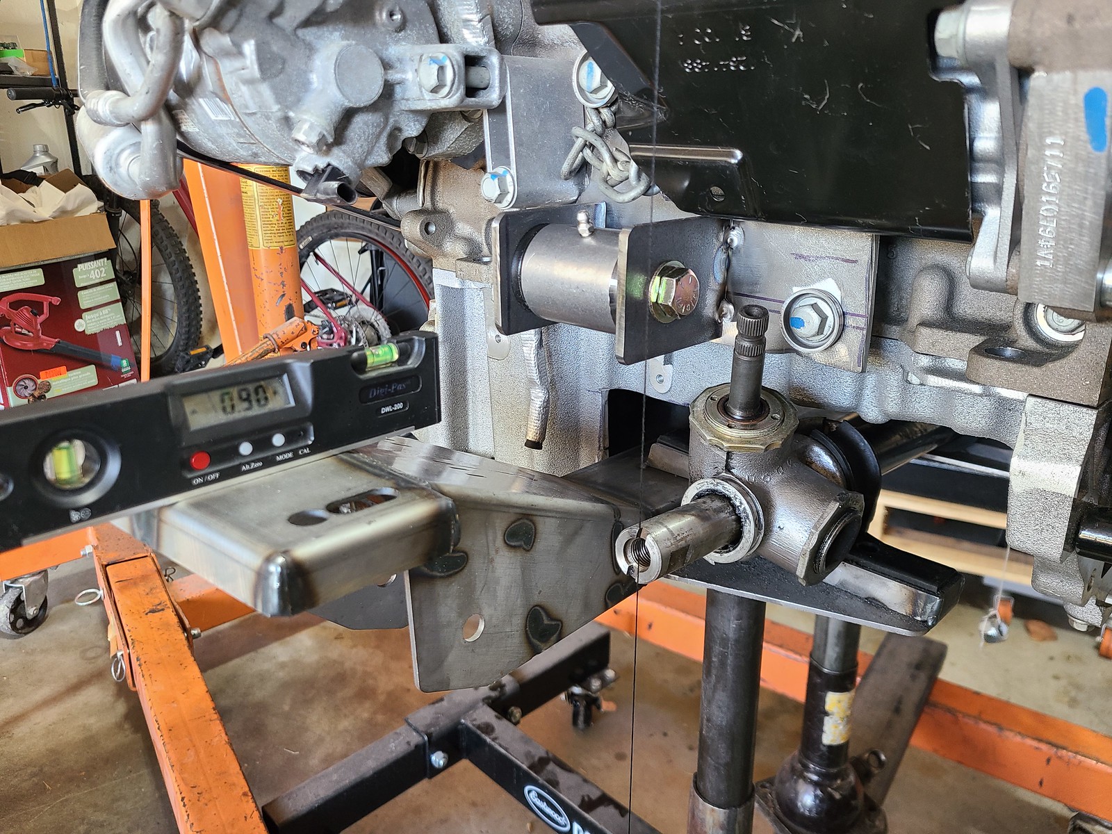

Using a couple plumb bobs and a digital angle gauge I was able to locate the crossmember with respect to the motor and tack weld it in place outside the vehicle.
End result of the crossmember:

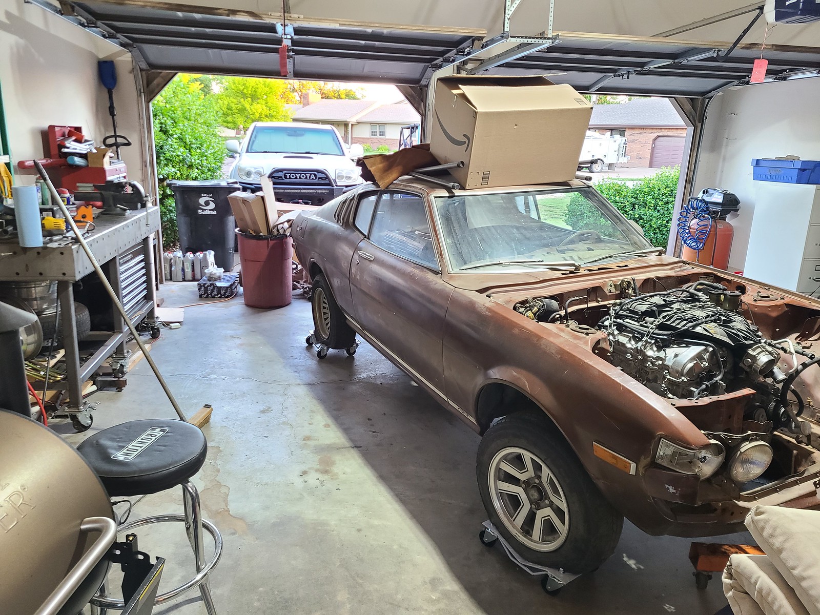

The GM LFX motor sits in there just about perfect. Close to the firewall and centered. I even think the hood will work. Next step is to buy some cheapo 14" tires to throw onto my 2nd gen Celica 4 spoke wheels so all the wheels and tires match and I no longer have 2 flats lol.
First time it's been off jackstands for a few years! Wooooo!
