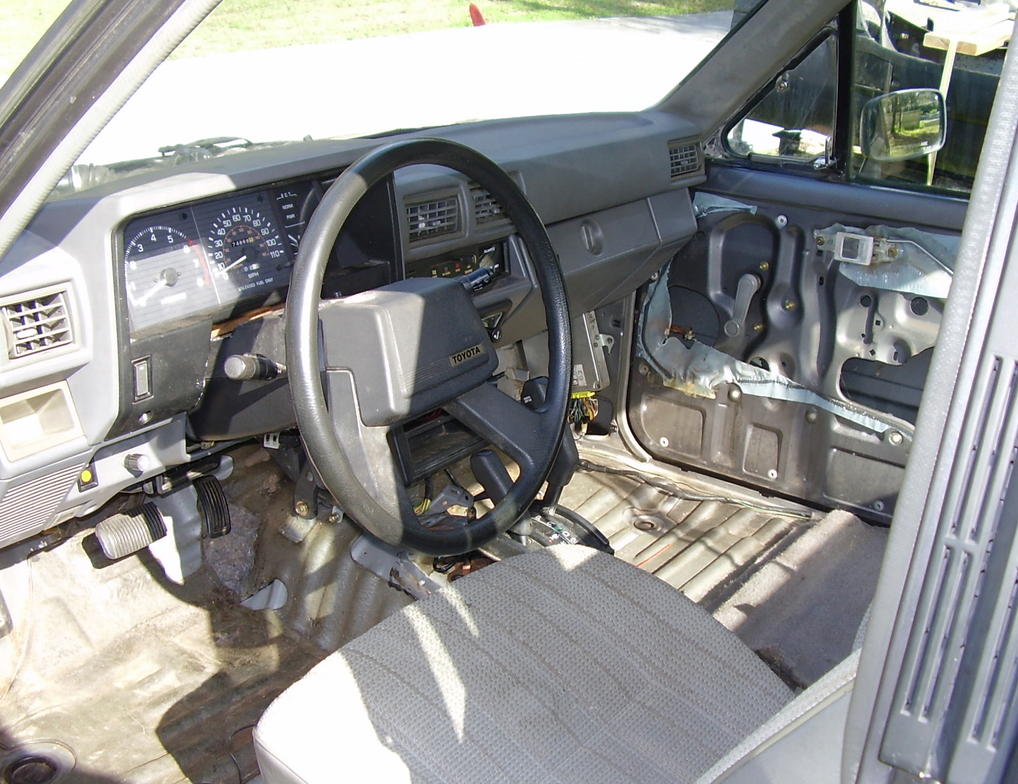

Hey guys:hello: I’m back with a new “restoration”/build of a 1986 eXtra cab 4x4 pick up with short bed. I am doing the build with and for my son I also have a good friend helping with the mechanical end of the build.
This build will go deeper and be more involved than the project 88 4Runner build I did see link:)
http://www.toyota-4runner.org/classic-t4rs/54630-project-88-restore.html
I need a good rust free bed for the truck and the B pillar garnish for the passenger side of the truck cab.
We are putting together the engine for it right now and I am not sure if I should go for the OEM Genuine Toyota timing chain, the LC Engineering, or an eBay special???? We don’t plan to add any performance upgrades the truck will be put together bone stock for the most part.
We bought the truck less the engine and plan to use the engine out of the 1985 4Runner parts truck we have. The 85 T4R is a 22re automatic transmission with only 83k miles. We are using both engine and trans for our 86 eXtra cab.
Let the fun begin:cool:

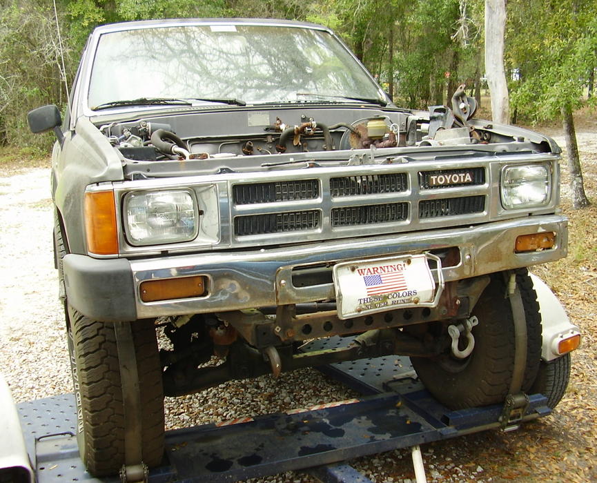

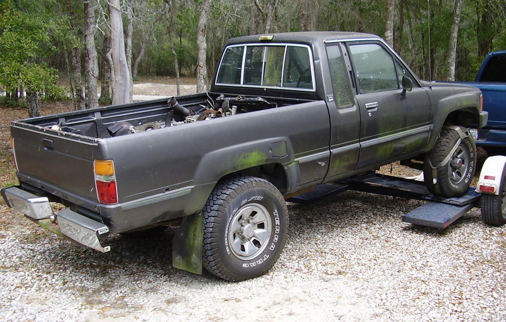

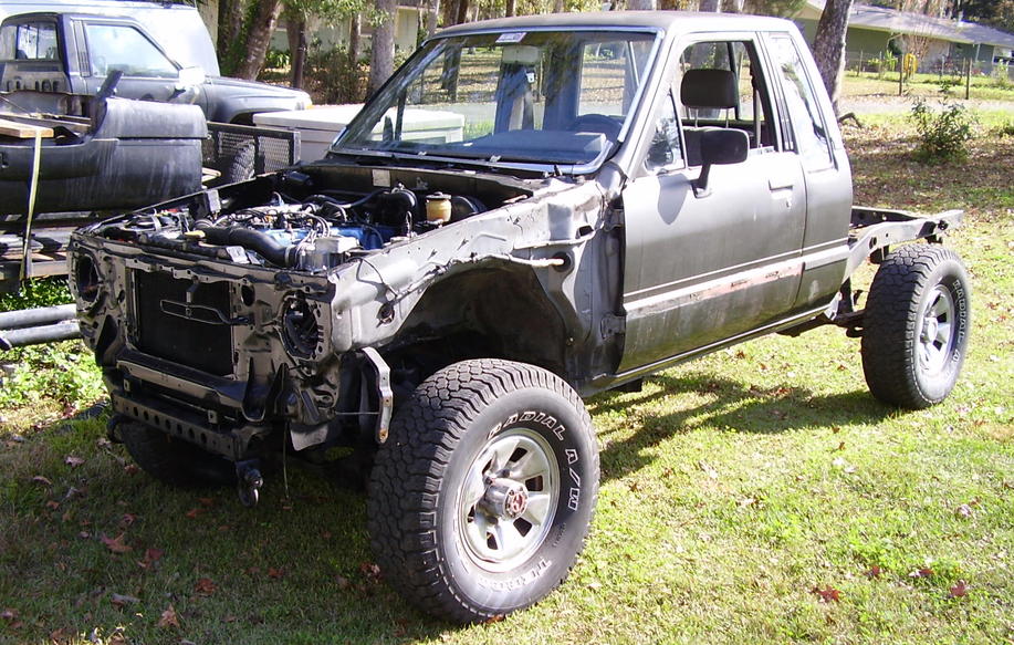

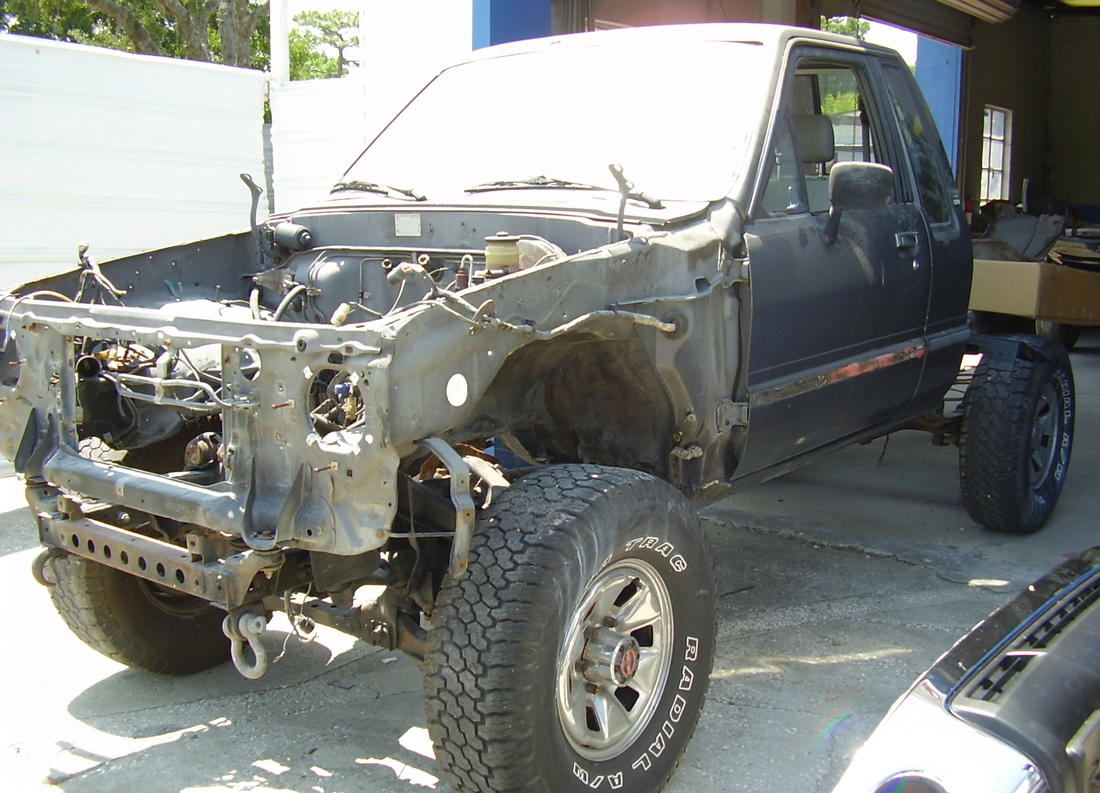

We have a lot of the body removed from the truck and also the 5 speed trans is out.
The truck was found in a back yard here in the Tampa area and had been sitting for years. The owner poped the engine after running her hot then, removed the engine and she sat till a Craig's list sale ad saved her:)

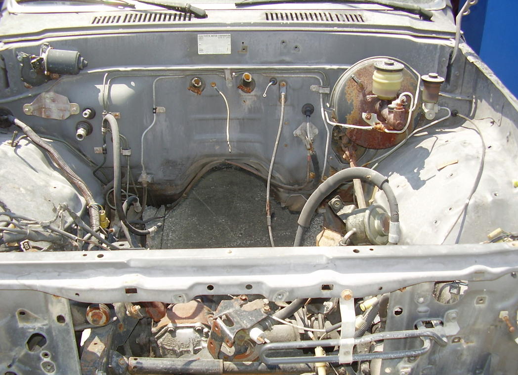

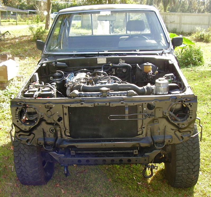

I have some updates to share....

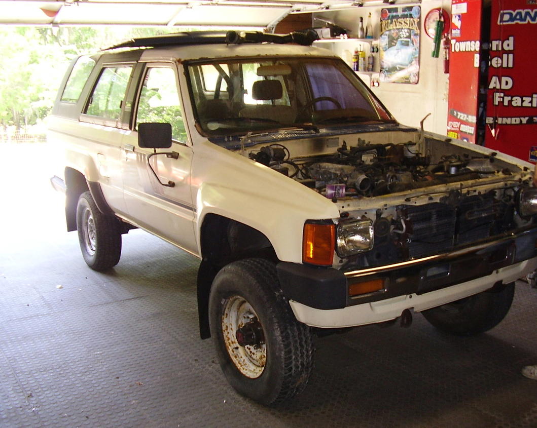

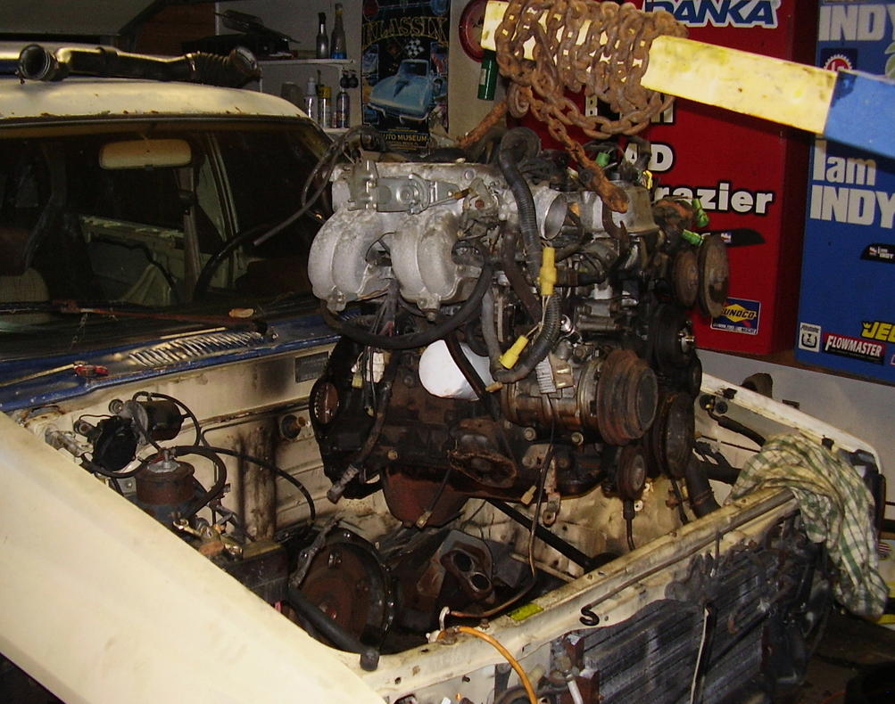

The engine, auto trans, and lots of other things removed from the 85 4Runner.
On the 86 pick up,
The clutch master was removed and the hole welded over. We removed the rusted battery tray and welded in the mint tray that we removed from the
4Runner.
We cleaned and painted the engine bay in satin black....looks great:thumb3:

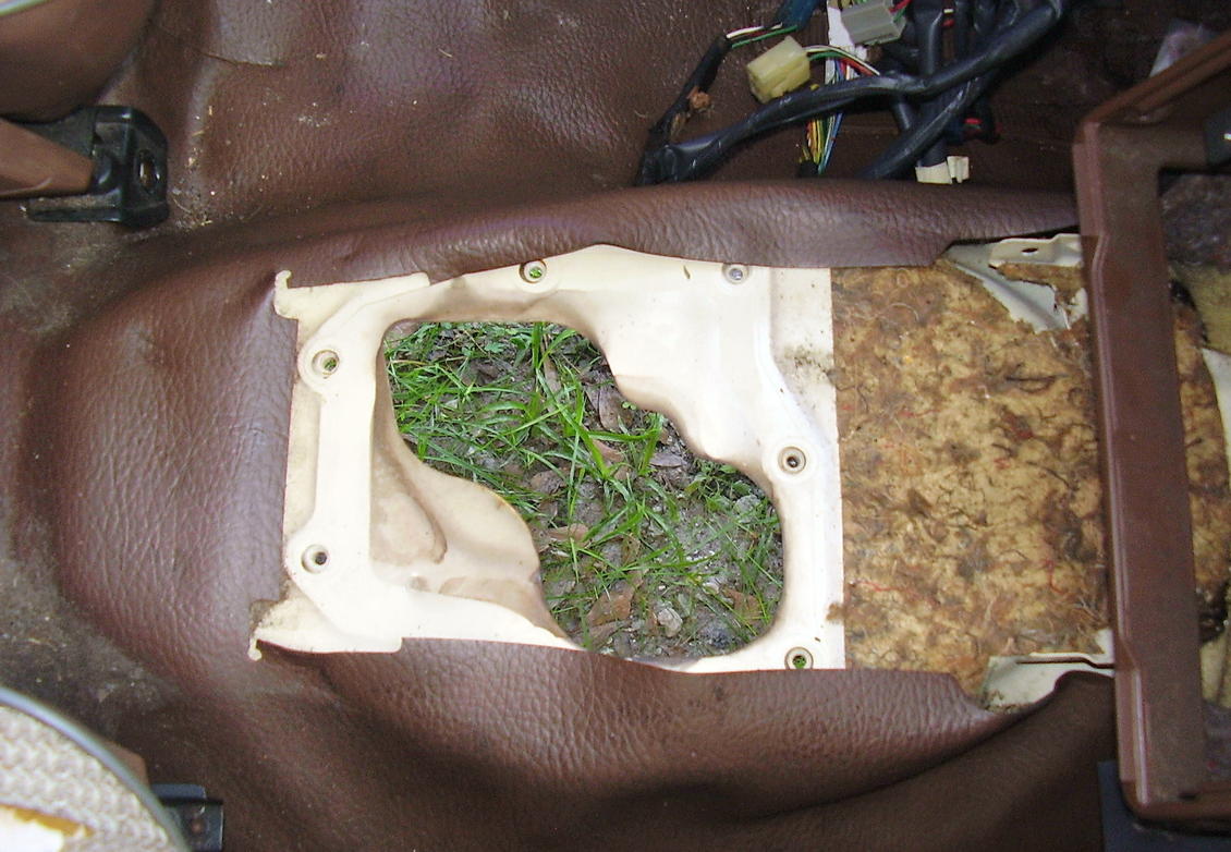

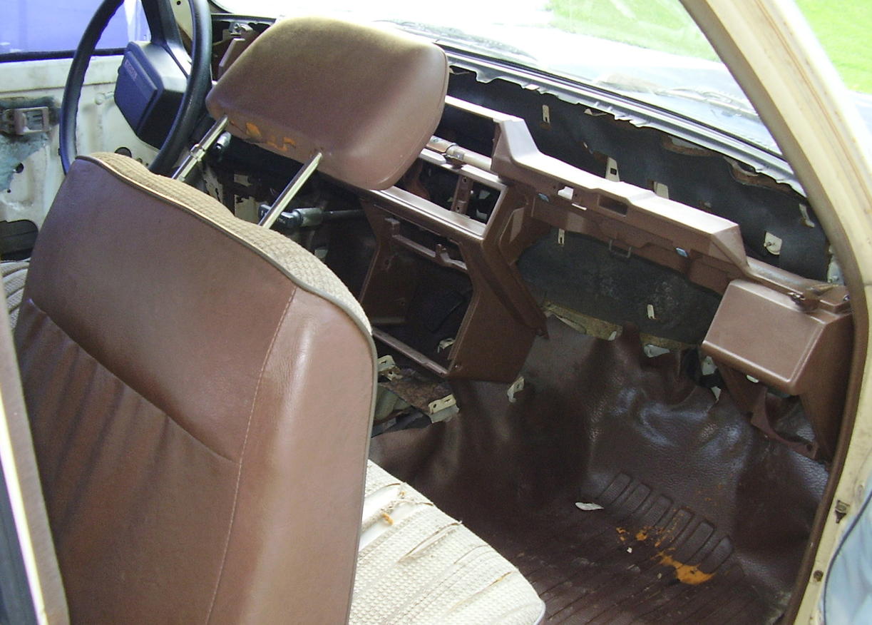

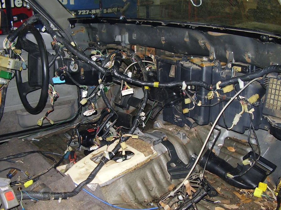

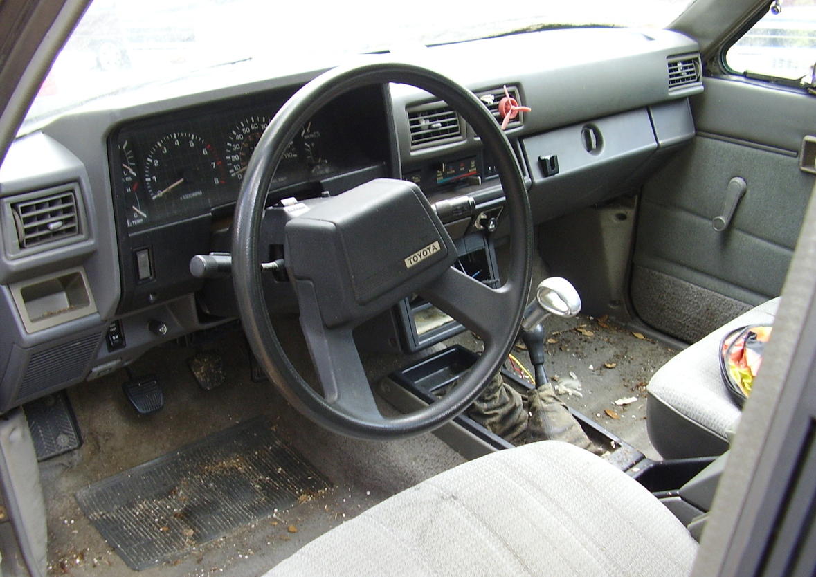

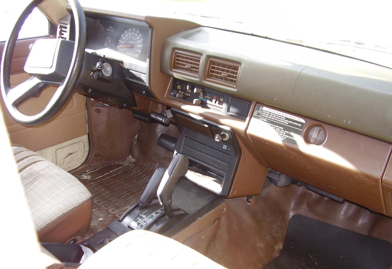

In order to go from 5speed to automatic we removed the dash and all wires from each of the trucks. We used the complete wire harness from the 4Runner in the pickup. Some modifications had to be made to the wire harness as there are things that differ from the 2 trucks. Using parts from the pickup trucks wire harness to do the modifications needed, the harness looks completely stock.

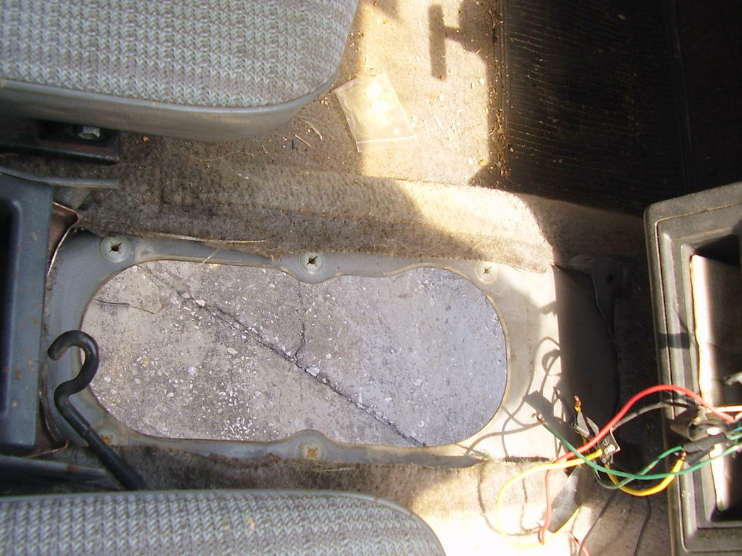

We cut out the section of floor in the 4Runner under the shifter because the holes for the shift linkage is very different between the 5speed and automatic. We installed that section of floor into the pickup so that the floor would be factory correct.

i got a question why didnt you rebulid the 4runner instead of the truck

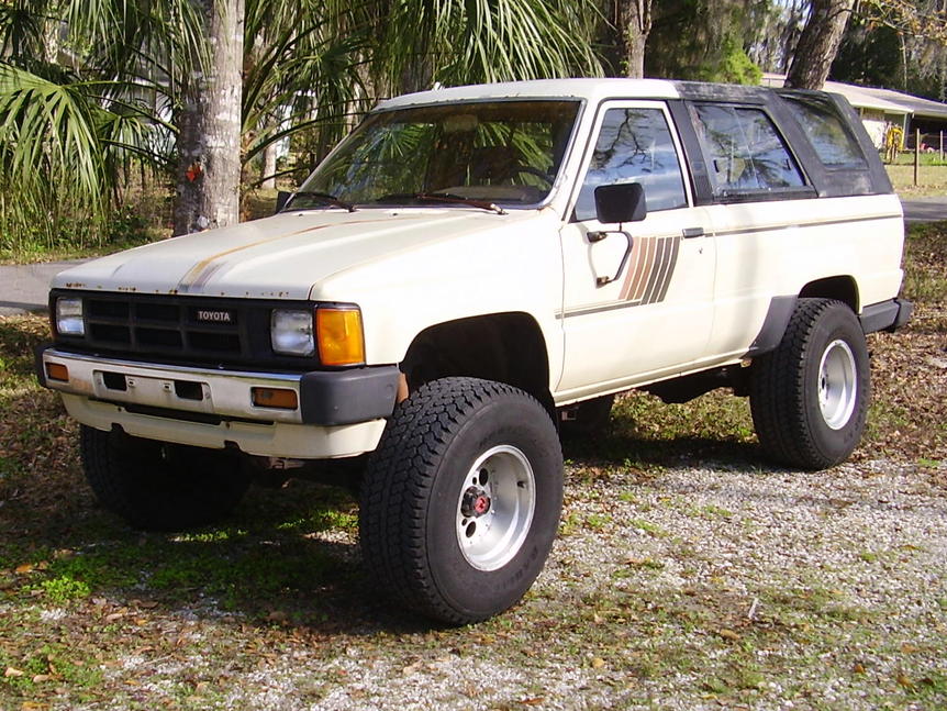

A few reasons...I built a 4Runner already, the parts 4Runner had bad rust issues around the windshield and other places that would have made it a hard restore.

So are you going to swap the whole entire center console from the auto since it's all different?
The shift console will be the factory auto shift setup. I have some of it but not all yet. The parts truck has the brown/red interior and I need gray to match the pickup interior. I may just paint the brown/red stuff I have gray:artist2:

A few funny things we found in the engine when we pulled it from the 4Runner...
There was a 6" long screwdriver in the #3 intake runner and a mud wasp nest in the plastic intake tube that blocke 90% of the air flow:wow: The truck did start and run ok even with the blockage(s) LOL

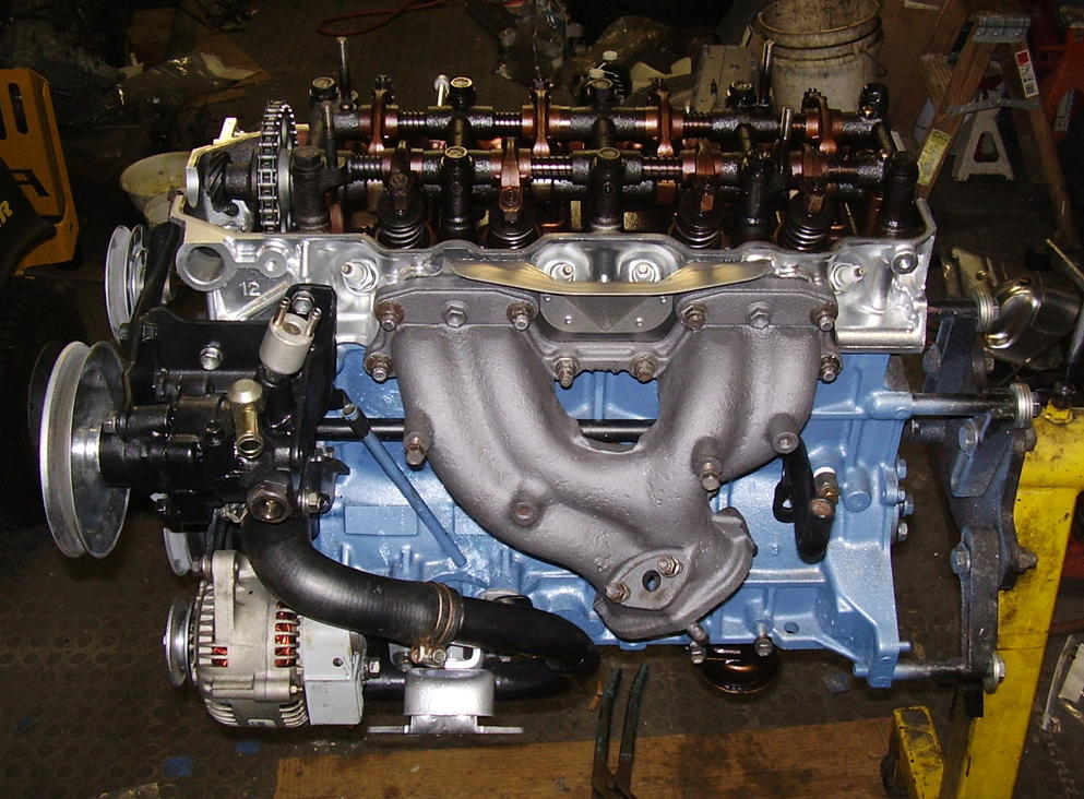

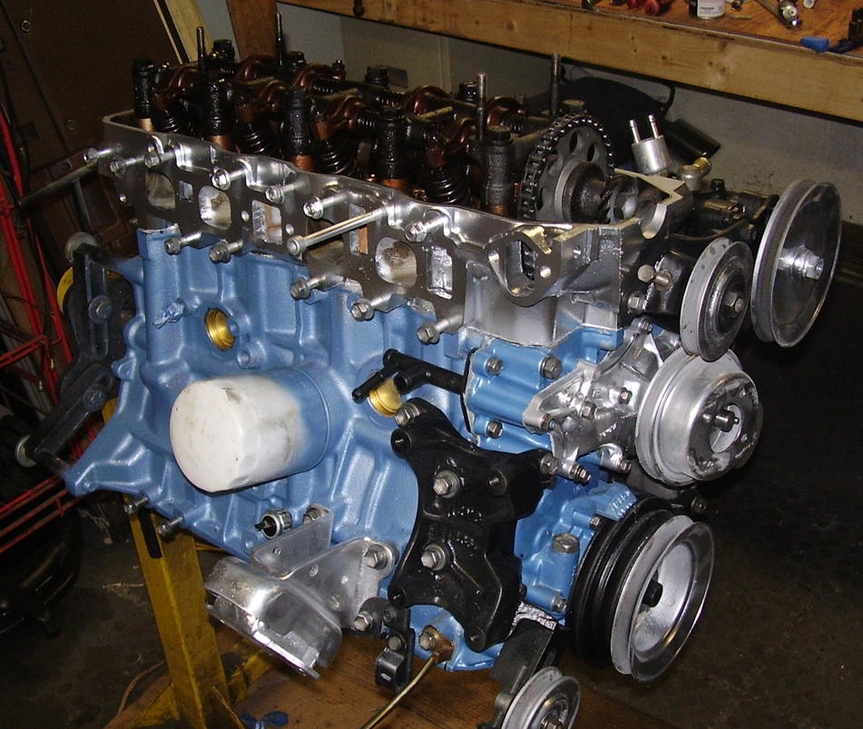

A few engine pics:cool:

Your motor just told me that it wants an LCE header, 268 cam, a big bore throttle body and a performance head! :)
