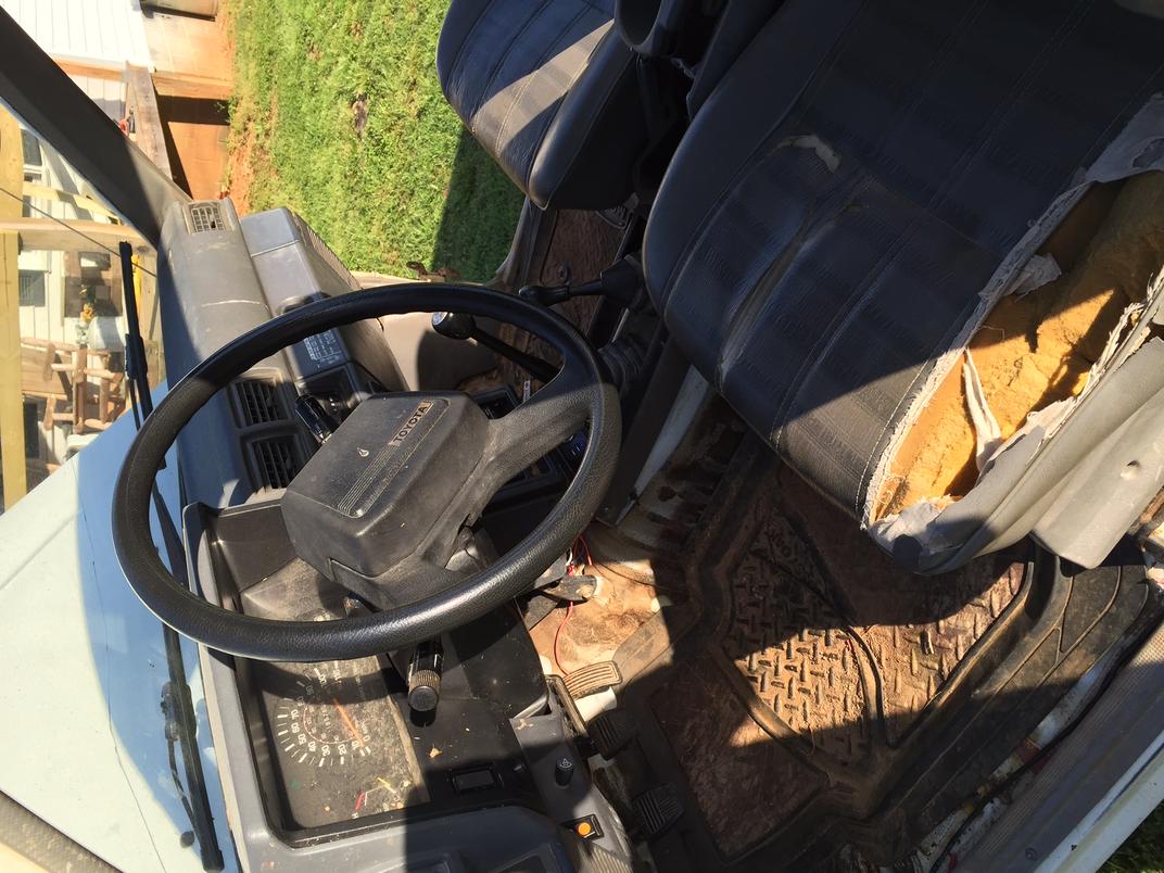

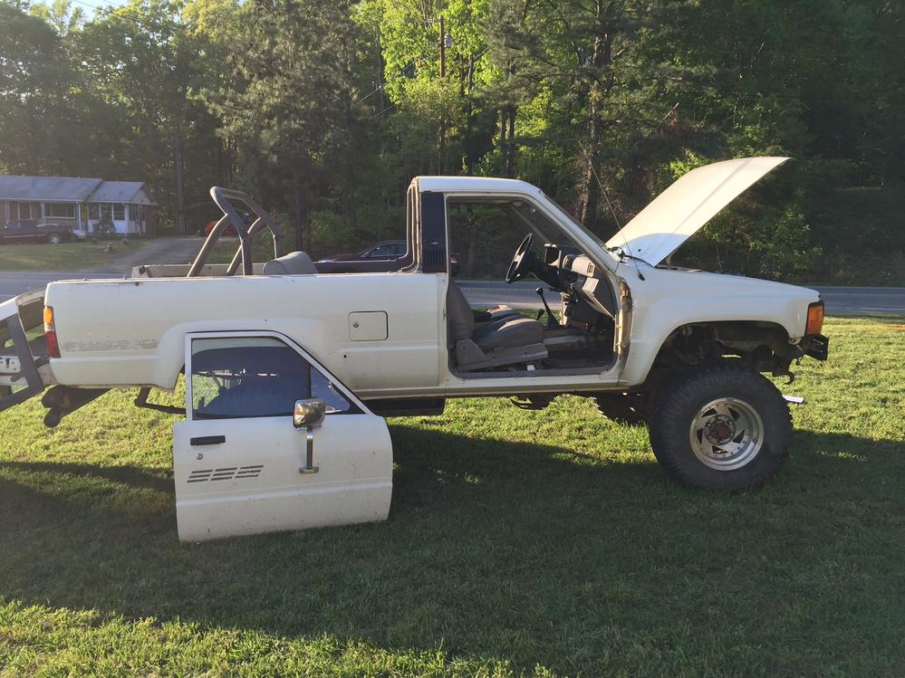

Thanks for the response. I am confident I could do it myself after reading up on it and purchasing a few specifics. Im not paying 2k for it though...i will try and post up pics of it if I can attach them somehow, have to call him back in about 4 hours

right on, these vehicles can be very reliable. so fix things as they come you'll learn a lot along the way
personally i'd want something a little better condition but heck if you can get it at a cheapo price and its near by, clean her up throw a clutch in and drive it
