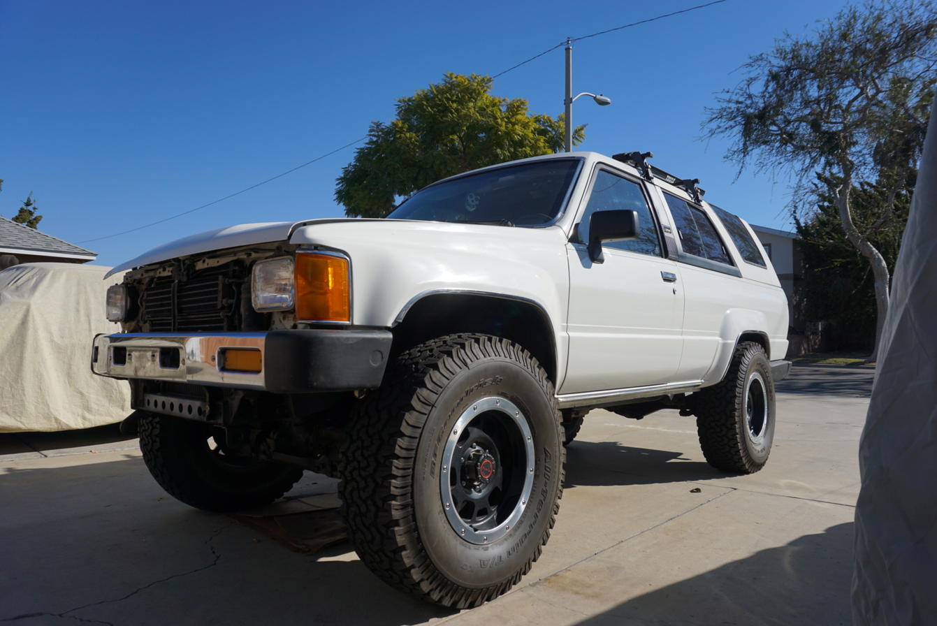

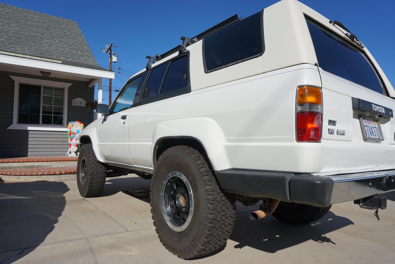

Ok so it's a rainy day down here in SoCal so I figured I'd update the thread. I have pretty much got everything dialed on the 4R and have been driving it around town and enjoying it. I still need to do a few things here and there like trim the fenders a bit more and some other odd ball stuff before I take her out for a shake down run. Here are some pictures of how she sits currently.
