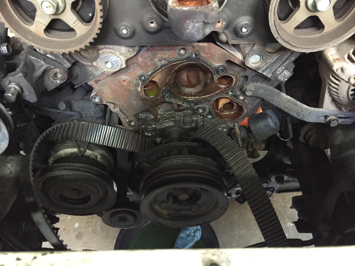

Well kinda a small set back with the ol' first gen. The other day I noticed when warming her up there was a slight knock/tick under the hood. After doing some searching/listening and feeling I could tell it was in the timing belt area. So today I tore her down to find a few things I didn't like. After some thinking I am now in the process of doing the full timing belt-water pump- hoses and a few other things. I'm also going to do my best to degrees the motor and find the one very small leak I have. Parts are on the way and should have a update tomorrow
