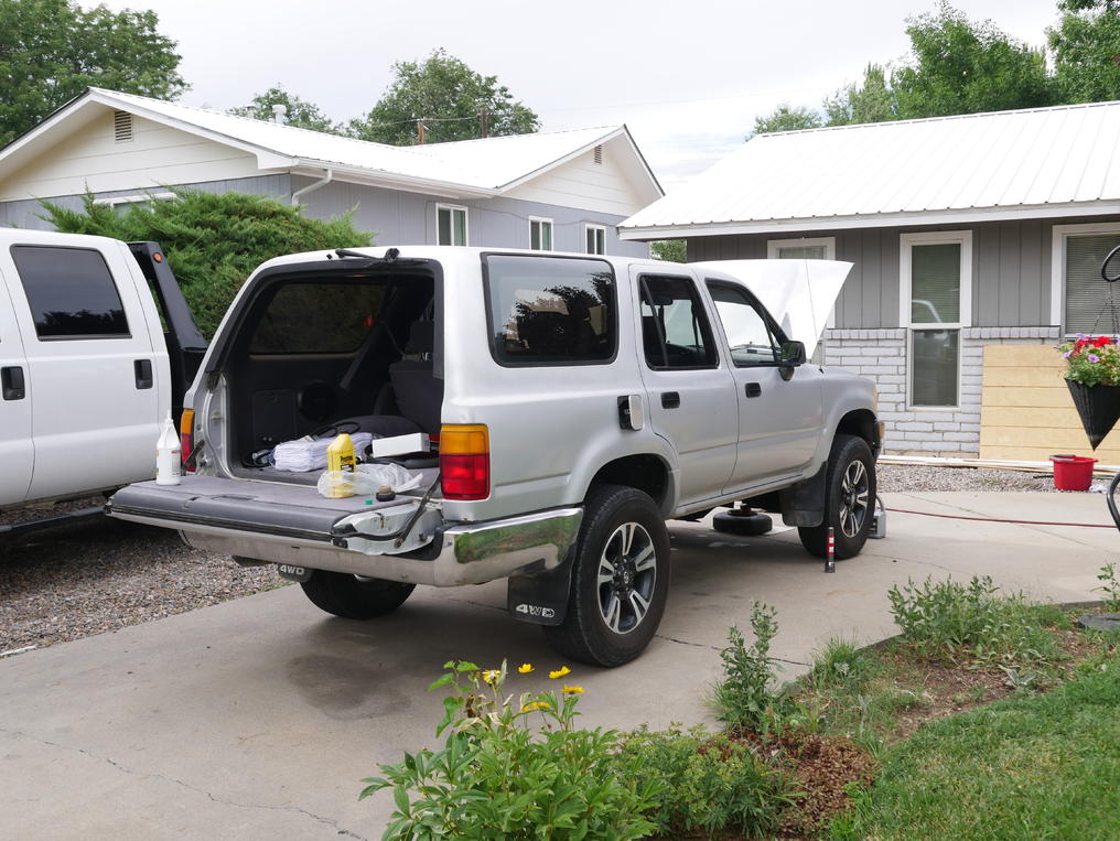

So I bought a junked gold runner and it has a rear tube bumber so i will take off my rear bumper tonight

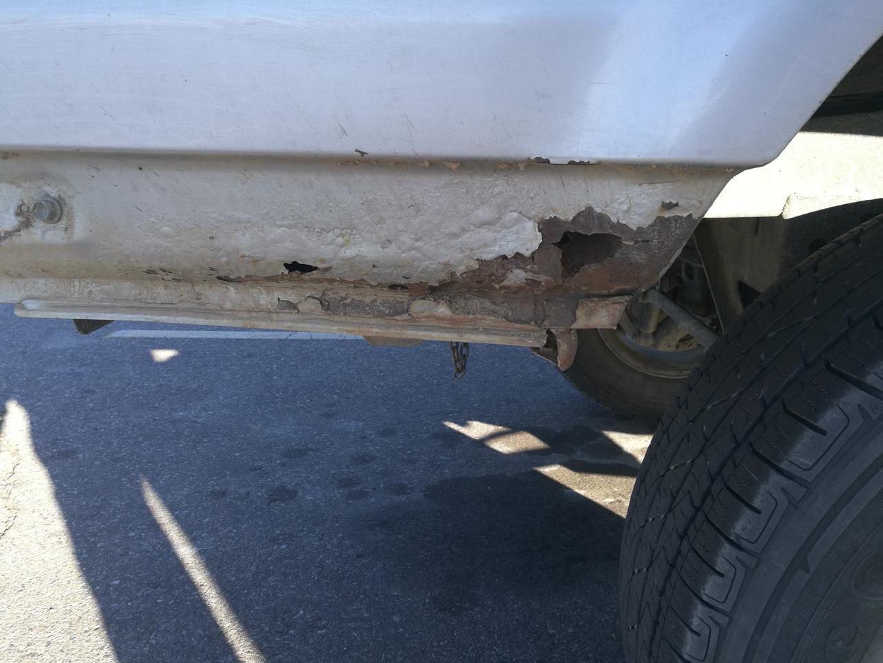

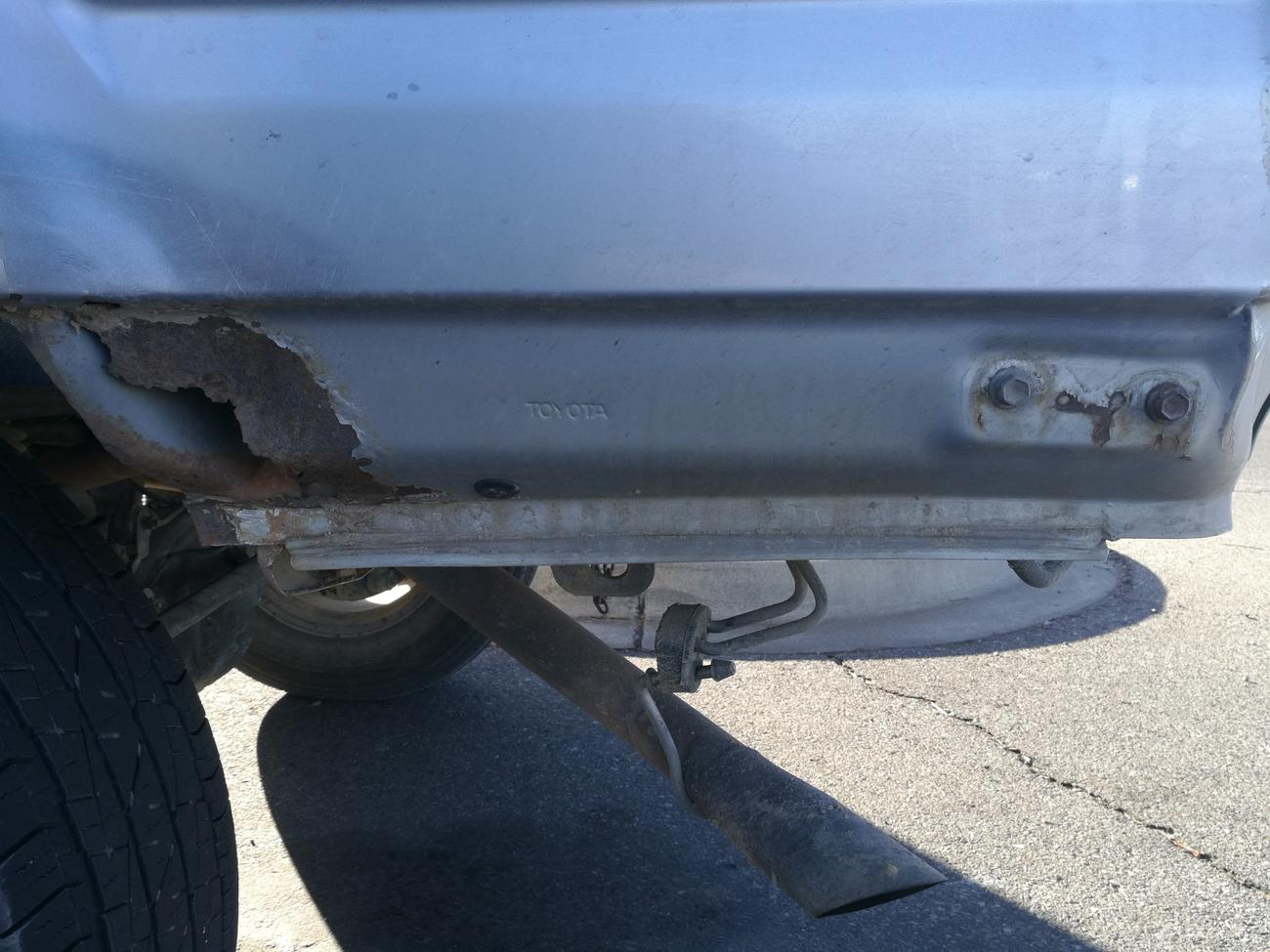

So my once rust free runner is no longer rust free. I took off the bumper and there is a little bit of rust where the bumpers covering. The gold runner has rust free panels so I will have to cut them off it and put them on the silver runner. I don't know how to do body work but I will learn as I go. Have to wait till next paycheck to get everything I need.

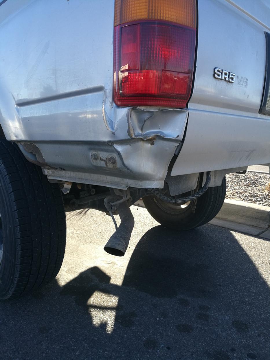

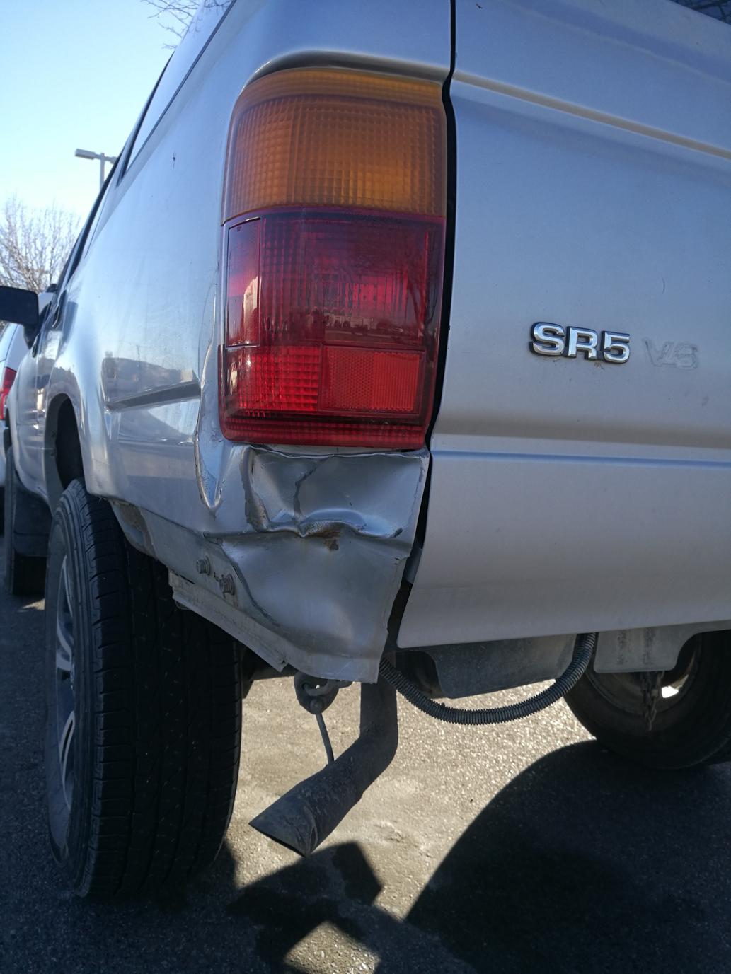

What should I do about the rust??I don't think im going to take it off the gold runner, because I think im going to fix it up. I was thinking about just cutting it out and welding a piece of sheet metal over it.The bumper would cover it up anyways.Has anyone done that before? also I got a little crazy when crawling and slid into a rock therefore breaking my light and denting up my rear qp. #Shouldofhadoffraodtires
I'd kill the rust and maybe weld a panel there. Cover it in some bedliner spray and you should be fine.
As for the dent, do you think it would be easy to unbend or should I take it to a body shop?
I mean depends on how much you know and how much you wanna do. That dent is pretty creased. The bumper would cover most of it. At the very least, I'd just scuff the paint and spray bed liner on to prevent rust. Unless you are running tube bumpers, that should mostly be covered.
I whacked above the taillight real bad and I wish I knew how to cut/weld a panel out because thats what I should've done.

Honest I think im going to try to pull it out. It wont look good but at least it wont be dented inward. At least your panel isn't dented anymore. I don't think it looks to bad. Its actually pretty good.

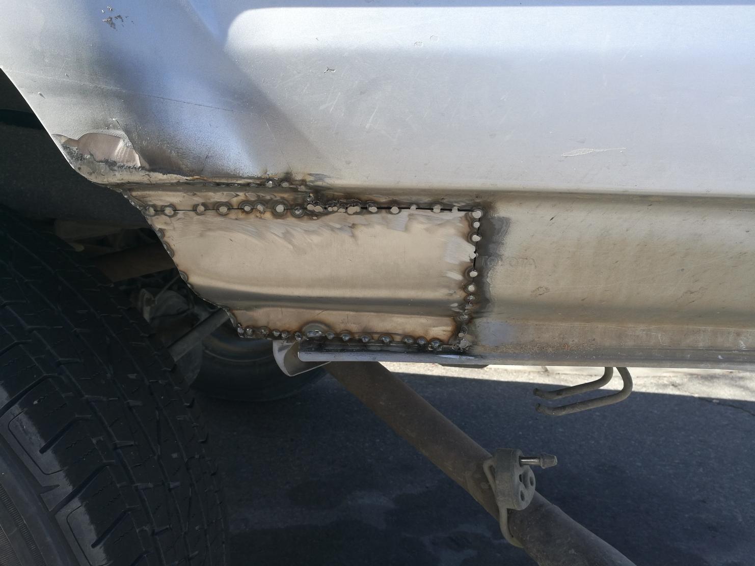

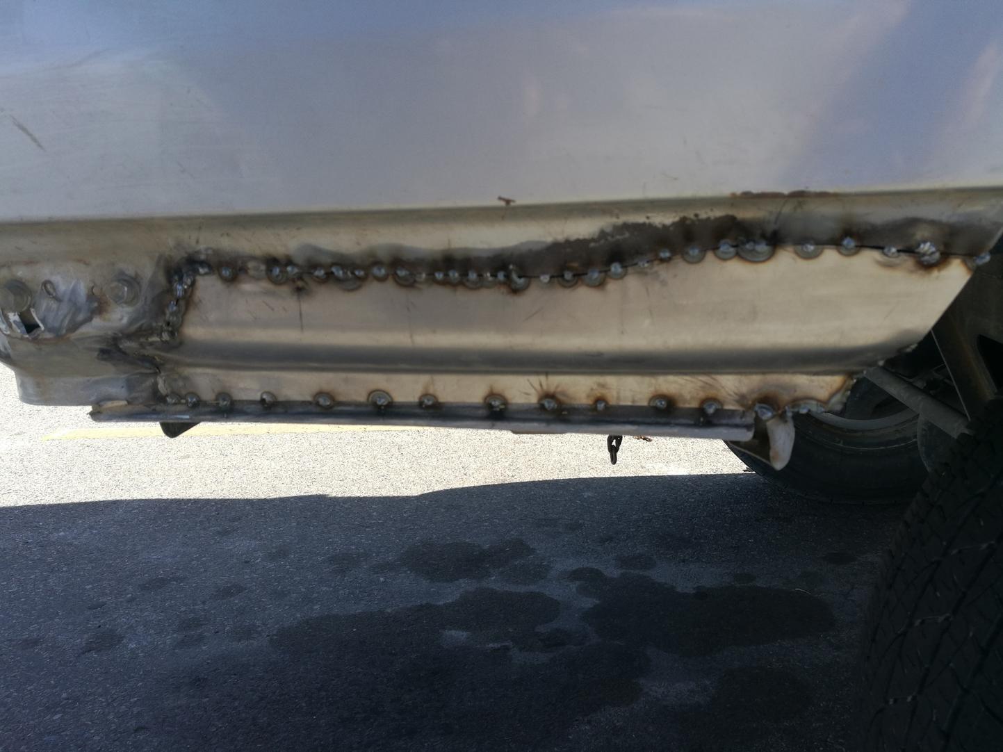

So me and my step dad started it on Friday. We cut out the rust, cleaned the inside of the quarter panel, and primed the inside of panel. The tricky part was making the body lines. I was originally going to put a flat piece of metal there but my step dad convivced me that it would look better if we formed it. We got everything tacked up and we were going to finish it the next day. I got sick and was un able to finish it. I will have to wait until my stepdad is ready again then it will be done. this is what it looks like as of now.

Im finally done with the rear qp and they look alright. Nothing professional but the rust is gone. Right after I was done with the rust I accidentally back into a small pole denting in the whole lower part of the back latch. So we welded a little piece of metal to it and ratchet the dent out, doesn't look good but the widow rolls down. Also I replaced my knock sensor and pigtail. It was a pain in the a**. But in the process I found out that my timing belt tensioner was seized and would not move and that I needed a new belt and idler bearing. But when we first took the timing cover off the idler bearing spun freely. It had no tension. We didn't think anything of it till we buttoned it back up and tried to start it and it was making a thump and backfiring. We took the timing cover off and though out the process of changing my knock sensor the timing slipped and was now a quarter turn off of its mark and that's when we ran into the seized bearing. lucky the tensioner on my spare runner was working so we swapped it in while we wait on parts. we re buttoned her up and she started right up. The only bad thing is that I now have a code 21. Not sure what code that is but ill find out... almost forgot I got a new 4wd sensor switch so now my 4wd light isn't on anymore. two dash lights done just the check engine to worry about now.
