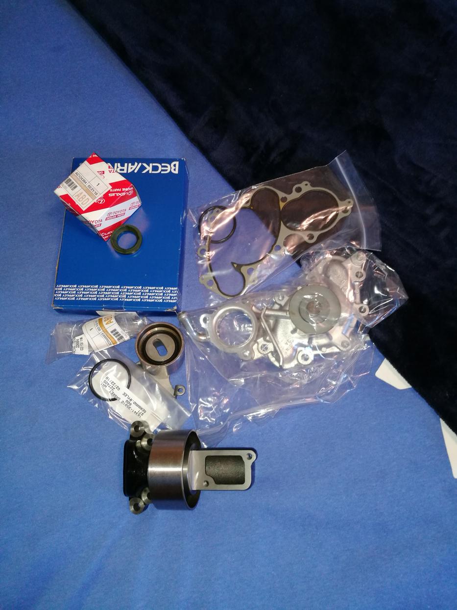

Ordered timing belt, tensioner, idler bearing, and tensioner spring. $350.00 down the drain... But at least she will run for another 100,000 miles. I forgot to add that I replaced the broken injector and bought the LCE short shifter.

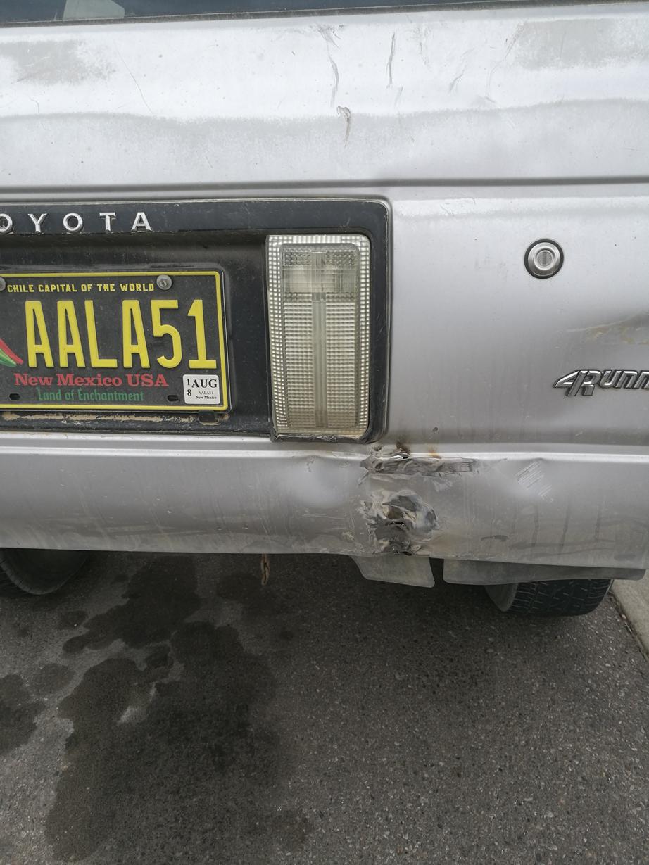

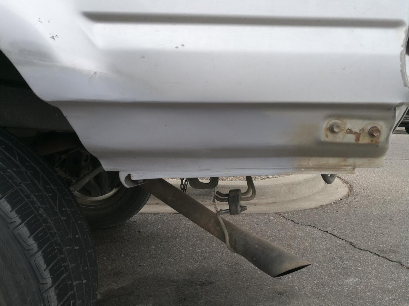

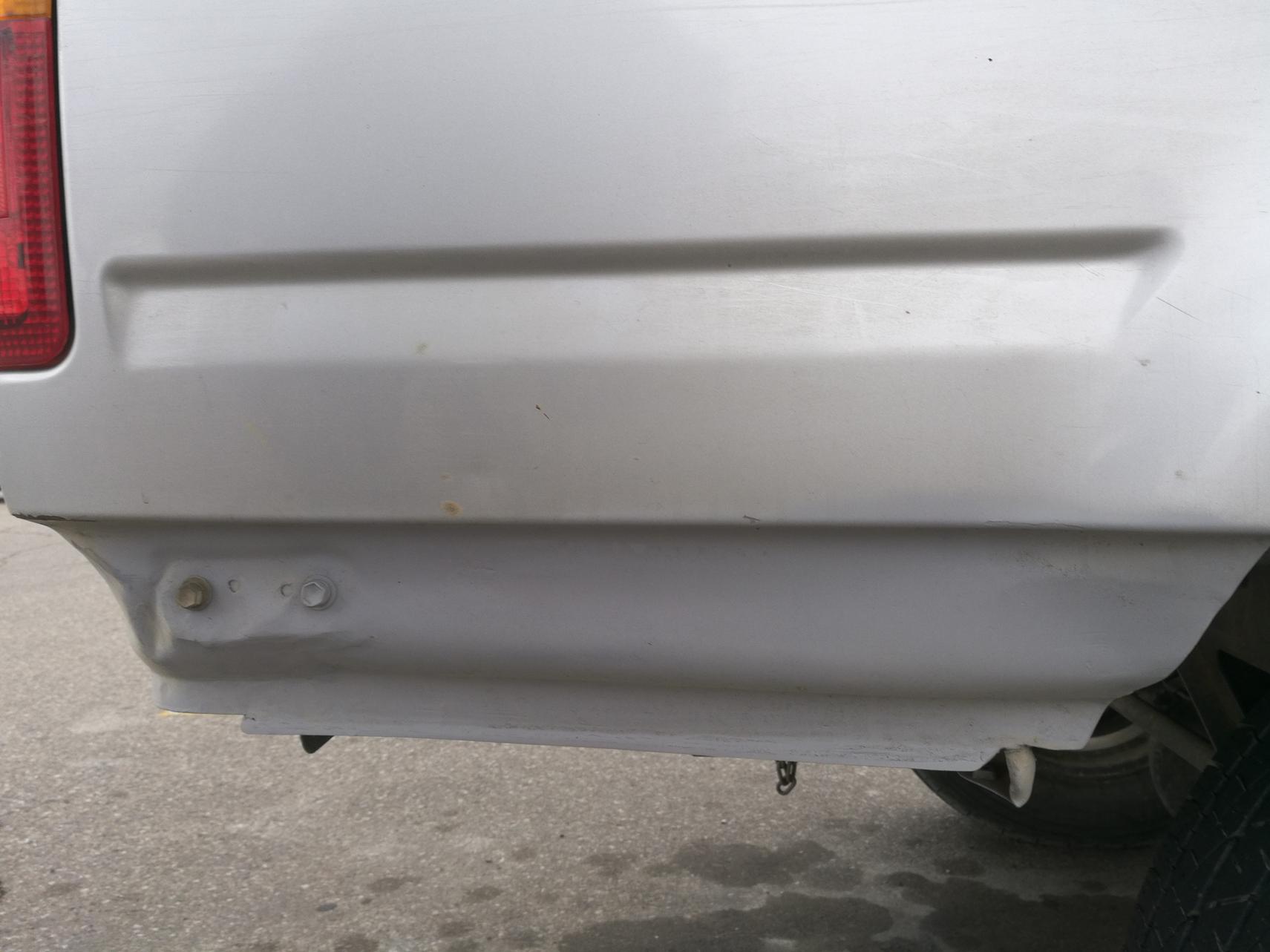

Sorry I meant to post these with the post yesterday but got busy. Anyways here they are. The body work isn't the best but theres no rust and its sealed up.I also waiting to get a new tail gate until I get a bumper. Im saving for a nice plate bumper. Does anyone have any suggestions on brands or designs?

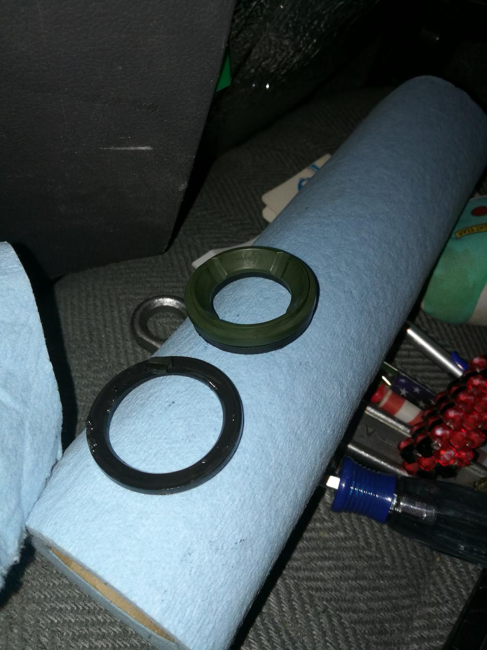

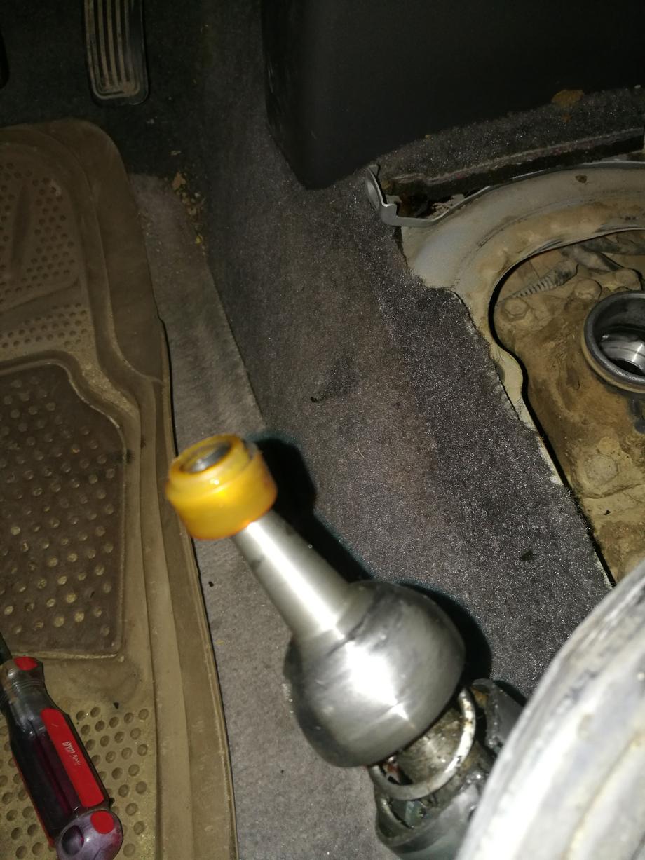

So I noticed my shifting was getting a little crunchy. I could hardly get it into reverse or 5th.I saw a thread on yotatech about replacing the shifter seat and cap. I ordered the shifter seat and cap it was only like 10$ from Toyota. I was surprised on how good it shifted after I saw the bushing that was in there. After I replaced the seat and cap :love: it was amazing. It is nice and tight and shifts really smooth.
the first pic is of the old and new seat. The one in the front was the one that I pulled out. There was none of green rubber left.As for the cap it was pretty worn to.

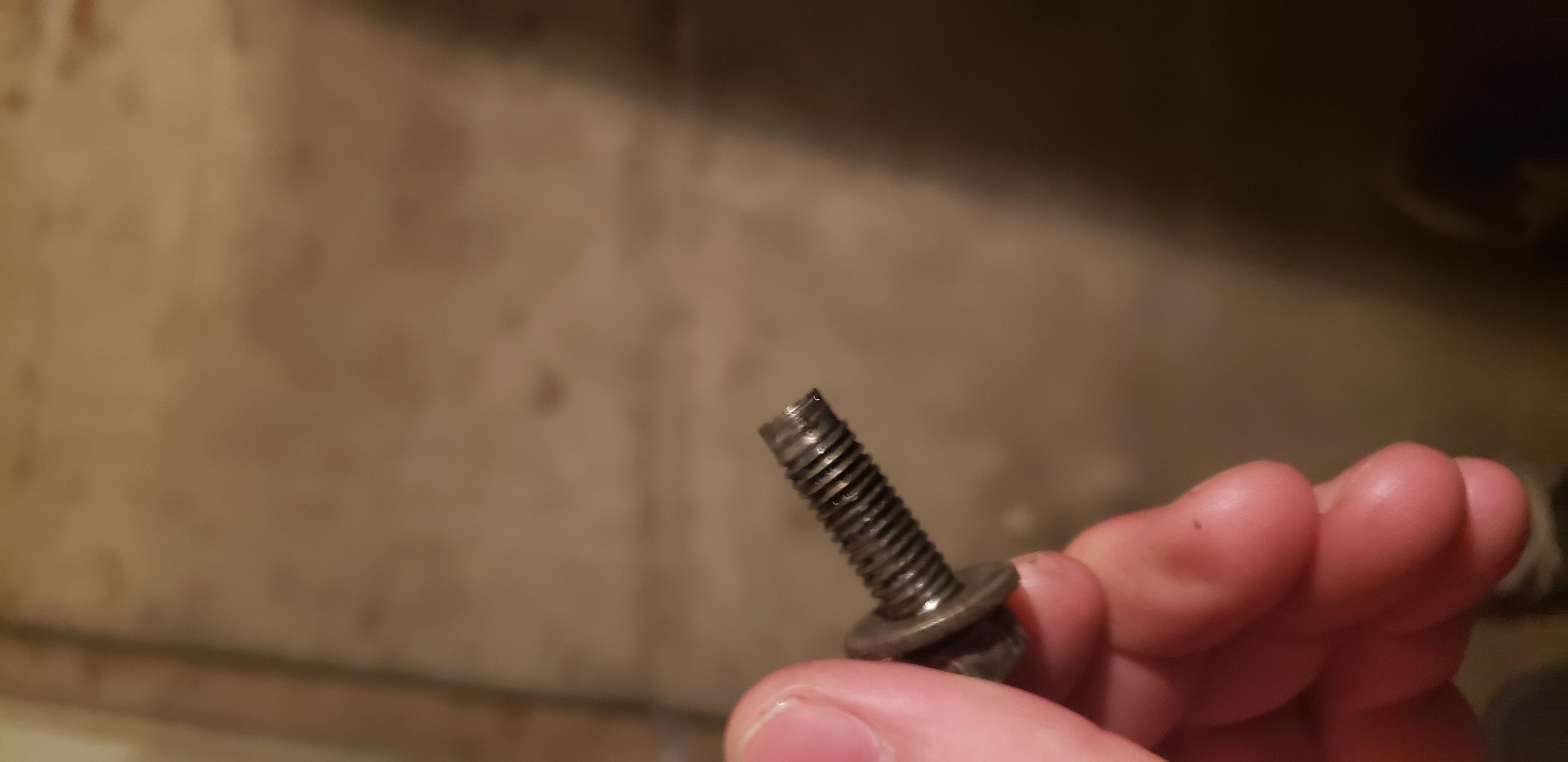

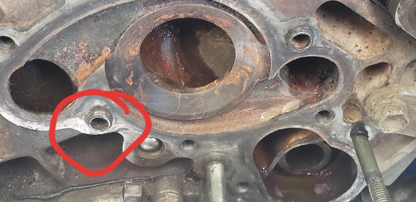

So I haven't posted her for awhile. My 4runner was resting while I got some time to work on her. I started my timing belt and it seems the one of the bolt holes for the water pump is stripped out. What could I do to fix it do I have to re tapp it or is there a little sleeve I could get? Any help is appreciated
