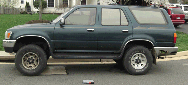

Bought this 2nd Gen. project 4Runner on April 3, 2008.
4WD SR5 V6
Additional work
To get this truck in running order I had to:
1. Replace all belts.
2. Replace the oil cooler gaskets to fix a terrible oil leak.
3. Fixed the speed sensor cable. The cable and sensor assembly will eventually be replaced.
4. Waiting for part to arrive to replace an outter CV joint boot. (Any advice on inspecting/cleaning before installing the new boot is appreciated.)<br/><span style="font-weight:bold; color:red;">... After further inspection, looks like I'll need to replace all CV boots. Arrrggg...</span>
As a side note:

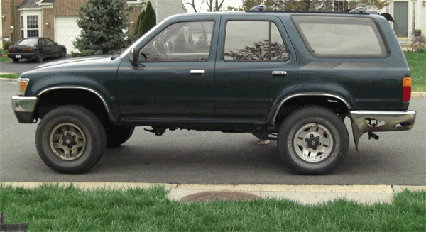

>>The running boards have been removed.
>>As it has become rusted and beyond repair all spare tire assembly from the under carriage has been removed.
On the agenda, is to fix the sagging rear end. The coil springs arrived on Friday but I will wait until I decide on a set of shock absorbers before starting this project.

Congrats on the purchase. I have a 1994 4Runner as well in the same color! Looks like you have a lot of your hands to work with. I still have to figure out why I am leaking power steering fluid. Reading a couple different posts on here it seems to be a common issue. :bash:
Haha, that was the first thing I noticed was the squat. I need to fix that on my own T4R. When I get the time, I've got no money. When I've got money, I've got no time. :bash:

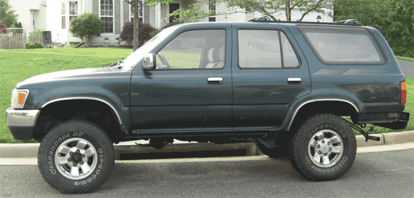

Ok Folks! I replaced the springs and shocks yesterday. I don't see any difference in the squat. I'm a little disappointed in the MOOG Springs. When I compared them with the originals they were much shorter but a much thicker spring. I was thinking that the original springs were being compress beyond the height of the MOOG spring, so I continued with the replacement job. Let me know what you think. I also removed the rusted out rear bumpers. Also, replace the rims with a set of 97 Tacoma rims.

Truck is starting to look good. I was going to replace the springs in my 95. When started to do the work I noticed the new springs were way shorter than the stock. I returned to the store and said to hang with it for now.
EVENING OUT THE FRONT AND REAR SUSPENSION
If you compare the photos it looks like you've brought the back end up a bit but not level with the front end.
It may be that a previous owner cranked up the torsino bars.
You could probably even it out by uncranking the torsion bars. When I bought my 4runner 4cyl the front was sitting way up and I lowered it by uncranking the torsion bars.
As a side note I noticed that the ride quality and cornering improved after I lowered the front a bit.

Maybe its the shocks, or maybe its the bumper being gone... but it does APPEAR to be less of a squat than your previous pics. Did you happen to measure the distance between the axl and the stop bumpers before and after the spring swap?

I heard that LC80 rear springs are natually taller and stronger. I don't know the details but heard people install them on 4Rs.
Might want to explore this idea.
I'm thinking of doing that myself along with cranking my torsion bars
