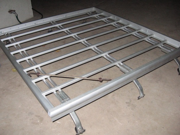

I'm pretty possitive you can build your own rack and more. Of course it depends on if you have some experience working with metal.
I made this rack for my sedan with alluminum, for the most parts it's riveted, but most crucial parts I had a guy weld them, there are just a few of welds. Because the bars go front to rear, the rack doesn't make sound and seems to brake the vehicle a lot less than when the bars go side-to-side.
The whole deal was about 100 buck for me (which is a lot here).
Now I'm planning to build one for my 4R, probably using steel pipes, I have a little tube bender.
