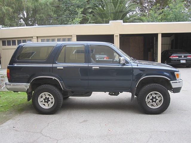

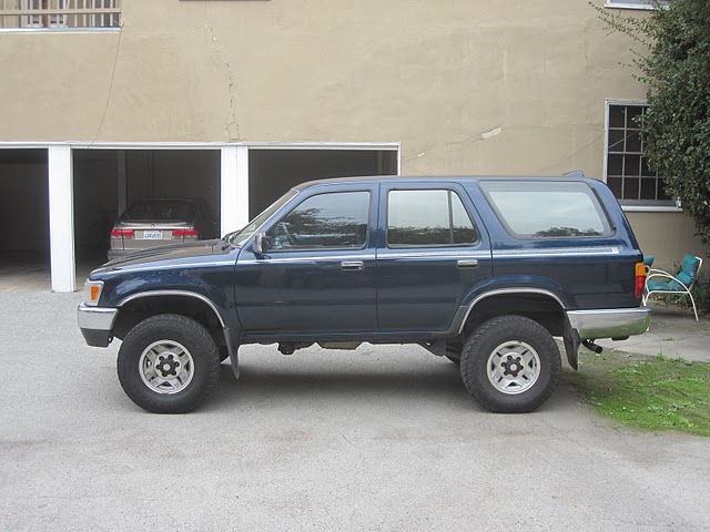

So I spent all Saturday installing these new HD OME springs.
They are installed and the ride is nice! The vehicle is much more responsive and feels like it accelerates quicker (from full stop)
My first thought after removing the jackstands and hydraulic jack was DAMN THAT IS SOME LIFT (see photos)
Picasa Web Albums - Ian
The rear end is lifted nicely now but it's definitely higher than the front. I can't fully decide how I feel about the new look. Do you guys think it looks ok with the rear being higher than the front? Do you even notice? Is it a more aggressive look, or just silly?
I havent yet adjust the torsion bars, but may do that based on the feedback I get here.
My other thought is now my tires look so small! Lol, maybe I need larger tires now?!
All feedback is appreciated.
You can see all photos here : Picasa Web Albums - Ian - 4Runner OME
looks great
I think your truck looks awesome, bigger tires would be a great idea for sure. I'm making my 4th gen look more 2nd gen, streamlining it. haha, keep up the good work.

the rear seems to have settled a bit since the original installation

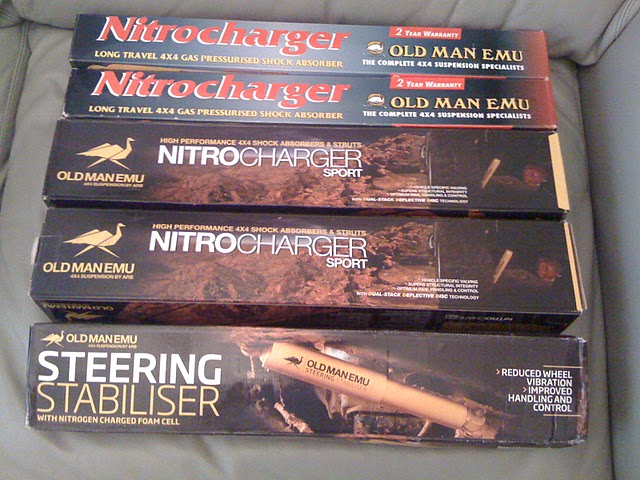

Just finished purchasing the ARB Old Man Emu (OME) setup for my rig.
Already had installed the rear springs a few months back. Just now purchased the front and rear shocks, as well as the steering dampener/stabilizer.
So excited to get this all installed!

F/R shocks arrived today!
F/R shocks and steering dampener / stabilizer arrived. can't wait to install!
