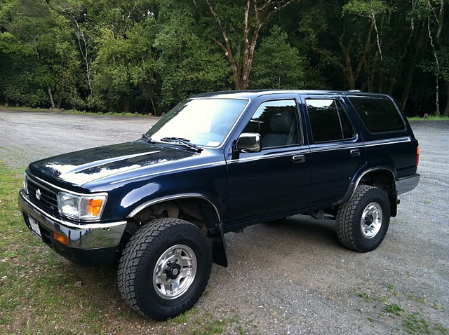

1995 4Runner - Just installed HD Old Man Emu OME springs...thought? (with photos)
Looks good
It looks good! So good, I just ordered a set of coils myself! = D thanks for the pics, I was concerned the 2" lift wont be enough to match the front but it's actually got higher, thats even better. Can't you adjust the torsion bar to increase lift a bit?
congrats! and yes, you can adjust the torsion bars to get lift in the front...I just havent gotten around to it yet. I kind of like the hight difference. also, the F and R have evened out a bit since the springs have been installed for a few months now.
I'll most likely leave the front torsion bars alone until I get around to replacing them with the OME torsion bars, which I have yet to order.

Did you get everything installed yet? Wondering how the ride is with the new suspension. I'm thinking about ordering everything you did, but can't decide on the med or hd springs.

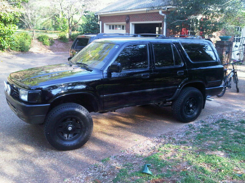

hey i have a question i use my 4runner for a daily drive and was gonna order new rear coils like you did i have a saggy butt too...should i go with the med or hd? going to order them tonight thanks!
also if i wanted to lift the front a little can i just order the ome front shocks? im new to lifting department if you could help me id appreciate it! here is pick of mine:thanks:
yes, everything is installed now! I went with the HD springs - mainly for when my car is fully loaded with people and gear (camping trips). The ride is definitely stiff, though.
I'd be curious to hear the opinion of someone who went with the med, but I feel like everyone on this forum talks about the HD. Either way, I'm happy with my current setup!
i went with the HD springs. I think the med are fine unless you ever fully load up your 4runner with gear and people for trips (camping, etc). HD is also preferred, probably, if you ever tow. but for strictly a daily driver, I'd imagine med is fine. if you are unsure though, i'd default to HD since most of the folks (from what I can tell) on this forum who use OME use HD.
as far as your front suspension question, front shocks wont change the lift at all. you'd need to crank up the factory torsion bars (not recommended by most folks on this forum, but I suggest you read up on that yourself), or install ball-join spacers (BJ spacers). As far as front suspension tweaks, I have only installed the shocks.

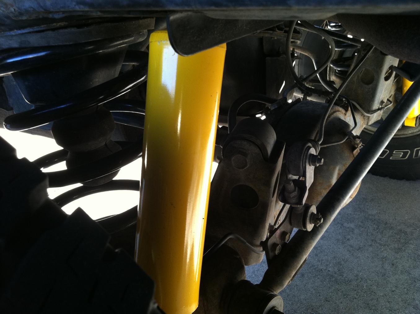

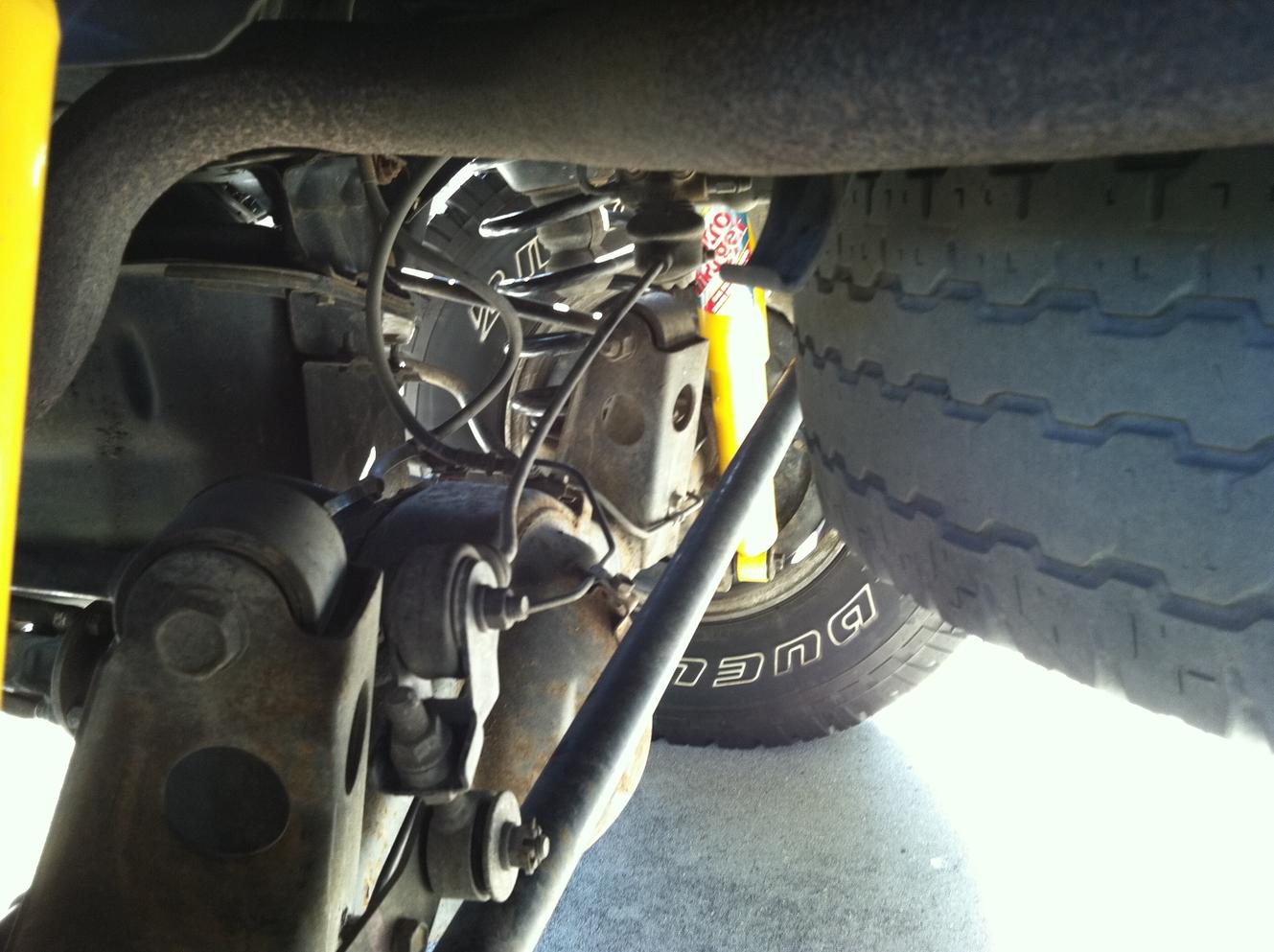

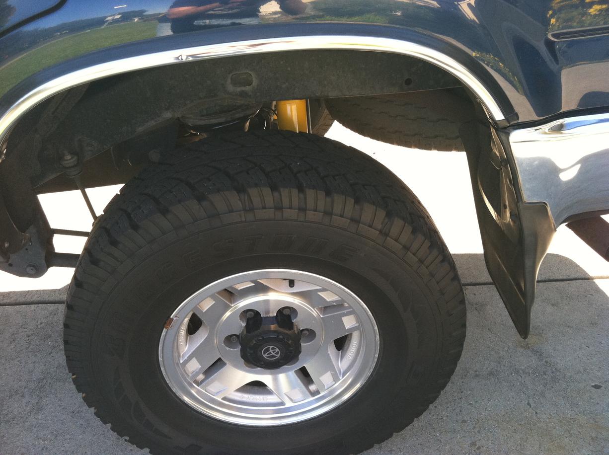

install pics

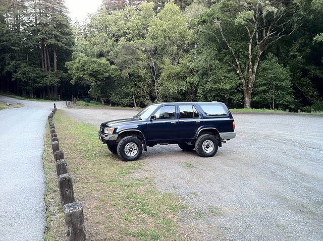

recent pics - taken @ Huddart Park in Woodside, CA
Great looking 2nd Gen!
Clean and uncluttered look which I like.
What size tires are you running on those last two pics?

It looks like the front has been lifted as well, did you touch the T-bars?
And as the previous poster asked, what size tires?
