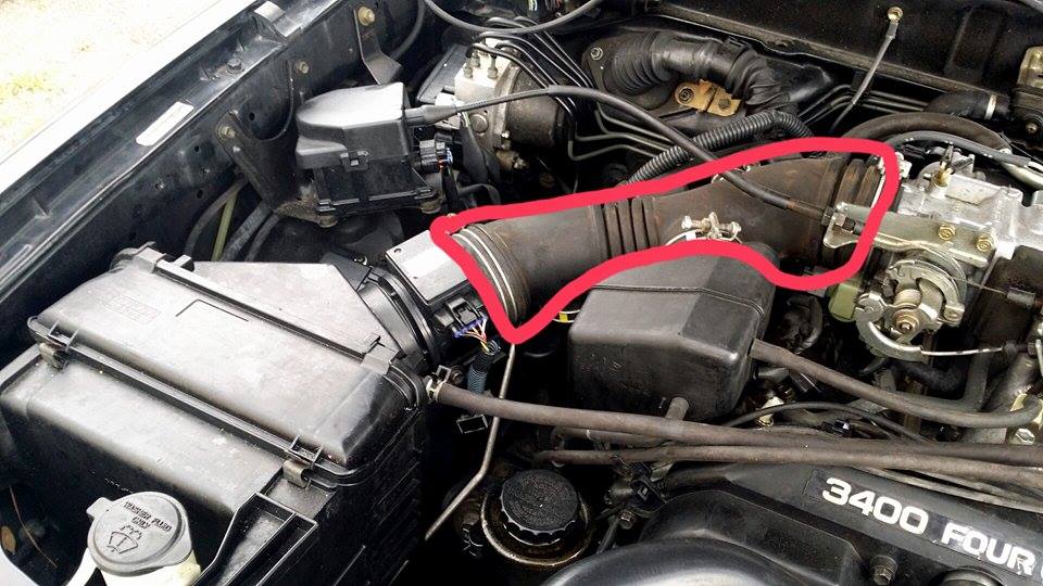

Check engine light just turned on so I got it checked out and it's an Emissions Code.. all other hoses look good. Was looking at the CAI and it needs to be replaced soon. Looking to stay OEM. Anyone have any leads on where to look or anyone have one laying around that they want to sale or give away??
The junk yards in my city on have 1995 4runners and under.. No 1996-2002 are available. So no luck there..

What code are you getting exactly? Try camelback toyota parts for the intake tube if ya need one.
I couldnt tell you.. i was in a rush. I usually take it to Oreillys and they print it out for me but i just had the guy check it and i left at a friends shop. Just wanted to make sure it wasnt severe.

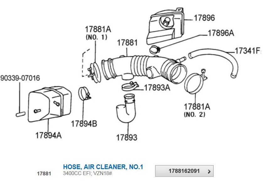

Is the item unavailable from Toyota dealers? 17881-62091, a bit over $90 at many places online. I believe the item was used through the '99 model year.
Well I called the toyota in my city and they said it was discontinued. Is 17881-62091 a phone number?? The Hose is can be from 1996-2002, is that what you were referring to on the " '99 model year" ??
1788162091 is the toyota part number for a 96-98 air intake hose. It seems that the 96-98 intake hose is one piece with the resonator installed on the side of the hose. The 99-2002 has two hoses with a resonator installed in series. I just bought the air raid intake tube and like it lots. I wasn't expecting any power gains, just wanted a cleaner look under the hood and to clear out some space, the stock resonator is big and bulky. The tube seems to be of good quality, and i didnt buy the kit with the filter.... i like oem filters more than aftermarkets.
Here's a pair of screen captures, merged together, that show how I got the information. At the web site I viewed, I had to use the diagrams for a 1997 4Runner because that site's page for the 1996 model was somewhat incomplete. I don't know why. That same site shows different looking pieces and part numbers on the 1998 and subsequent model years.
