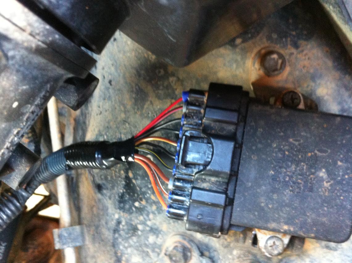

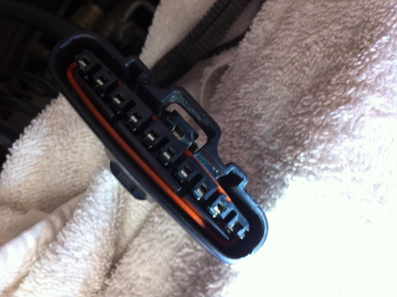

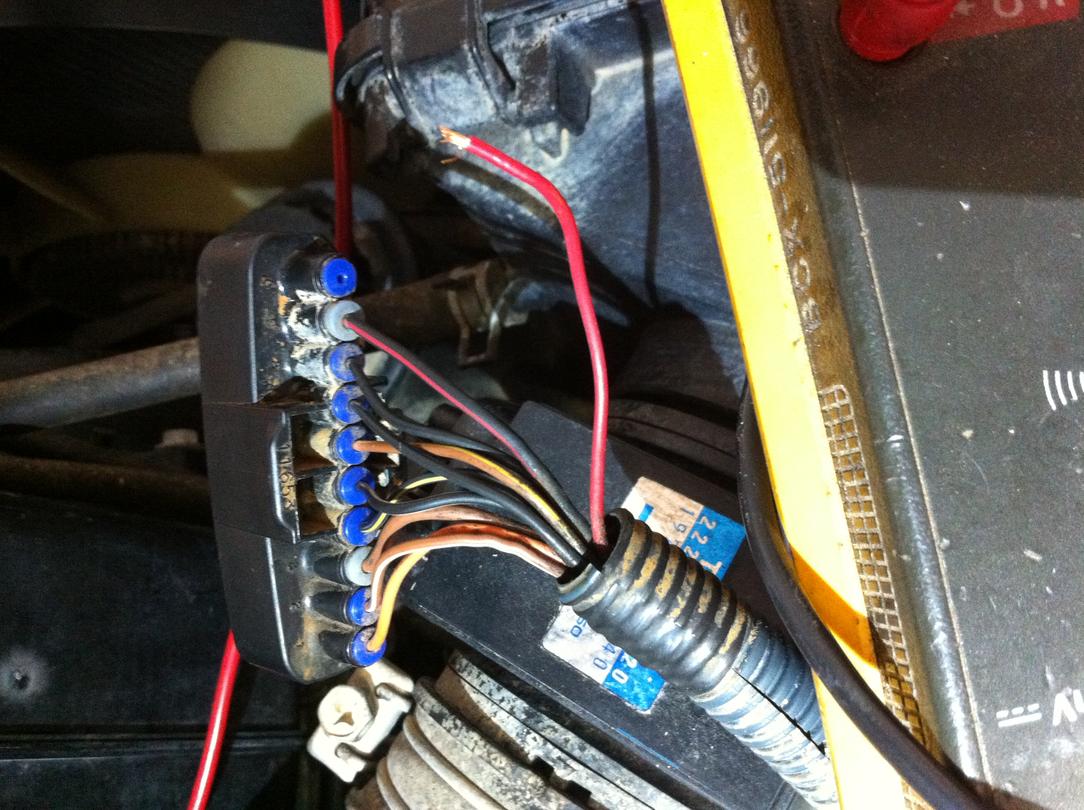

OMG! Ever have one of those days / nights when nothing goes right and then you finally have an "Ah-Ha!" moment? That was an hour ago for me!
So I kept looking at the igniter module thinking something must be wrong with it. I decided to start tracing the wires down. I gently started pulling the plug out and the red wire came completely out of the plug!
After I pulled the connector apart, I soldered the wire in place and completed the repair. Works like a champ again!
So in summary, water somewhere caused it to misfire, me putting in new plugs to solve that problem most likely put some tension on the red wire that was probably on it's last strand anyway, and hours of frustration later it's running again!
