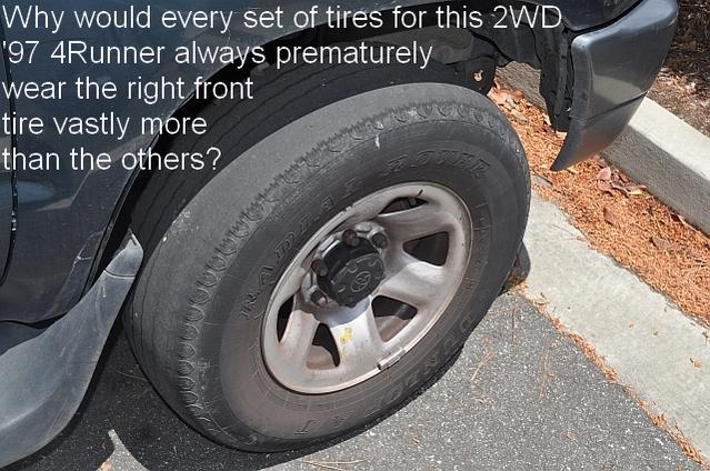

The last two sets of front right tires wore out prematurely (mostly the right front tire tread was worn off the outside few inches).
Since the wear was non-cupped, I was told a year ago it wasn't the shocks so I had an alignment done each time I replaced the front tires.
But, the wear continues, mostly on the right front tire (outside edges mostly).
This time, when I had the tires replaced, I asked the mechanic what could cause just one tire to wear so much. He said my front right shock was 'blown'. He showed me grease running down the shock which wasn't on the other front side.

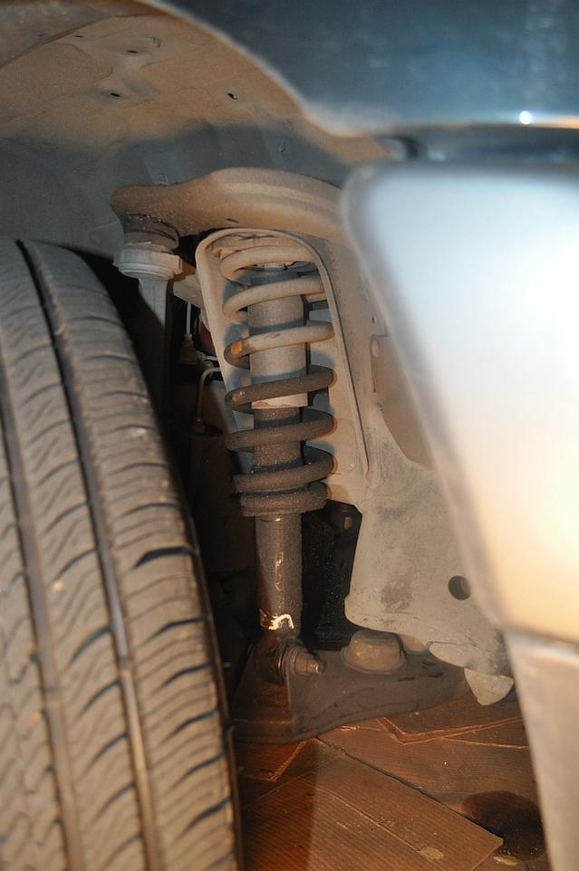

Just go with tokico.It is the OEM shock and functions just fine. As far as your tire wear. Sure , it looks worn on the outside but your tire is also worn all the way across too. Bad shocks would produce a cupping affect on the tires. your tires look smooth and no cups.
You tires look worn out. Maybe making a lot of left turns.
Get an Alignment and have them check you tie rods and ball joints for wear. Replace what is needed and have it re-aligned.
Yes. You are observant. I've waited about 5 months too long to replace all four. They are all new now. But, the front right ALWAYS wore more than the rest. It was an outside edge wear, even after alignments.
You are definitely observant. There are no cups. So, I do agree. Bad shocks would normally cause cupping which I don't have. But, the shock does have leaks all over and it's the original shock from 1997.
I think it's more that I drove on them half a year longer than I should have.
That's good advice. But, I had multiple alignments already.
I'm surprised the 4Runner goes out of alignment that easily.
I do not drive off road ever. I don't drive fast. And, the roads here in California are about as good as anywhere in the country as there are almost no potholes to speak of.

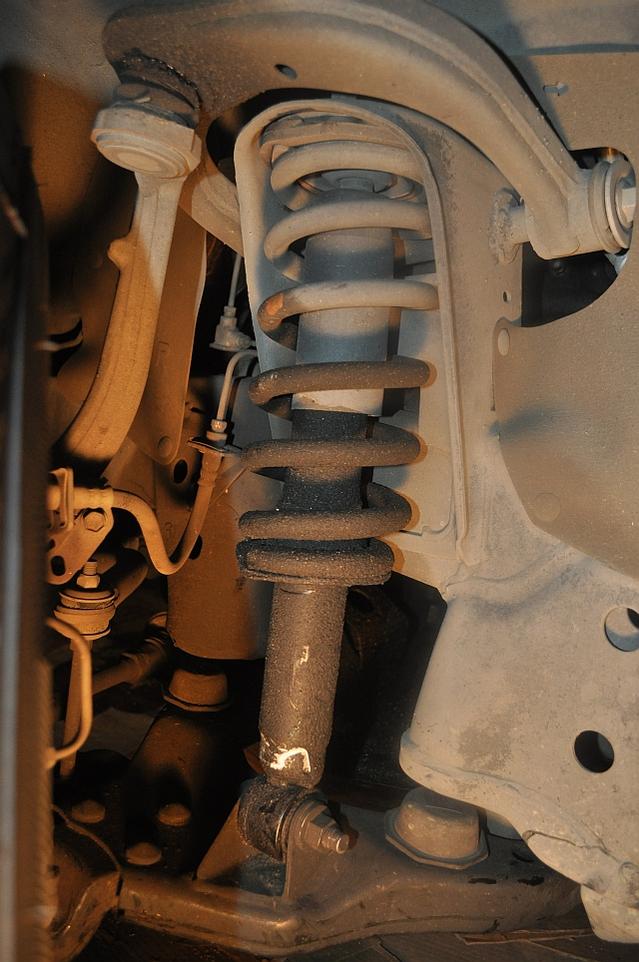

Here is a picture of the leaking strut (I think it's a strut, right ... not a shock)...
If you're not rotating tires much it is possible and normal for the right tire to be more worn. Even though you are in California and have the most perfect roads in America, the issue is that almost all roads have an ever so slight slope to the right. This helps shed rain water off the highway.
Looking at your pictures. You really don't have a problem. If belts were showing, and you had an excessive amount of tread left on the left side of the tire, I would say you have a problem. Coincidentally, How many miles did you get out of that set of tires?
HAHAHAHA
I'm thinking the same thing. While yes there is evident uneven wear, the tread seems to tell me you got the most out of those tires. I bet you if you rotate your tires as much as you're 'suppose to' you would see A LOT less wear like that. Ragardless, if you have a busted front strut then it obviously needs to be fixed. I doubt it has much of a play factor in the uneven tread your getting though.
How often would you rotate these tires?
I'm guessing every 5K miles (or every oil change).
Interesting that the shock isn't the cause of the right-front tire wear. These tires should get at least 50K miles and they didn't get anywhere near that (more like half that) ... so I MUST have something wrong.
Not rotating them must be killing me (taking half the life of the tire)?

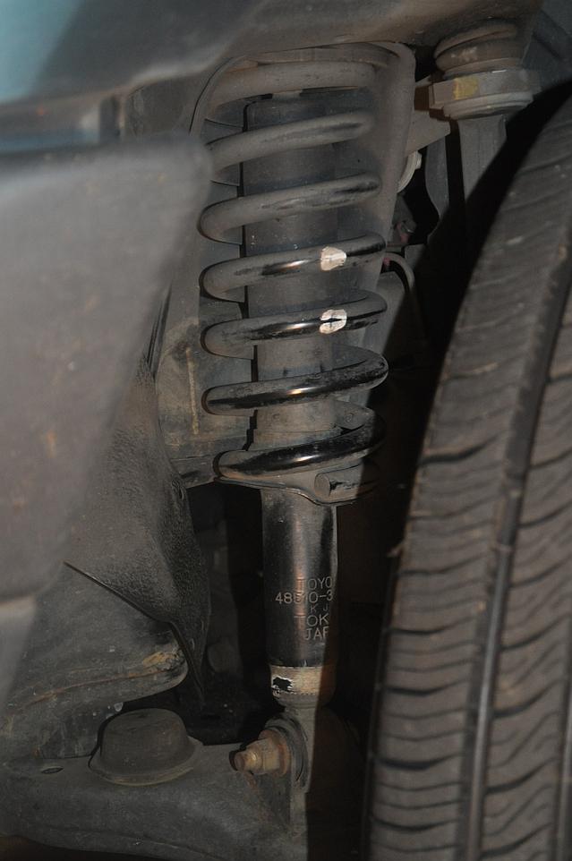

BTW, here is a picture of the left front original strut (you can see "Toyota" and "Tokico" stamped on the strut, along with a partial part number it seems).
And, below that is a picture of the right front strut (it seems to be leaking but I never noticed a difference in driving).
Yep, That strut has seen better days. Another issue that you might have is that your spring seams to be sagging a lot. Just looking at the bump stops, it definitely varies from one side to the other. You Probably have a bad spring too.
You will need to replace them in pairs but new struts and springs will fix your excessive wear problem.
Don't forget to get a new alignment after working on the front end.

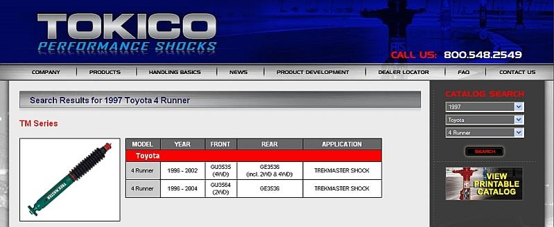

I called Tokico (actually Hitachi) in Los Angeles (800-548-2549) to ask about the following shocks (see pic below) - but I'm still waiting for them to call me back.
With the information about the 'bump stop', does this look like the stuff I need to test for?
  1. Replace both front shocks with OEM equivalents (Tokico GU3564 TREKMASTER SHOCK)
  2. Test spring for sagging (bump stop?)
  3. Test tie rod ends
  4. Test control arm ball joints
  5. Alignment when all done
Are those the tests I need to research to figure out how to perform?

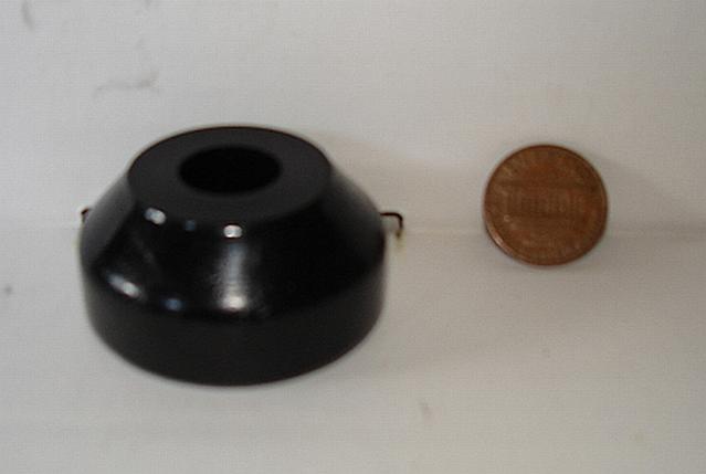

The bump stops are the rubber discs mounted to the lower control arm. You can see them in your pictures on the arm the bottom of each shock is mounted to. They have a hex collar around the bottom.
What he means is that it looks like there is less space between the bumpstop and the frame above it, suggesting that the passenger spring is more compressed than the driver's side. It could just be the angle of the picture though. You should be able to tell by actually looking at them.
You can test the TRE's and ball joints by jacking up a wheel and shaking the wheel for the sides (back and forth) and from the top and bottom. Play in either direction would suggest bad TRE's and ball joints respectively.

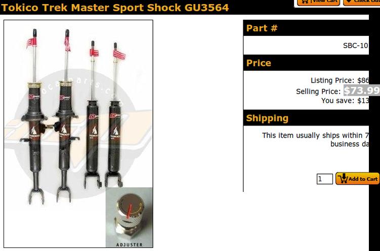

Does this seem to be the right shock to google for?
