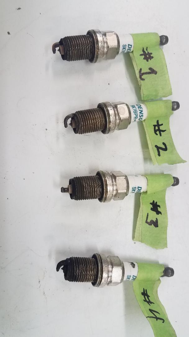

here is a pic of the >40k plugs that were in before the compression check

I have in the past seen a coil test good and still misfire. So like the other suggested swap #4 with another cylinder. If the misfire follows its the coil. If it stays on cylinder 4 it's the plug or the wires that drive the coil. Or the injector on cylinder 4.

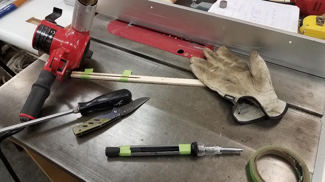

When I bought the noid light set I also bought a spark plug in line tester ($3.99) and modified with a piece of pvc tubing to get it to seat down on the plug. I had also pulled out the parts cannon and bought a set of "house brand" wires as well, I jumped across with the new number 4 plug wire hooked up with the inline test light and started her up, the light was flashing perfectly and the engine seemed to be smooth. I shut it down and replaced the number four plug wire with the new one and pulled out the test light, hooked up the scanner to live data and no more number four misfire, she is smooth as can be. A nice boxing day present, thank you lord.
My guess is that when I checked the 30k mi old wire in the very beginning when I swapped coils (also 30k mi old) it read 16.4 on the meter, fsm reads "under 25k ohms" I did not look to see the scale and if it was 16.4 "K", it may have been M or some other scale idk but I will def be checking the meter on that wire tomorrow :-)
