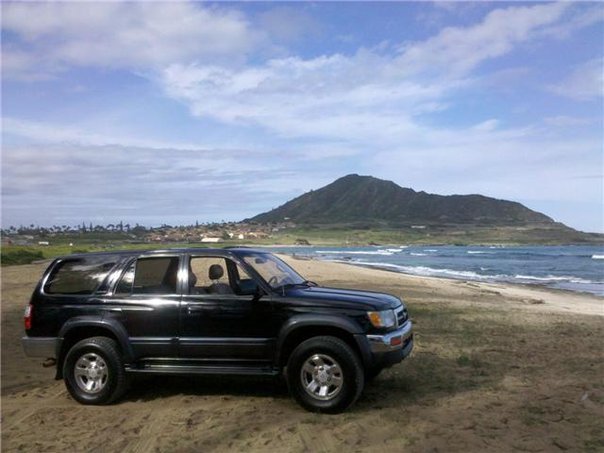

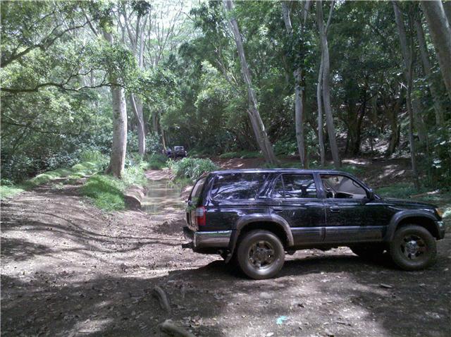

After about a year of owning my 4runner and living in hawaii having a blast with it. I recently moved to NC upon from returning from afghanistan I am now in the process of waiting for everything to finally arrive:

Before: And...After!!! Voila!

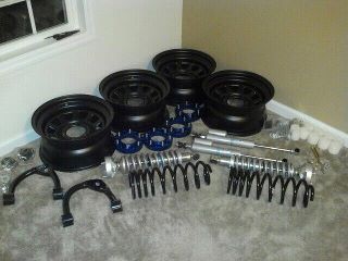

All the lift parts came in today. Gotta go pick up the 4runner in Norfolk Va this week and should start ripping it apart after thanksgiving. I cant wait! I have stalked this site, YT, pirate, and many more drooling over build threads for a year and a half. I am still shopping around for tires and front/rear bumper options in the mean time.
