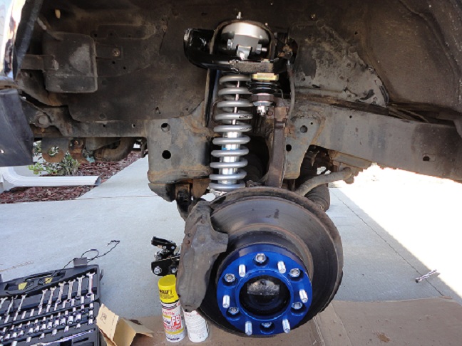

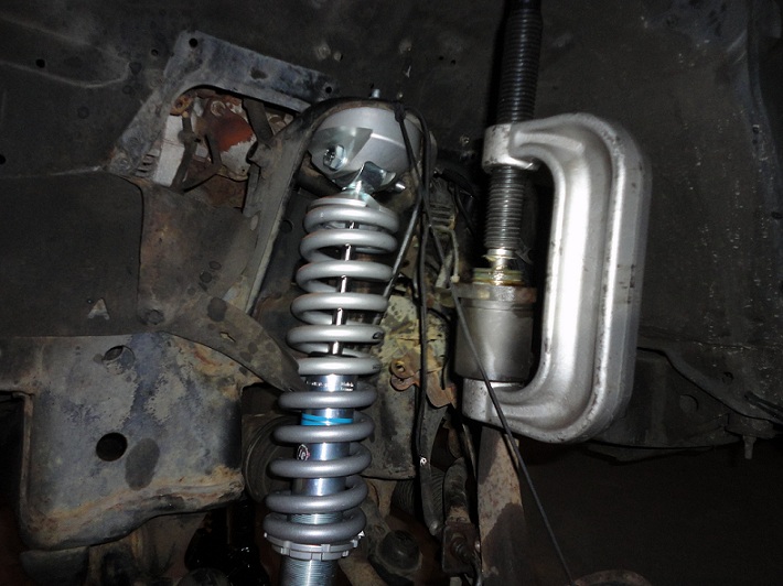

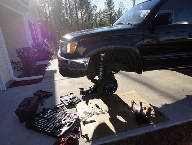

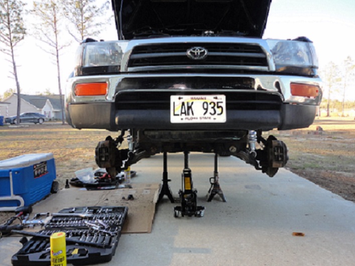

Ok so today I got a late start. I went and got my wheels and tires mounted and balanced. I started digging into the drivers side and found the original coilover only had two of the three mount nuts installed, and one was only slightly tighter than hand tight...fml. I removed the factory upper control arm and had to go get an actual Ball Joint press because my puller wasnt cutting it...after renting one from autozone I get home and gave a shot at pushing out the upper ball joint with is a total PITA! I soaked it with PBlaster and cranked the press as hard as i could, I am letting it sit overnight with tension on it and I'll heat the mount area in the morning :flamethrwoer2: and hope it pops with a few whacks of a big arse hammer!

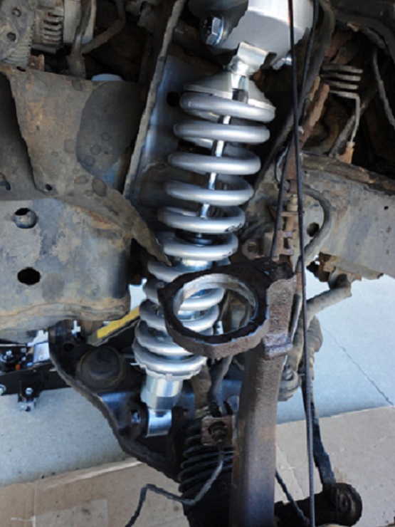

Stock ball joint and upper control arm removed, used a ball joint press kit from AdvanceAutoparts and it worked really well with a 3ft breaker bar. ready for cleaning and install.

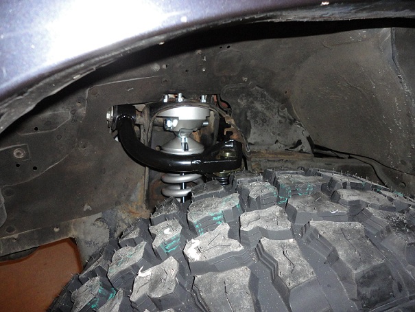

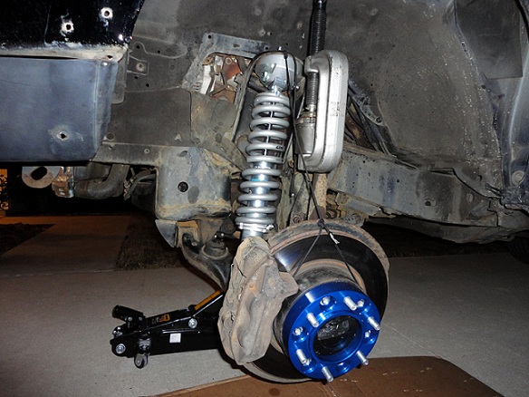

Close up of coilover and light racing UCA. Front end is completely done and starting the rearend tomorrow morning. 2"inch body lift getting installed on Sunday. I should be on the road and getting an alignment by monday morning. Not too shabby of time from start to completion seeing how I am doing this all myself. :guitar3:

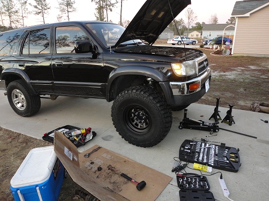

running 315's I am more than likely going to have to break out my trusty ol sawzall this weekend too and make some trimming adjustment and also hammer the pinch welds flush. After alignment I plan on maybe re-gearing to 5.29's for front and rear thirds...$$$$$$

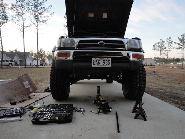

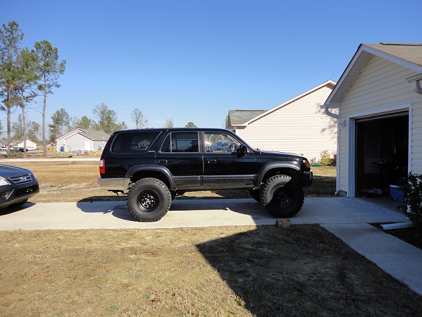

Just finished up the rear today, wanted to start the body lift but had to go grab an xmas tree. Still need to take it for a lap around the neighborhood and adjust the front coilovers but overall I am loving the 35's. :banana:

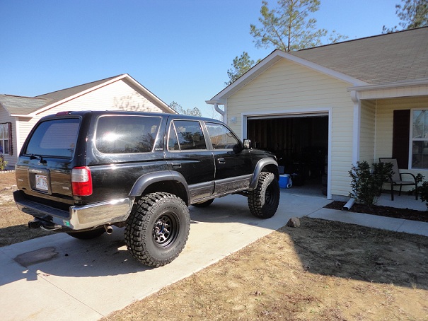

Side shot of how it fits so far. Gotta get my 4xinnovations sliders welded on once my dad comes to visit if he brings his welder over.

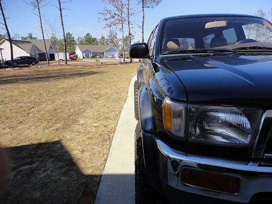

I am really pleased about how much the limited fenders cover the new tires still. I was worried a bit about how it would turn out with 1 1/4 wheel spacers and 315/75r16 tires on those rims..
