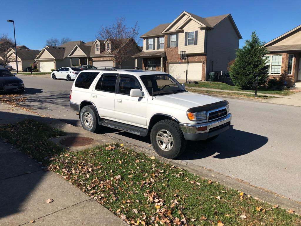

Just picked up a ‘98 SR5 auto to use as a utility vehicle for camping, casual off roading, and dog duty. I will also be taking it out to CO for almost a month in Feb to ski bum around while taking advantage of working remotely. Here’s how it looked when I got it.
I’m pretty sure it was the cheapest driveable 3rd gen for sale within a few hundred miles. It needed a lot of mechanical work, but the exterior and frame are in great shape. Valve cover leak was causing smoke to come out of the hood and the trans had to be manually shifted into 1st, among a bunch of other things. Like I said, it was cheap and had 271k miles. Despite all this, it made the 2 hour trek home no problem - definitely couldn’t do that with an Audi.

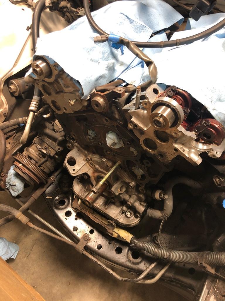

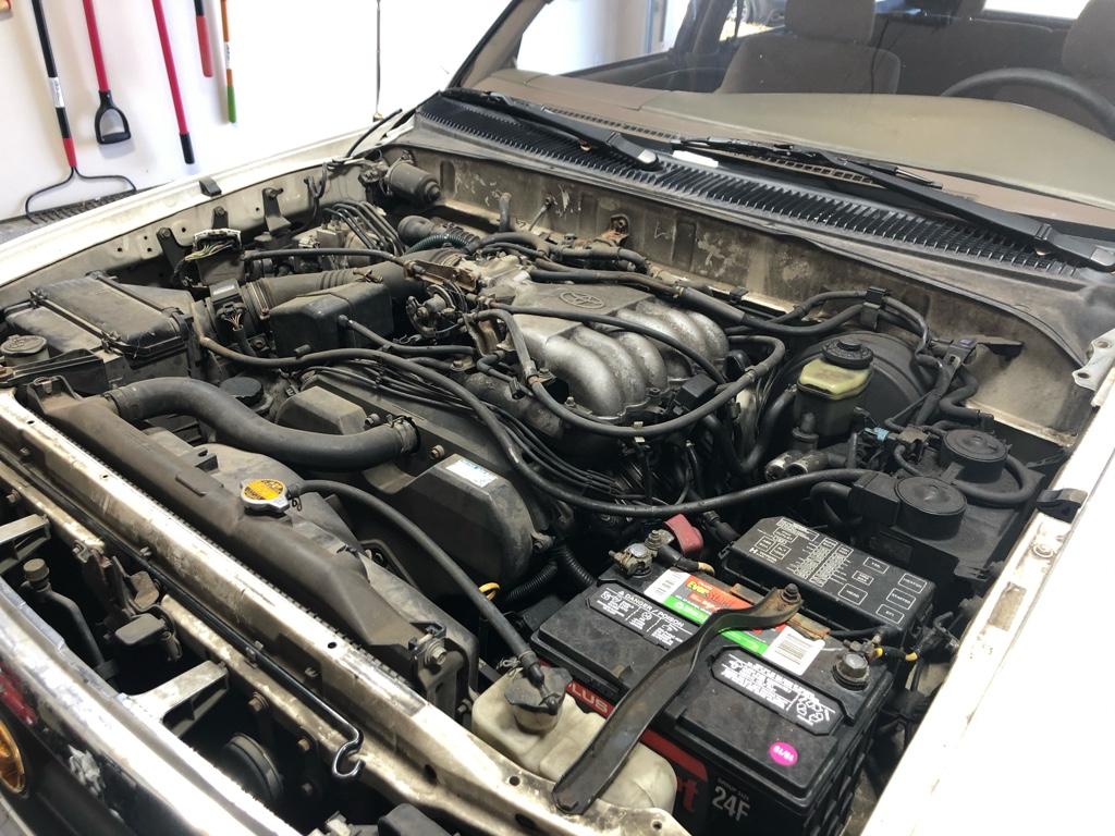

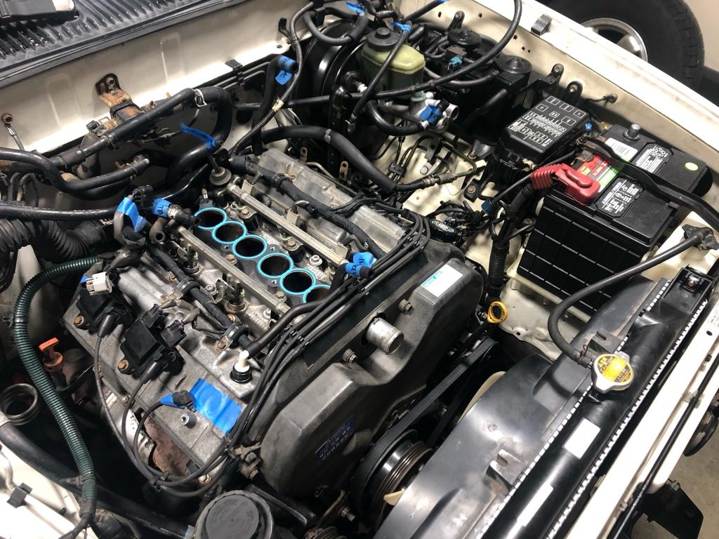

Then the much needed maintenance started. Started off with timing belt and valve covers, pcv, spark plugs, along with a ton of cleaning. It was a nice change of pace to only need 10, 12, and 14mm sockets for most things. The FSM is a great resource.
Evidence of a coolant leak at some point and active dipstick leak.

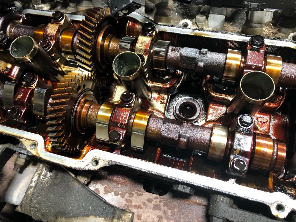

Heads looked ok for the mileage.

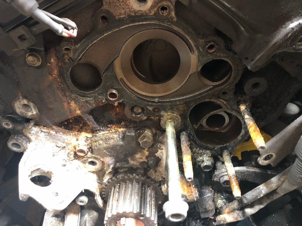

Crank and cam seals done.

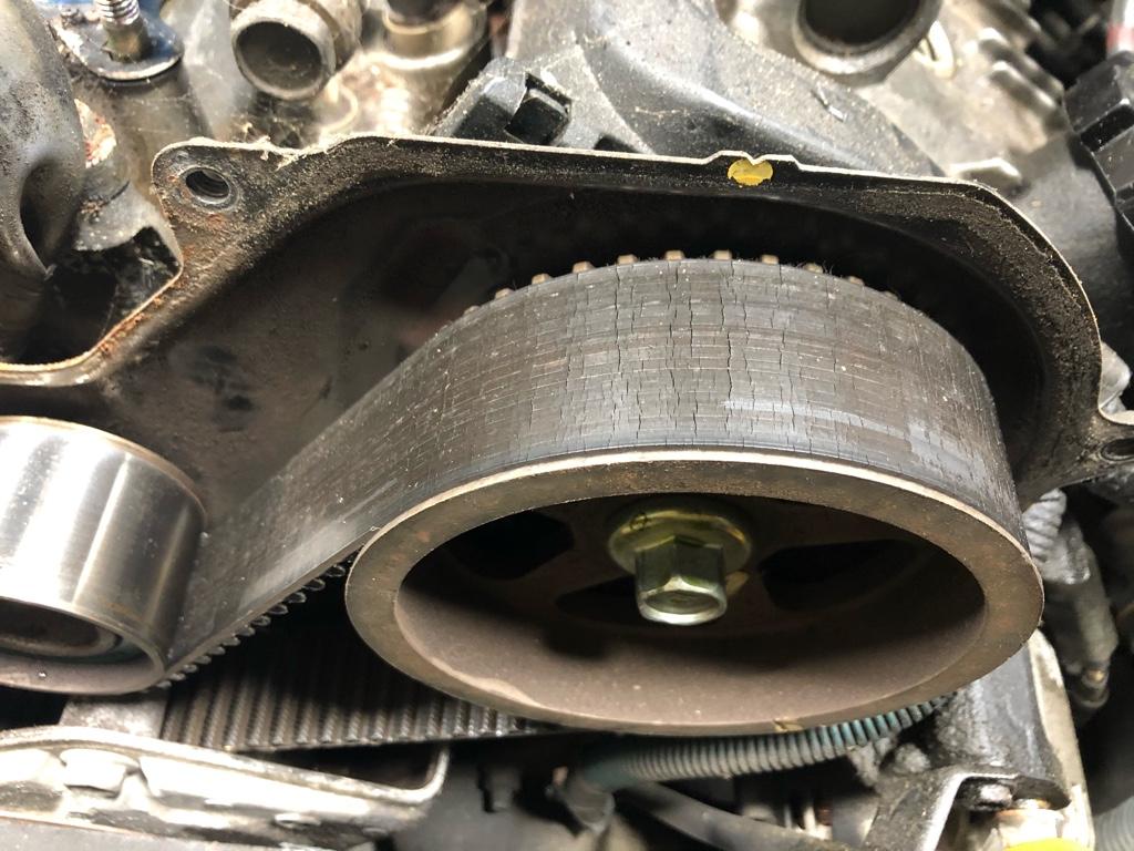

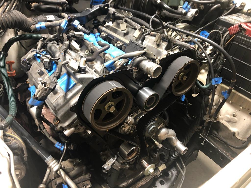

New timing belt installed and covers back on. I almost never have to use my in-lb torque wrench, but it came in clutch throughout this project.

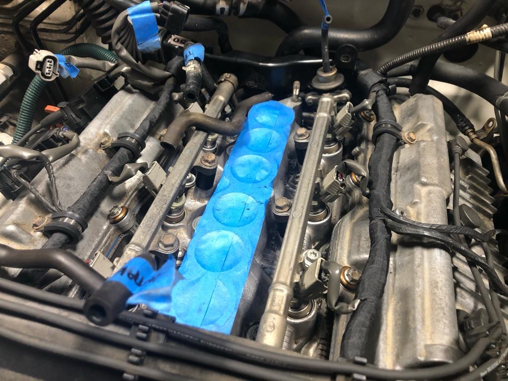

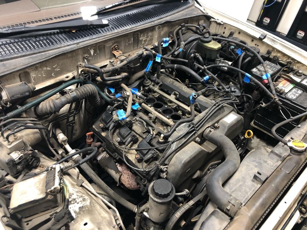

Coming back together much cleaner. Sent out the injectors for cleaning as well. Mr. Injector said one was on its way out so I installed an OEM refurb one.
Broke off the brittle wire harness plastic and replaced it with euro style tesa tape leftover from an Audi job. This allowed much more flexibility to maneuver the driver side valve cover back into place too.

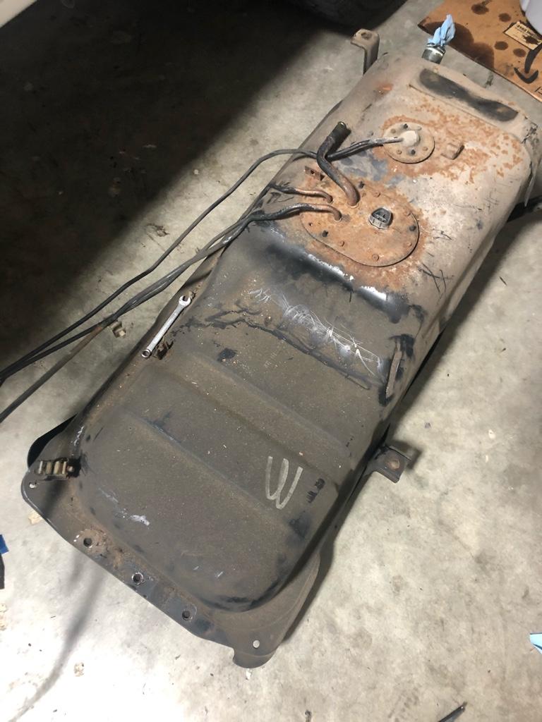

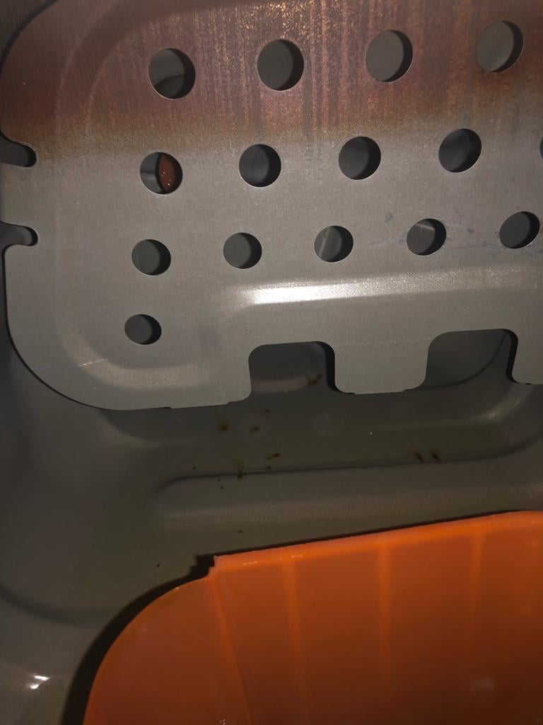

The tank strap was rusted through and the tank had pinhole rust from whoever supported the tank on the shield with an old mechanics coverall, but hey, someone left a free Walmart 8mm wrench! Small miracles.

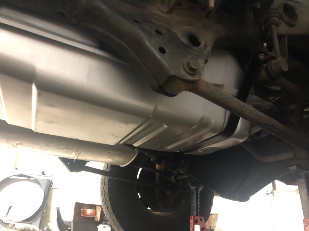

New tank and strap. Also replaced fuel filter.

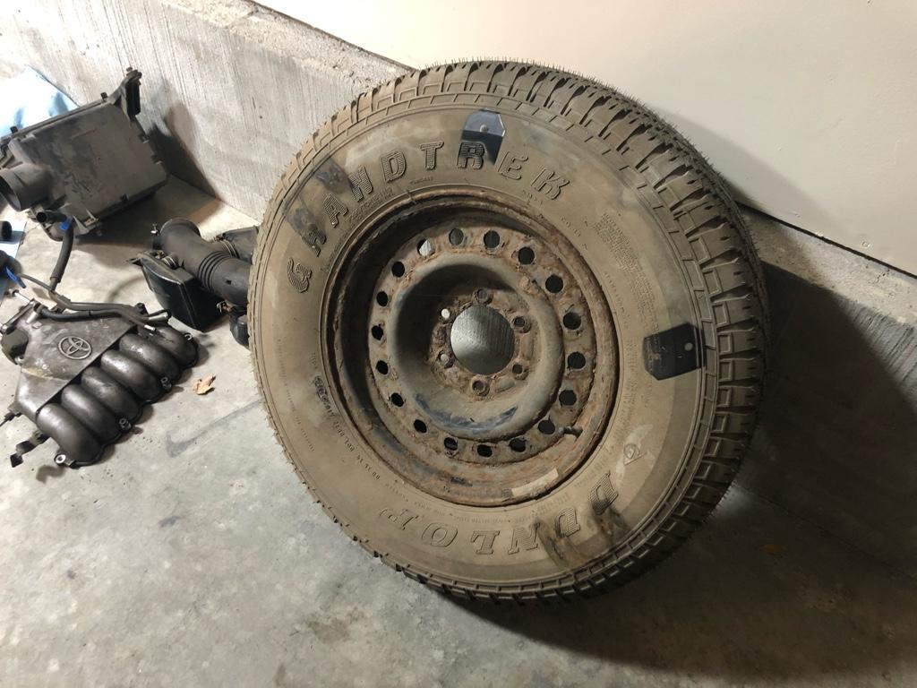

Spare tire date coded 1997. Nice.

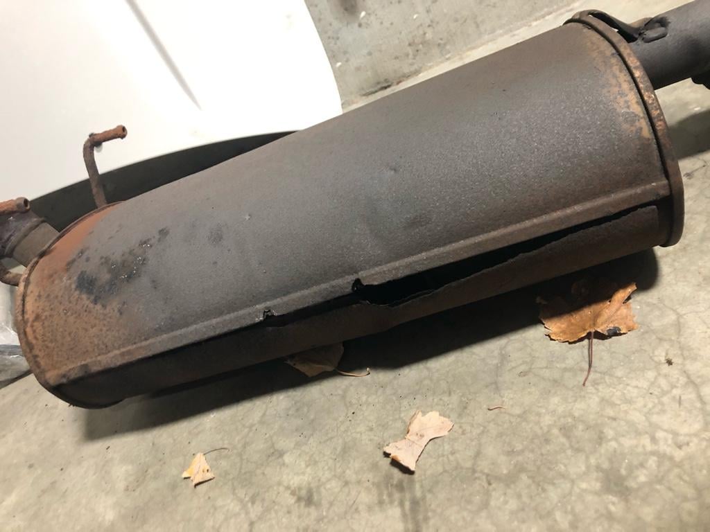

Out with the old muffler and tailpipe. Don’t have pics of the new one. Used walker parts though.

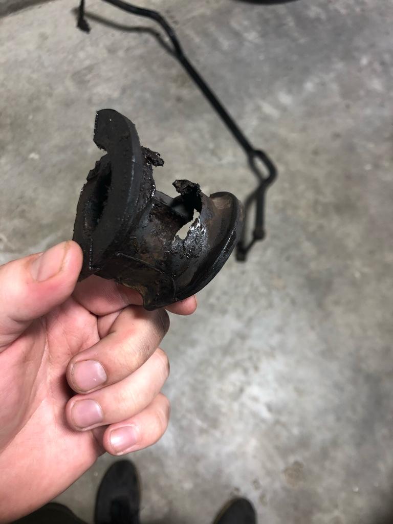

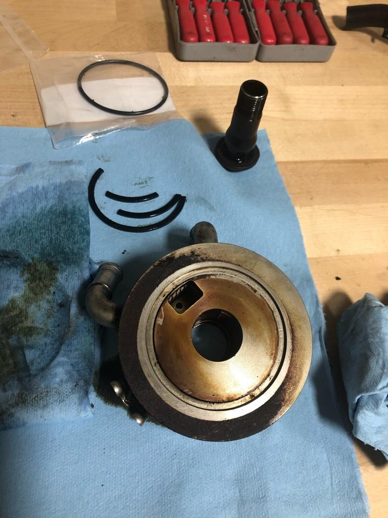

Replaced oil cooler hoses and seals, figured why not while I was in there. The oring was so brittle it broke apart and the hoses were swollen from the valve cover leak.

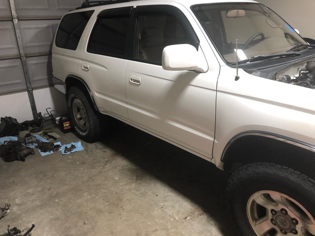

Here’s how it sat about 3 weeks into all this. Shifting great, no more smoke, but still putting down some oil from the bell housing.
It was looking better at this point but still needed more work. Installed new AC Delco rear springs to fix the sag. Rear is now 1/2” higher than the front. Much better!

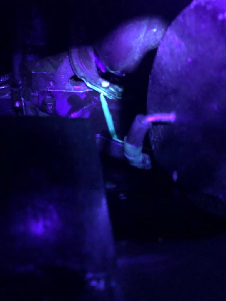

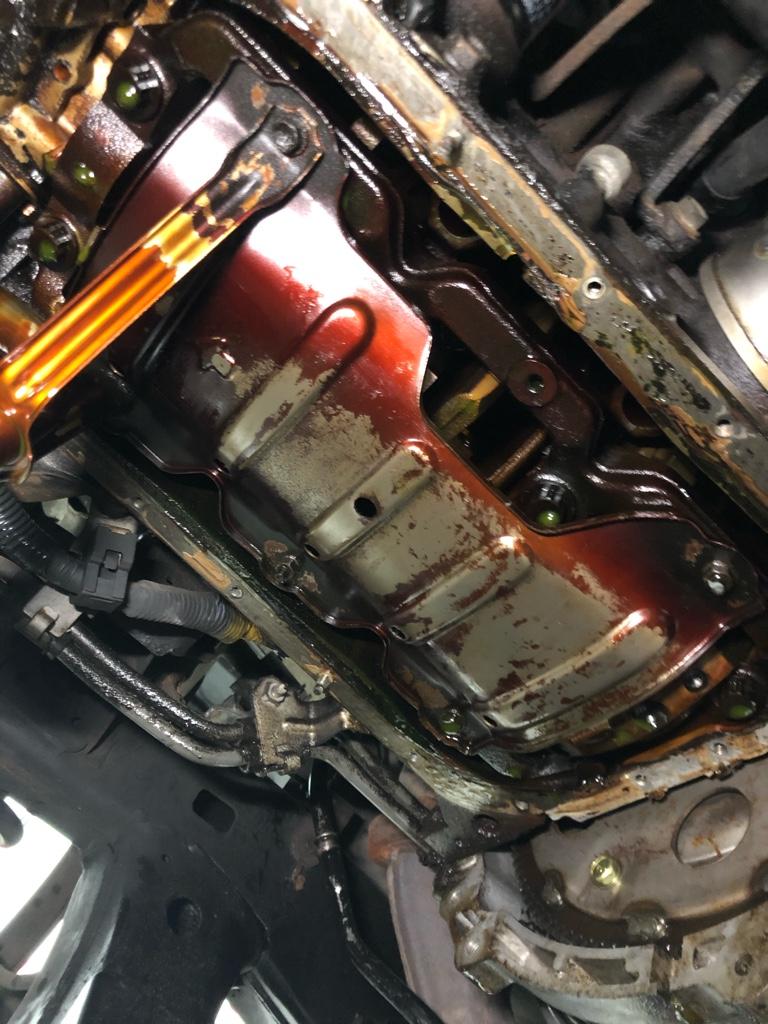

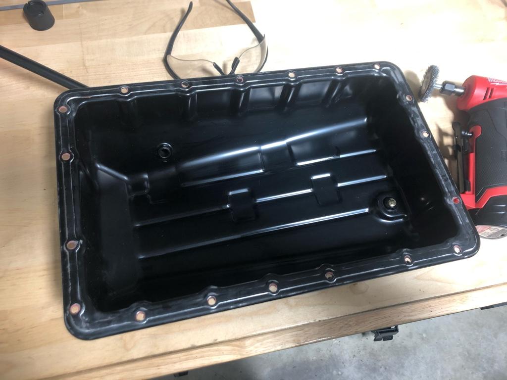

Still leaking a little oil. Maybe 10 drops overnight. Used dye to trace it down to what I thought was the oil pan.

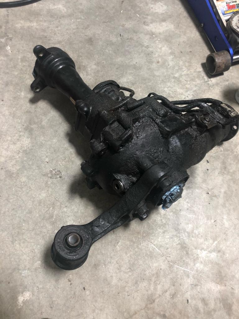

Out comes the diff to reseal the oil pan. It was a pain to remove alone but eventually it came out. Used leftover Toyota fipg from the valve cover job to seal it back up. Also replaced the passenger side CV that had a torn boot with a new Cardone one. Will rebuild the old OEM one for a spare at some point.
Removed the oil pickup to inspect and clean, looked fine though.
Cleaned everything up and put it back together. Also installed new steering rack bushings. This was cake with the diff out of the way. New OEM lower ball joints too. Still leaking oil from the same spot, but noticeably less now. Guessing it’s the RMS.

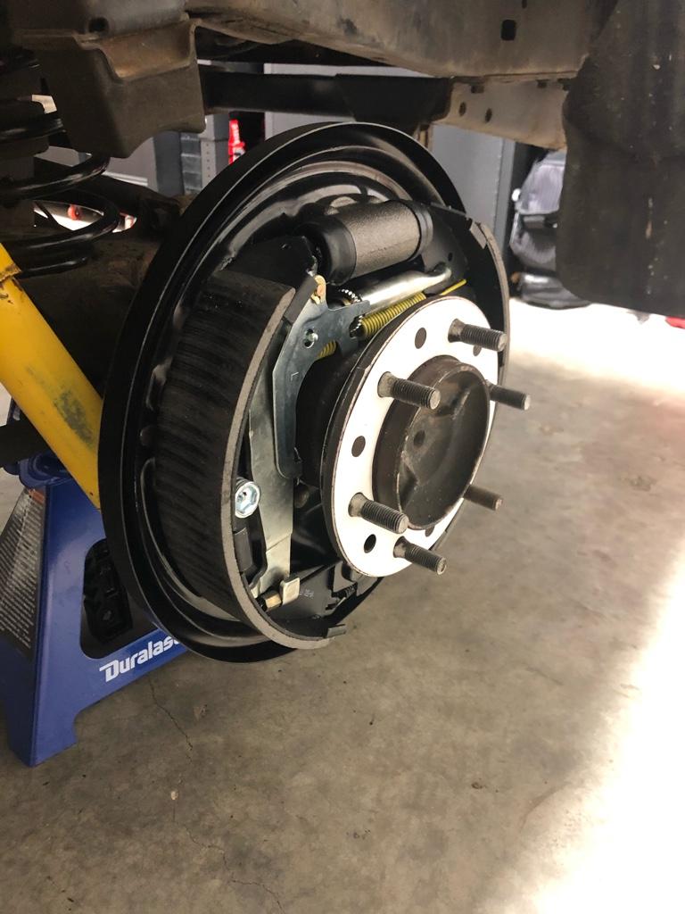

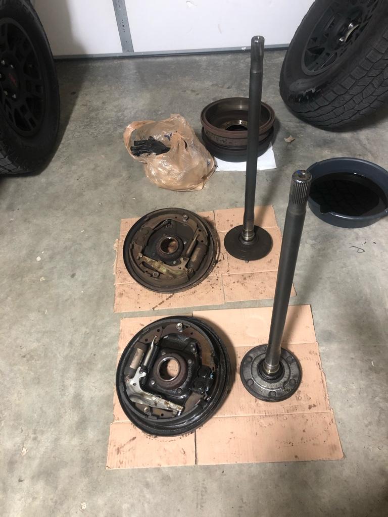

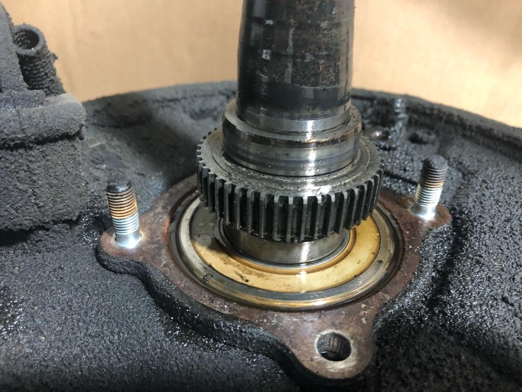

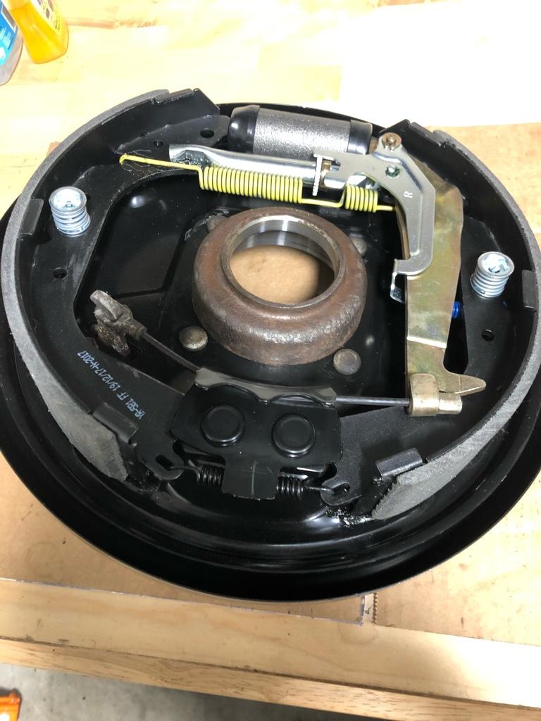

Onto the axle seals. One side was a mess and other was just weeping through the wheel stud holes. I held out on new tires until this was done because I didn’t want to get gear oil all over the new tires. Replaced the bearings, shoes, drums and hardware as well.

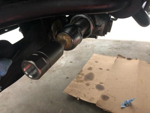

A $75 eBay puller tool made axle disassembly pretty simple. I was able to reuse the retainers and abs rings. Huge money saver there, even after buying the tool, and I have absolutely no idea why the FSM says to grind those off. There are tons of SST’s out there that are more complex than that puller.

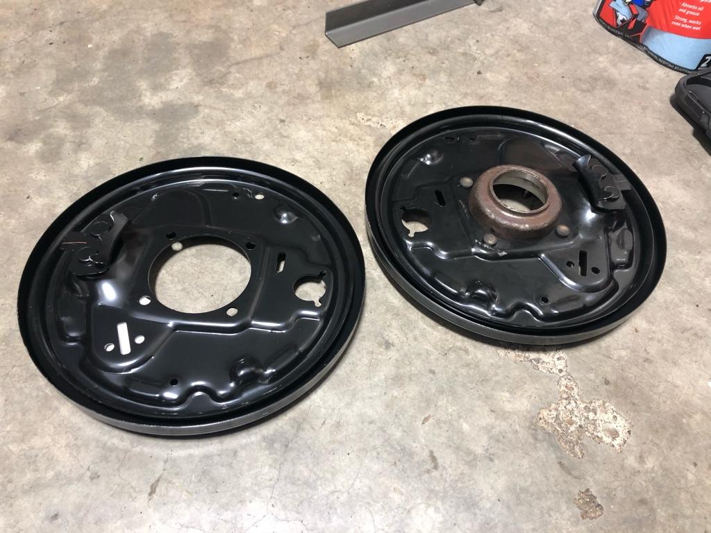

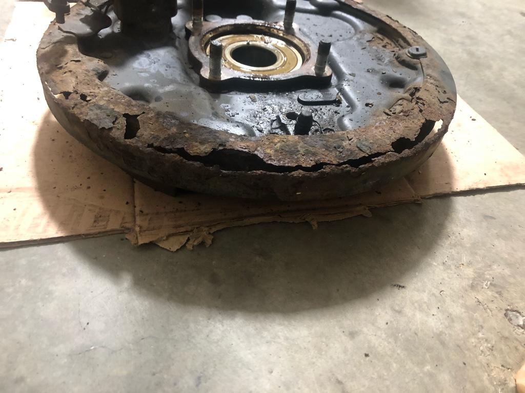

Backing plates were toast though. One was rusted pretty good, and the other was so covered in crap, I was happy to not have to bother cleaning it up.
Got new OEM ones, which hurt, but whatever I’ll never have to do it again.
I followed a few people’s guides and flipped the retainer that the axle seal rides on and measured to make sure the revised seal rode in the correct spot. 3mm of polished axle was dead center for me.

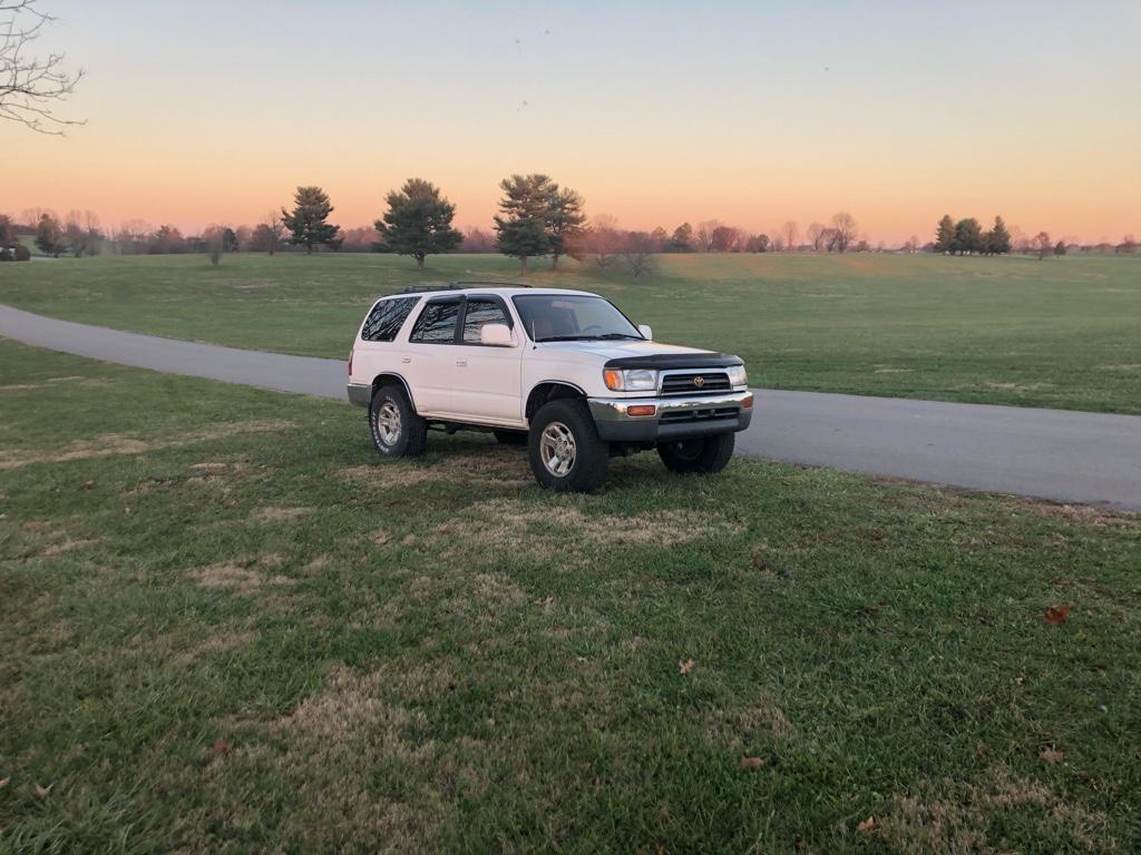

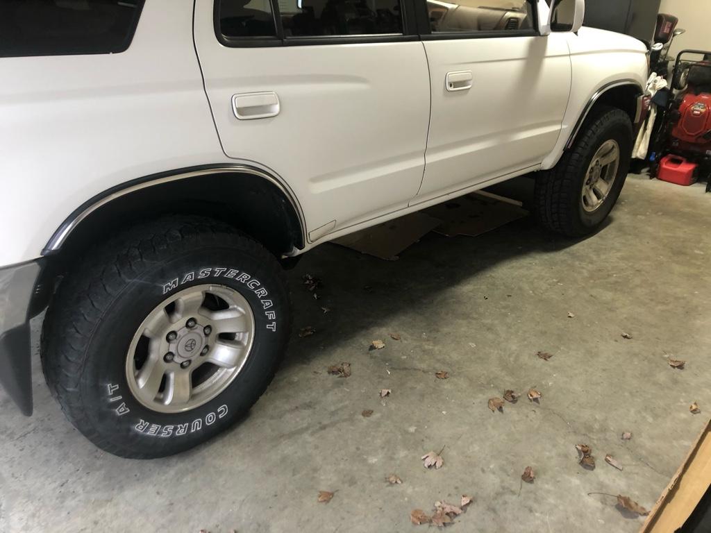

Found a local deal on TRD wheels with the tires I was already going to buy! Jumped on that one and here’s how it looks today. I’ve done a few other minor things like resolder the clock, hvac leds,and extend the rear diff breather, but this mostly covers it.

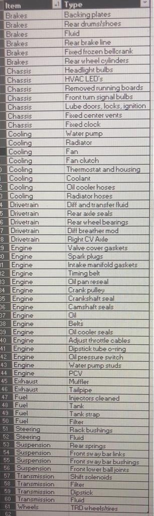

Here’s the tracking sheet of everything done to date. Should be good for awhile now. Some stuff would have been fine to address at a later date or leave alone, but the idea of being at the mercy of a random shop at some point in the upcoming cross country trip was too unsettling.

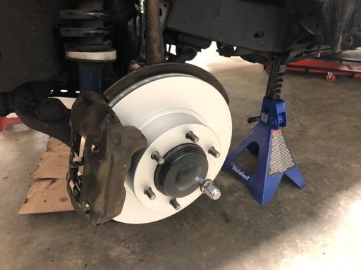

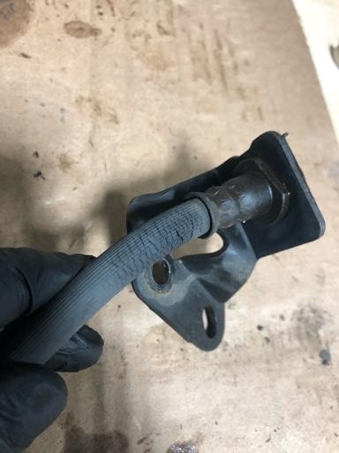

Did some work over the weekend refreshing the front brakes. Replaced the inner/outer tie rods, brake hoses, rotors, pads, hardware, and installed speed bleeders.
Inspect your brake hoses! These had 270k on them. I did the rear one at the same time as the rear refresh.
All done. Speed bleeders are pretty sweet, highly recommend them. I couldn’t get my power bleeder to seal on the master reservoir, and I found these to be just as easy.
