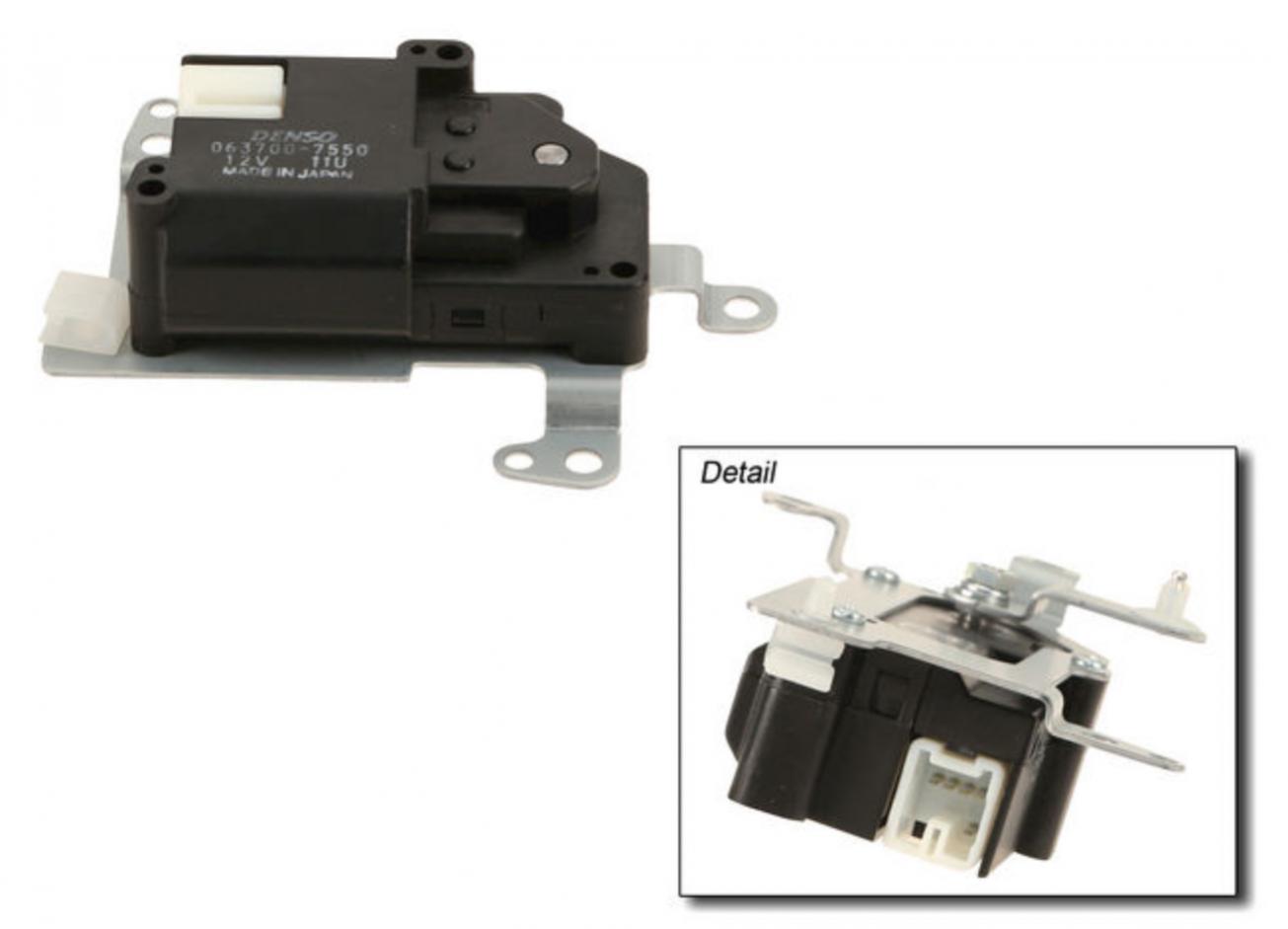

Is this the correct part?
syxm2bk-toyota-4runner-air-flap-actuator.html
Thanks. I've been doing some additional reading and I think that's the case with mine. It's been making a weird clicking for quite a while now. Just need to find a replacement part. The actual replacement doesn't look too terribly difficult. Will update once I replace it. Thanks.
