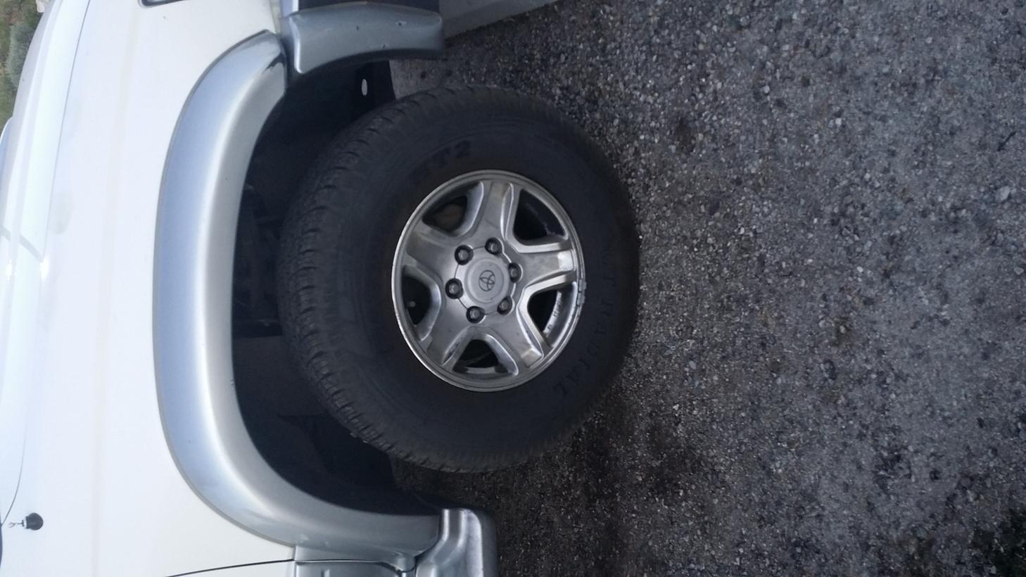

rims
Can I do the 231mm calipers with these 16"rims?
