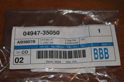

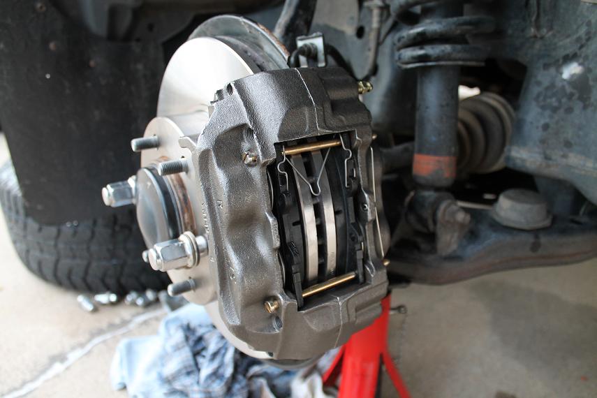

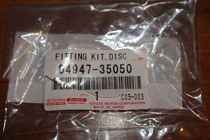

I don't remember getting shims with mine, however I did try to use the old spring clips (W clips) which broke and resulted in an annoying rattle from the pads. I would recommend getting the fit kit from the dealer (about $4.27). It's the "W" shaped wire bridging the pads in the assembly.

P.S. it's better to have two retaining springs on each caliper rather than one. Per Toyota's installation manual for the pads.
I tried with just one but it applied uneven pressure on the pads for me and the opposite side was popping off. Just a head-up.
