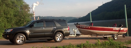

My boat weighs right around 2000lbs with everything and I can def feel it on the back but it pulls very well. I wouldn't want to pull anything more than 3000lbs for peace of mind

Hey, JD: I was wondering what type of boat you were pulling, so I put "Lund Alaskan 18V Tiller" into google images and this was image #4 that came up:
images
images

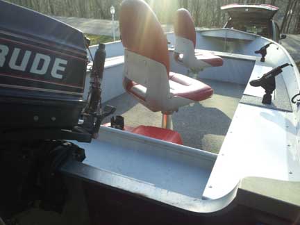

lol that's the catalog picture, here's the actual boat...
