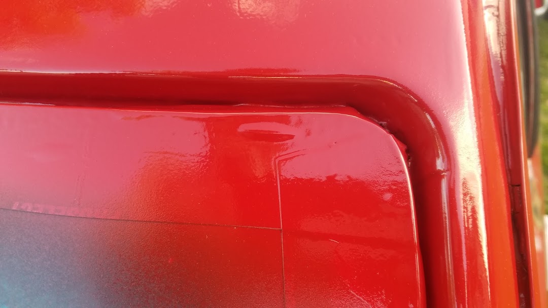

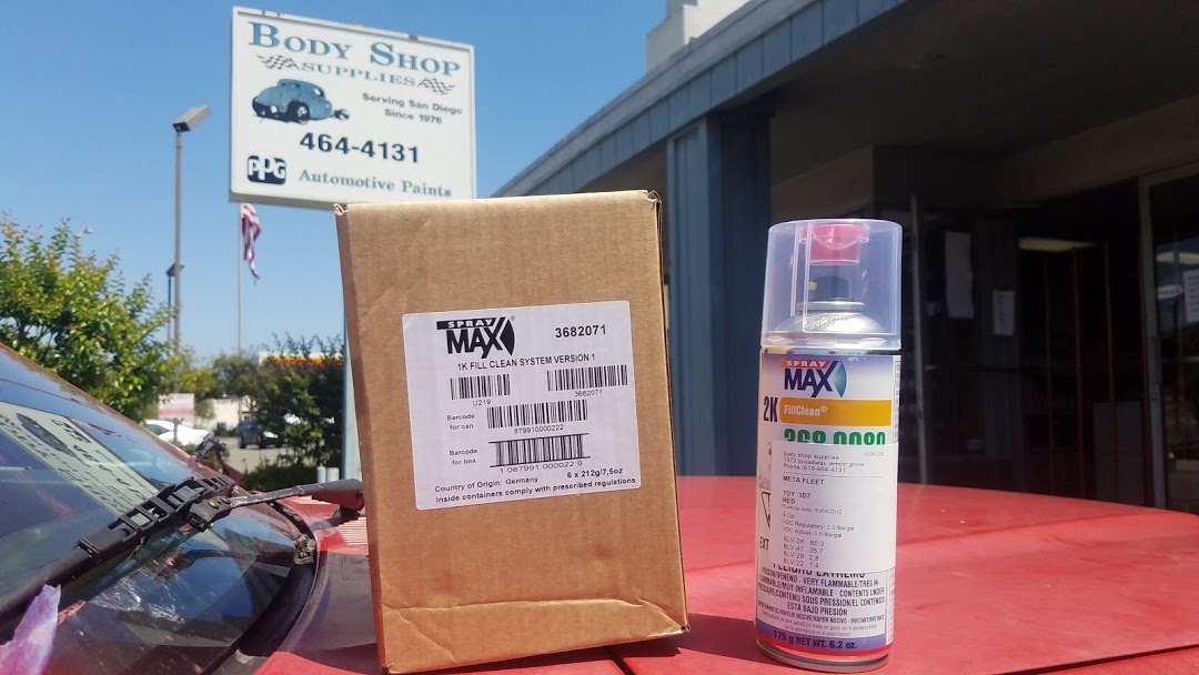

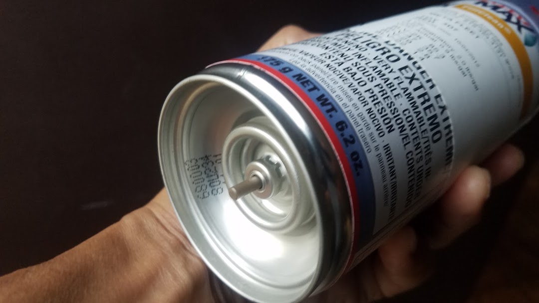

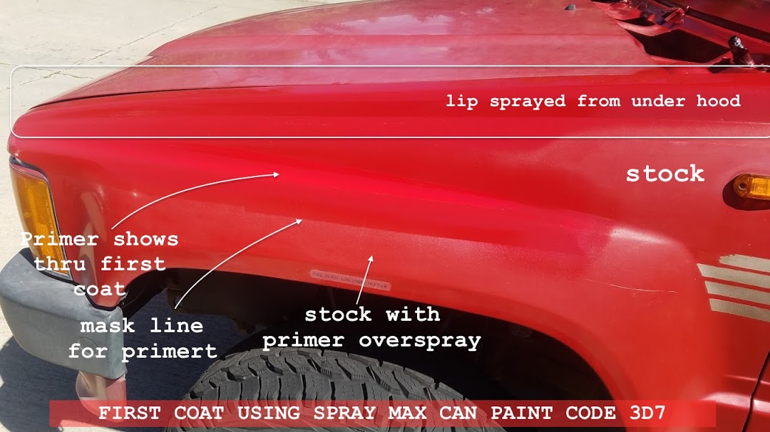

Forget Toyota for Paint codes. I went to local body supplies store. They would mix your paint code and package it in Spraymax spray can (Products - SprayMax). Our first-gen MoreFunners do not use a clear topcoat that you see peeling off on 3rd-gents and later. I picked the one-stage one. There is a button you press on bottom, shake and spray. Very nice pattern. It has hardener so you need to use the can within 48-hours once activated. Approx $30 per spray can, but quality and ease of use is well worth it. I do not have a paint booth. I'd find wide open parking where there are no leaves falling and did it quickly :)
My main cab and touching up the fenders took 3 cans.
My fiberglas cap took another 3 cans.
The shop would also out excess blended paint in pint can without hardener so you can brush on.
