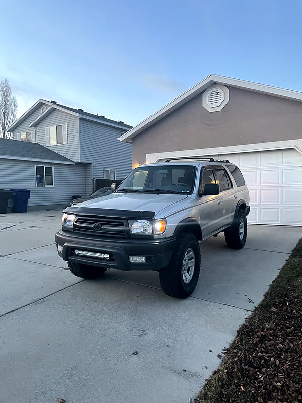

Yes! Another build thread cause there aren't enough... :rockon:
Long time lurker mainly in the 6th Gen forums. Really wanted to get either a 6th gen 2020 or 2021 TRD Pro or Audi SQ5. I decided I really didn't want to spend $60k+ on a new car when driving daily isn't a thing right now.
But another toy to build on, that's another story!!
Randomly came across this '99 SR5 3.4 V6 with 224k for $4k in excellent condition on my IG account someone local listed it there before anywhere and I just happened to be the first person to reach out to him. (2nd owner)
I needed something for camping, fly fishing, MTB, Winter sports...
I'm not new to building cars, been doing that for about 20+ years, but very new to building trucks, and especially a 3rd Gen T4R! I'm super excited to learn something new about a proven platform if cared for.
Some pics from before picking it up:

**Notice the difference in how clean the hatch jam is compared to above...
First things first!! Sub Added
<a data-flickr-embed="true" href="https://www.flickr.com/photos/186301944@N08/50654252573/" title="IMG_0284"><img src="https://live.staticflickr.com/65535/50654252573_c849e894be_b.jpg" width="1024" height="768" alt="IMG_0284"></a><script async src="//embedr.flickr.com/assets/client-code.js" charset="utf-8"></script>
Plasti Dip Removed & AVS Bug/Rock Guard installed.
https://flic.kr/p/2kce6zc
UPDATED: 4/4/21
Already done to the truck (Pepe) from Romancing the Stone! haha
- Blacked out HID Headlight and Corners
- LED's inside and outer
- Steering wheel and grab handles wrapped with paracord
- Kenwood Bluetooth head unit (wires ran for a sub)
- Plasti Dip badges, chrome bumpers, grill, mirrors
- Custom Exhaust
- 285/75/16 Wrangler Duratrac (traded)
Done so far!
- Rockford Fosgate 12" sub (cleaned up wiring, ran new sub controller wire)
- My OCD interior Detail and Engine Bay
- Power washed the under carriage
- Removed plasti dip from hood and rockers
- Paint touch up to the hitch (needs to be sanded down then recoated)
- SCS Ray10 17" ET-38 w/ Falken Wildpeaks AT3W 285/70/17
- AVS rock chip guard
- Depo Smoked LED Tail Lights
- Matterhorn MKII Roof Rack
- Toytec Ultimate 3" lift w/ SPC UCA's
Not Installed yet:
- 4xinnovations Rock Sliders
- Satoshi Grill
- BXBuilt Retrofit Switchback Halos w/ smoke corners
- Eim Keith PCK
- Rear hatch shocks
On the List: For now...
- Rack LED bar
- TBU (unsure if I am going to do this)
- Still deciding on a rear bumper
- Savage skid plate front engine and Diff kit (Ugh Savage Closed)
- Sand and re-protect undercarriage
