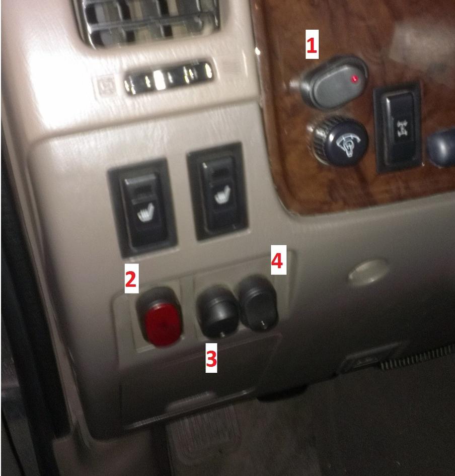

Switch #3 controls an extra set of fog lamps up front and has a blue LED on the switch. Switches 1/2/4 I have no clue, but they all are still hooked to power as their LED's turn on when toggled.
Suppose I need to trace them, but if one is to disable/enable the TRAC/VSC do you have any guess as to how I can verify that without running the wires?

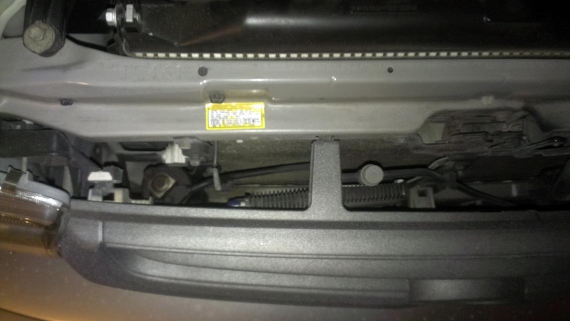

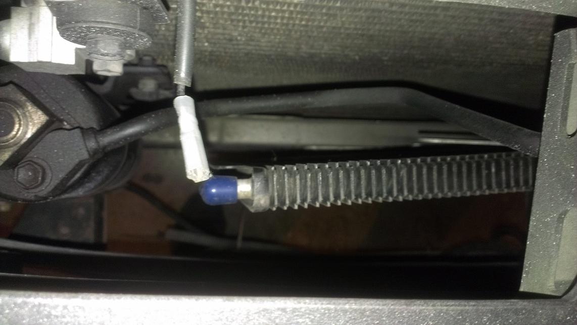

Also, what's this additional cooler in front of the AC + Radiator. There doesn't appear to be anything connected to it.

If I were you I would try a d get in touch with the previous owner. They would probably be the most knowledgeable.
Previous owner bought it at auction, so has no clue. The original owner had it from 2002 until 2013 when he traded it in. The guy I bought it from knew very little about 4runners and cars in general (you should have seen him freak out when I was checking the spark plugs).
Your guess is as good as mine on the switches. None of those you mention look factory. As for the cooler, it looks like a transmission cooler was put in to avoid the "pink milkshake" issue. Does the cooler have two hoses connected to it that you can follow? Maybe someone else can chime in and correct me?
Edit: Looking at the picture again, it looks like it is not hooked up to anything.
All of the switches you asked about are aftermarket. The only way to know what they do is to trace the wires.
Traced what I could of the wires, they kinda go into a rats nest right next to the firewall so it's hard to say. Gonna need a friend's help and a volt detector most likely (one flips while the other tests). Also, for some reason the stock fog projector wires are cut right next to the mounts. Not sure why he would have done that, maybe there wasn't enough voltage on the line he was stealing? No clue. That's honestly probably going to be the biggest issue with this rig, is fixing all the wiring and getting the lights working properly.
As far as the cooler goes, it looks like he had intended to bypass the stock radiator-mounted transmission cooler, but never finished it. I would say get some braces, nuts, and bolts, and mount that thing flush against the a/c condensor. Then get some transmission hose and bypass the stock cooler.
As far as the switches go... who knows, lol.
Don't know 100% but a friend had all of these crazy LED lights in and underneath his Monte Carlo and those switches looks a lot like the switches that was on his dash.
Maybe the owner took the LEDS but left the switches so the dash wouldn't look hacked up.
I bet the one by the center diff lock allows you to use the center diff lock in 4hi or 4lo.
The other ones are probably aux lights, or maybe a locker ? I think you'd know if you had an aftermarket locker or not though, as you'd see the ARB compressor.
If you are wondering if one is a vsc/trac off switch, you would know almost right away when flipping the switch. There are lights on your dash that will light up and inform you that it is turned off. If you don't see these than the switch is most likely not for vsc/trac off.

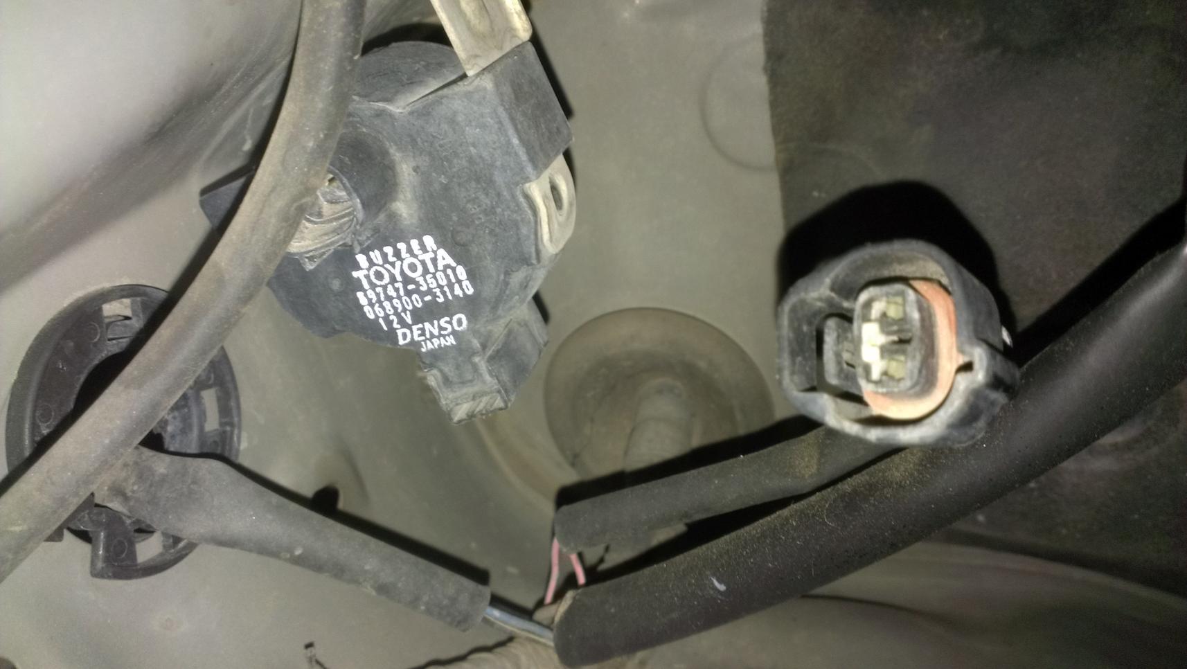

I found this disconnected right behind the VSC control unit (back left corner of the engine bay).
What's this for and why would it be disconnected?
It's the wireless buzzer which makes a noise when a button is pressed on the key fob.
Why is it disconnected?, who knows why people do some of the things they do.

Is that an electrical wire going into that external cooler?
