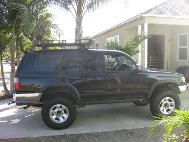

Wanting to upgrade to some 2.5 coilovers and rears with ext res. Not much out there for 3rd gens { 2000 } talked to radflow, was a bit pricey for the coilovers, king will make me what ever i want but has a 4 to 6 week lead time.
My runner is more for going threw the desert and baja, at the same time i will swap out the uca's for something like total chaos, and do some reinforcements.
So please chime in for some advice on where to look. Right now i have sonoran steel 1.2, What valve profile will work with the lc coils ? or should i swap those out as well. For the coils, i was thinking a 600 lb spring. Front only has a light/crash bar, o real extra weight, i and i do not plan on adding anything.
