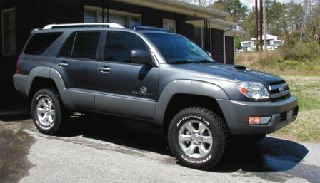

Dont worry too much about the 2.5" lift being to high. I love the way my T4R rides and XREAS is still in tact. The leveling kit will actually make the truck unlevel. If you look at the running boards you can see the stock ride is level, the cladding is why it looks unlevel. Just an F Y I for you

It's a great budget lift that makes your truck look like it should have. You can put it on with your present suspension components and it will work just fine. Most who have it, did some sort of other upgrade(s) at the same time. The most common is new (upgraded) shocks. Some did shocks and new springs (FJcruiser take-offs being common and the least expensive).
here's how it looks:
