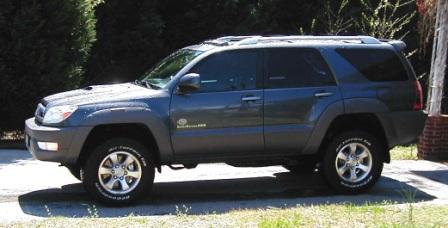

Just Installed Daystars lift kit on my 03 T4R Sport V8 and everything is great. The ride is still just as smooth as B4. The kit was only $239. It feels like i'm 2 feet in the air compared to stock. The XREAS system is still operable and I have NO dash lights going crazy. The only problem was, they said the Daystar instructions said nothing about clearence getting strut out to install spacers. After tedious search, I found removing the upper A-arm to be the solution. I called the shop and they took care of it. OTD price was just over 5 bills.

If I understand correctly the 2.5" daystar kit has everything, that is not only spacers but also bumpstops and so forth. Did you install those components as well?

Yes, bump stops were there. Everything you need is in the kit (except a little installation dude to pop out and put it on for you)!
