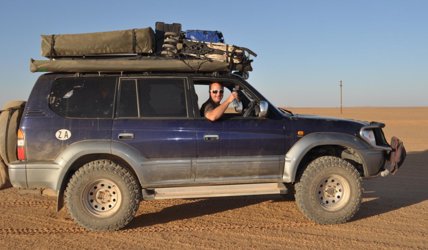

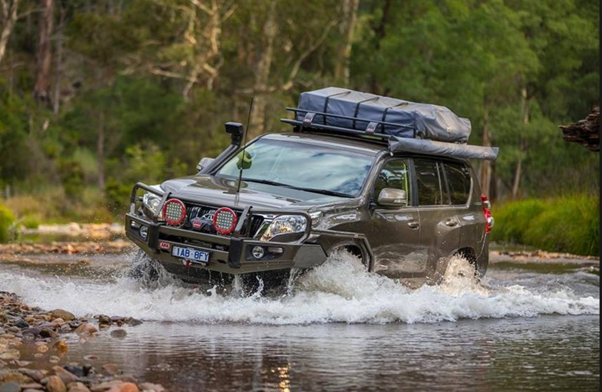

Sell the 4R and import a Land Cruiser Prado with diesel
