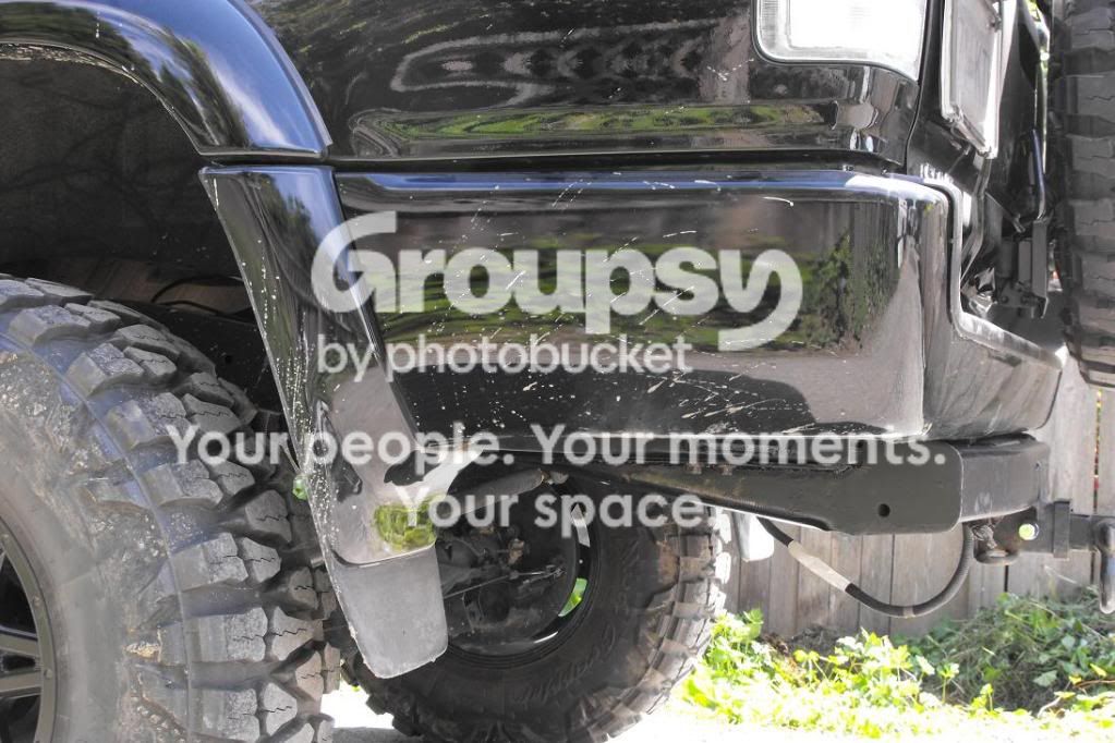

Do you have a tow hitch on the back of your Runner? If so, can you post a pic of the back? One of the main things that keeps me away from the 2" bl is the gap between the hitch & rear bumper. I know a custom rear bumper would fix it, but I'm not exactly looking to go that far just yet.

This is modified with the 1.5" BL on and it's pretty much up against the bumper. A 2" BLcan be done the same way. This also still retains the original bolt points. I've used this hitch multiple times to recover and yank friends and they've held out well...
I will eventually weld on gusset plates to reinforce it further....just to give you an idea.
