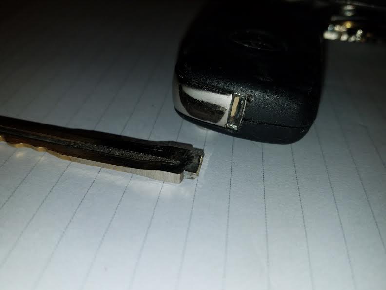

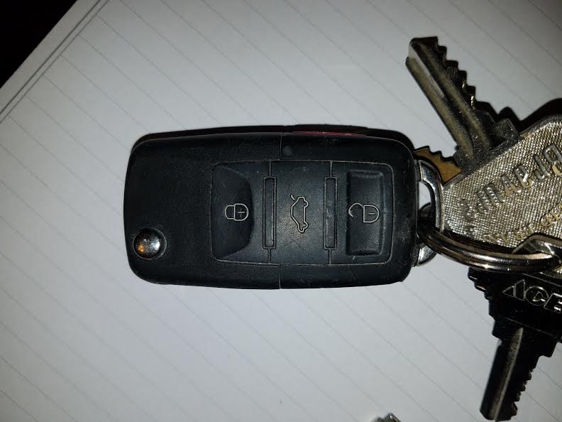

Update
So..... 8 months later and here we are. Snapped while turning the Runner OFF this morning. Thankfully there was enough of the key sticking out of the ignition to pull out easily.
