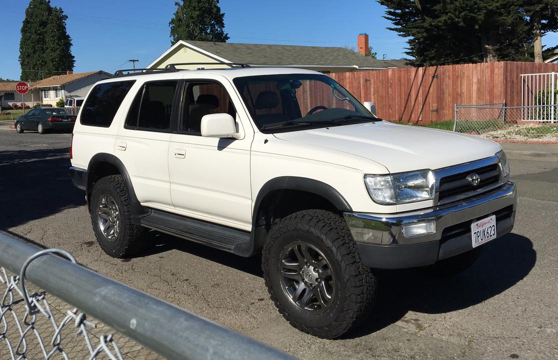

I had the tundra coils and 906 set up as well. It's a good ride, I had it on my daily driver. The mpg didn't go down too much, maybe a gallon at most. It's a great set up. I'd also recommend to buy them from wheelers off-road. They set the right bushings on the 5100 for the 4Runner. If you buy 5100 anywhere else you'll have to buy the bushing separate and it's a pain to try to find them anywhere.
Also if you go this route, don't forget to buy your coil idolaters. And if you have the driver side lean get a 10mm packer to even it out, but since it's a new suspension you probably won't need the packer.
Here's what mine looked like before I sold her
