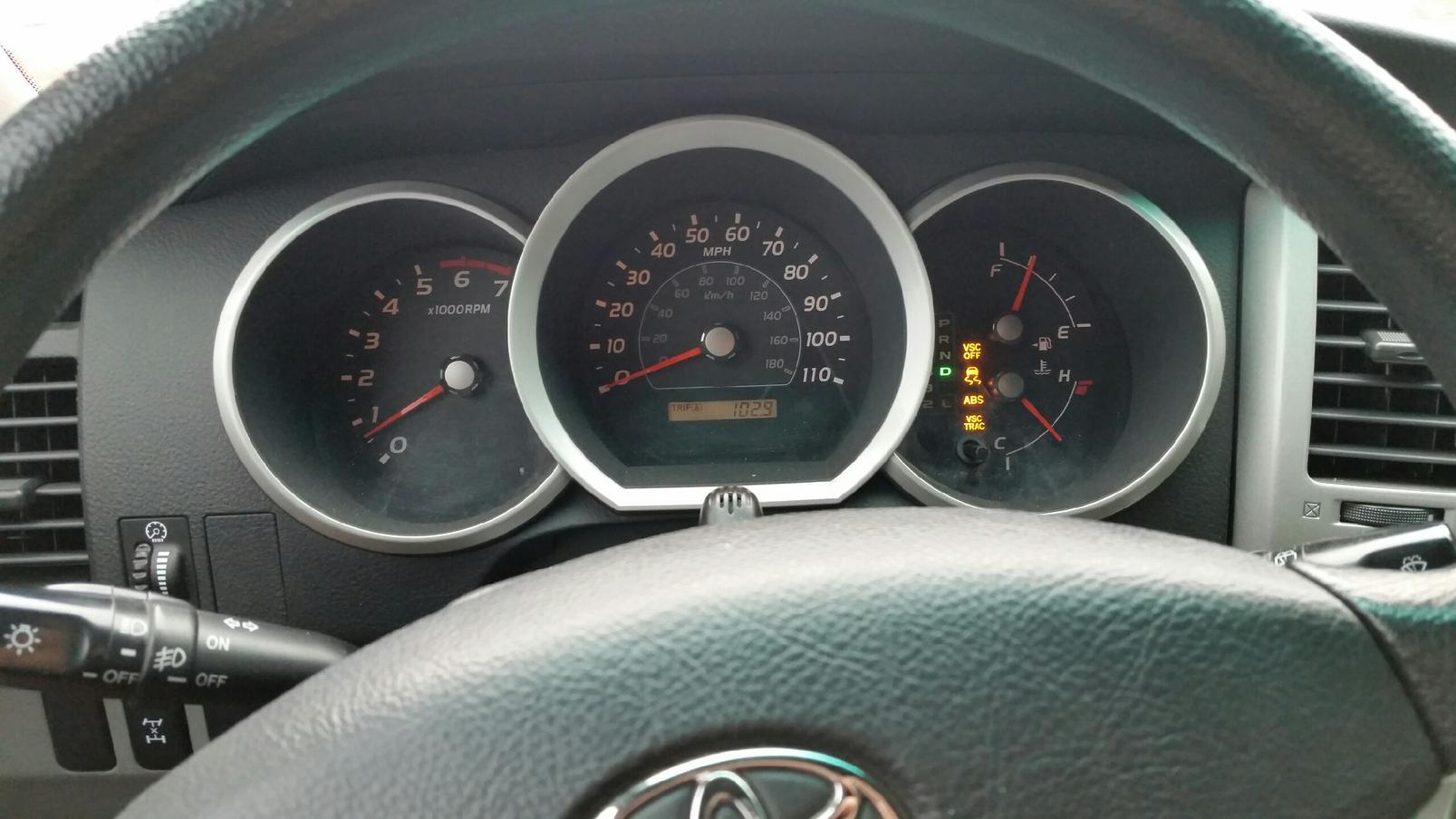

Issues #2: VSC OFF, Slip indication, ABS, and VSC TRAC lights on when starting car, can’t shift out of Park
Randomly and intermittently, when I start my 4Runner the above lights stay on after starting the vehicle. NOTE: Check engine light does NOT remain on. This also makes it so I can’t shift the car out of Park. Sometimes this will clear if I turn the car off, and back on again.. sometimes I will let me shift out of park, with a little extra push. I haven’t found any reliable series of events that causes this.

I haven't had a chance to check the ABS or cruise wiring... but the issue has morphed a little. No longer does the chistmas tree of lights remain on after starting... It now will randomly come on while driving down the road (or at a stop light). It doesn't seem to affect driving or anything at this point, and i haven't figured out a normal time frame/speed/accel for this to happen....
Any more thoughts?
