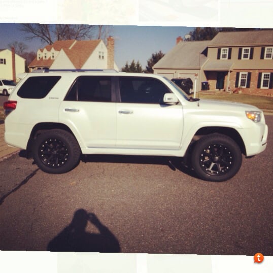

Here's mine with a leveling kit on the front. 20x9 -12 XD addicts with 275/55 nitto terra grapplers. I love the new setup!!
