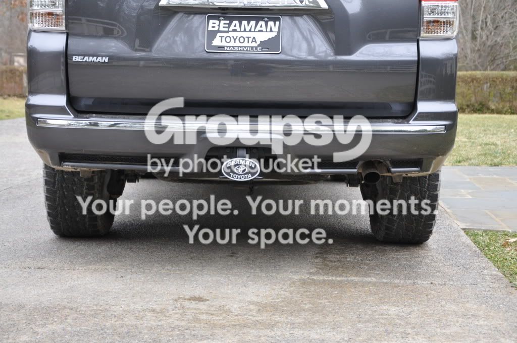

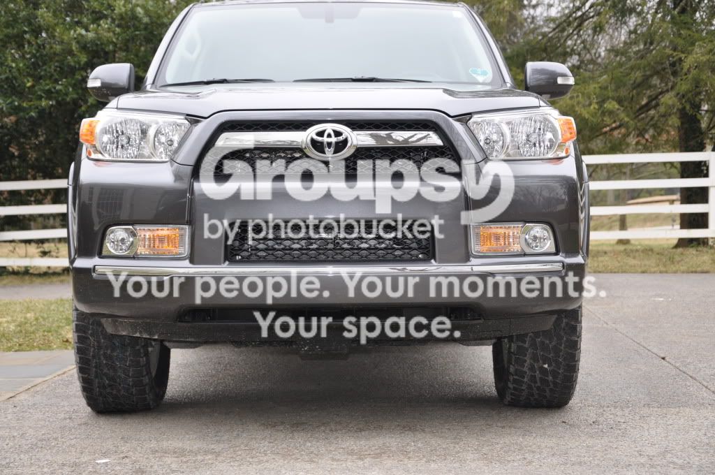

Just installed some Nitto's in 275/55/20 on my limited 20's and they look great! No rubbing!

Awesome looking tires!! Do you have any front or rear shots? Just curious if they still look super skinny from the rear with these wider tires. How much did you end up paying for them? I've been seeing prices as low as $195
much better look! thanks for posting pics. time to tire shop!

wow looks good. While you managed the unthinkable, which tire store let you put 275 tires on 7 inch wide rims when the MIN rim width for a tire this large is 7.5 inches? I hope you understand the tires arent as well supported on this skinny rim and there may be risk of blowout. Others here can feel free to comment. this is part of reason why many limited owners cant stand the current rims, not to mention very limited tires for this size. Good job toyota!
