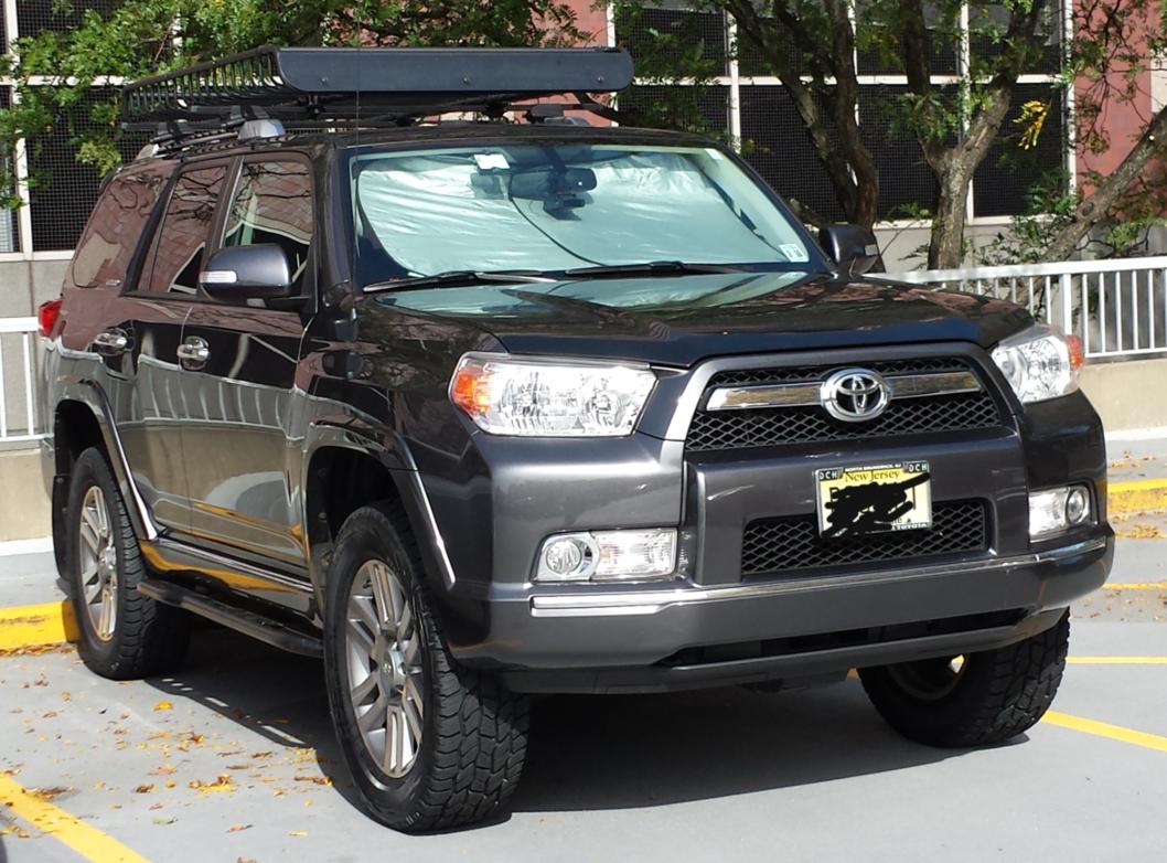

Installed Cooper Discovery AT/3 275/60R20 on my Limited rims. Also installed the 2.5" Daystar 9134 kit as well. My garage didn't do an alignment but am having a bad vibration over 55MPH. Any recomendations besides get an alignment? PSI is set at 40.
A good road force balance.

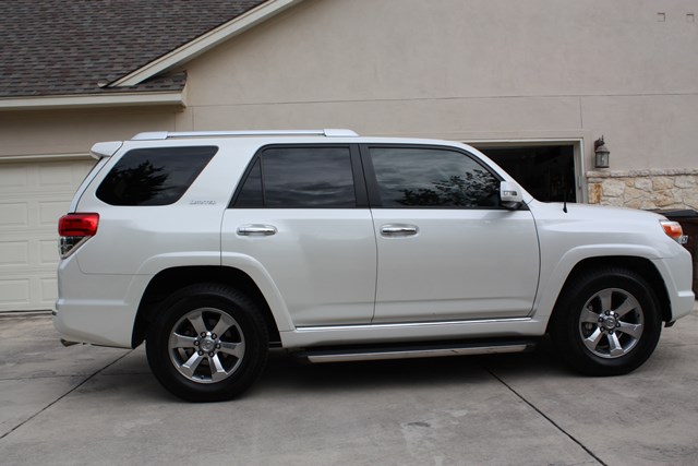

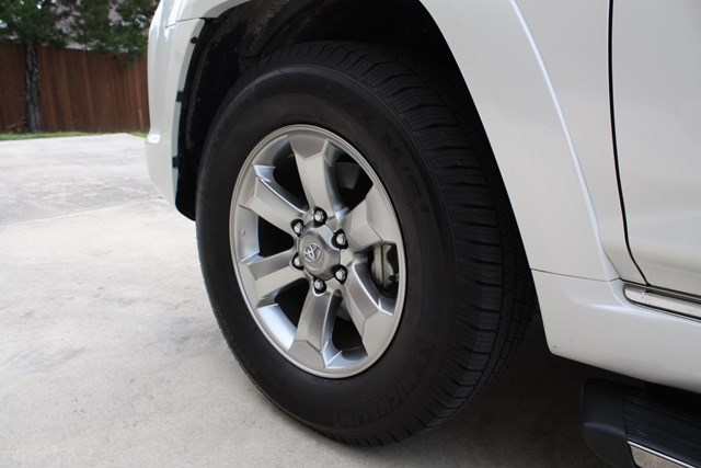

I went through the same thing a few months ago. While I'm sure the 275/55/20 tire would be okay from a safety standpoint, I was not comfortable with the possibility of premature or irregular tread wear. In addition, Discount Tire (A) would not install them and (B) would not warranty them. This made my decision that much easier.
I opted to dump the wagon wheel skinny 20's and picked up the Gen 4 Limited wheels. Brand spanking new for about $160 per wheel. Added some Micheline's and I couldn't be happier!

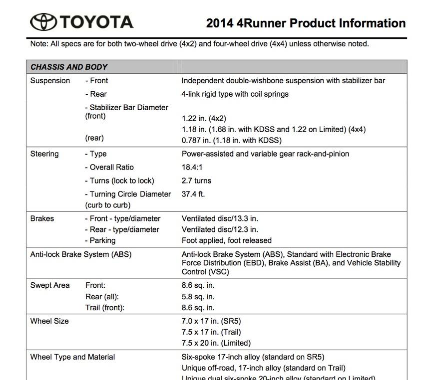

Don't know if it's a typo or not (may have been pointed out by someone else already), but the official product info from Toyota for the 2014 Limited with 20 inch rims says 7.5-inch rim. Sorry to cloud the issue, but it's what they sent out.
