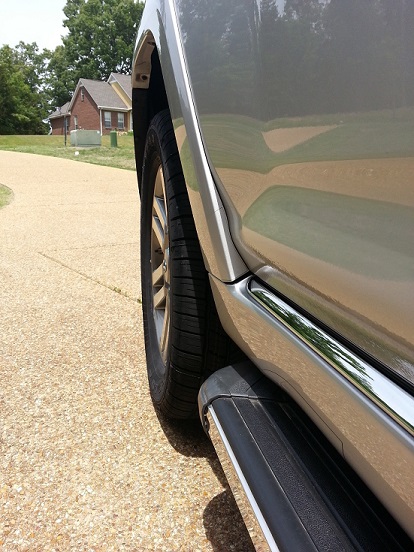

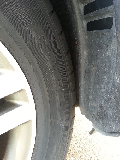

so after 60k on the yoko geos
i went and got the GY LS2
kudos to Rigtec and to those who contributed on this post.

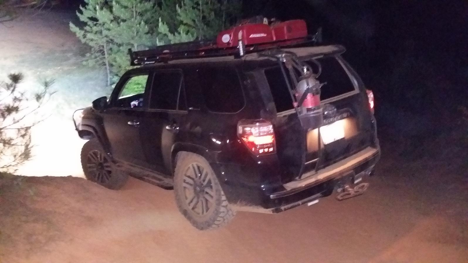

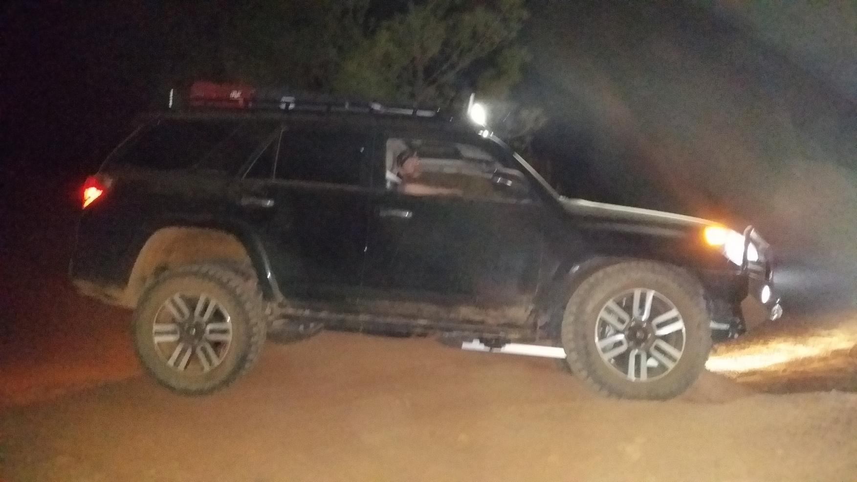

You should be fine. That's the size many websites recommend when going with aftermarket wheels. I have -12 offset so it rubs a little only in reverse and wheel turned to the right. Not a big deal if you have to make some small modifications to wheel well. There's a thread on that
