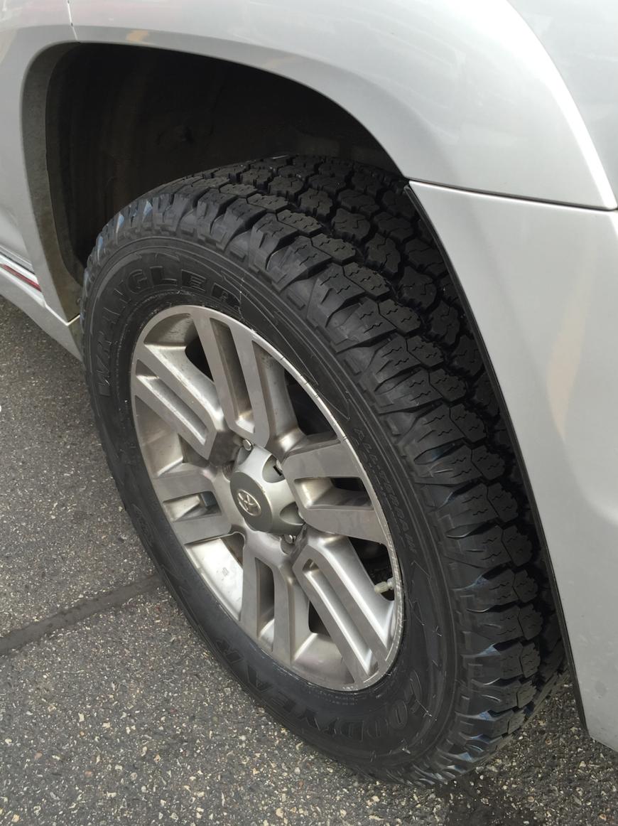

Just put Goodyear Wrangler AT Adv Kevlar 265/60/20 on my '13 Limited. Went with the pro-grade (load range E) b/c it's severe snow rated (snowflake on the tire). Looks 100% better than the OEM bike tires. 1000 miles so far. Little louder, little stiffer. Can't wait for the snow to come. Expecting our first 6" to 12" in MN tomorrow.
--- Pic attached
